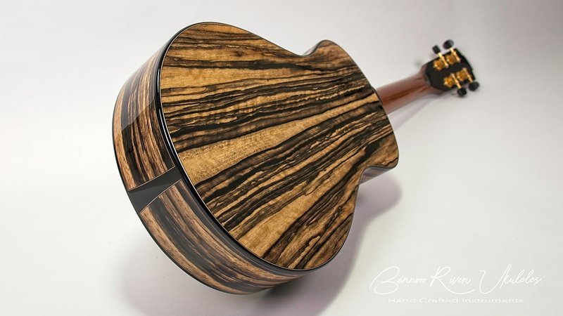

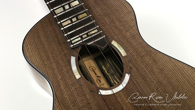

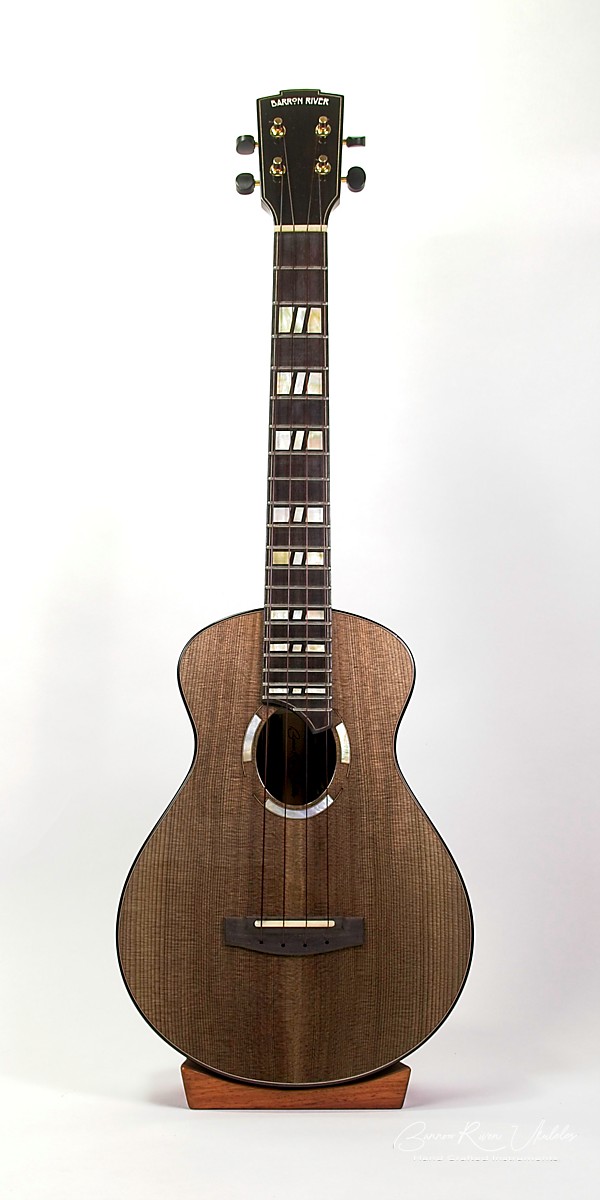

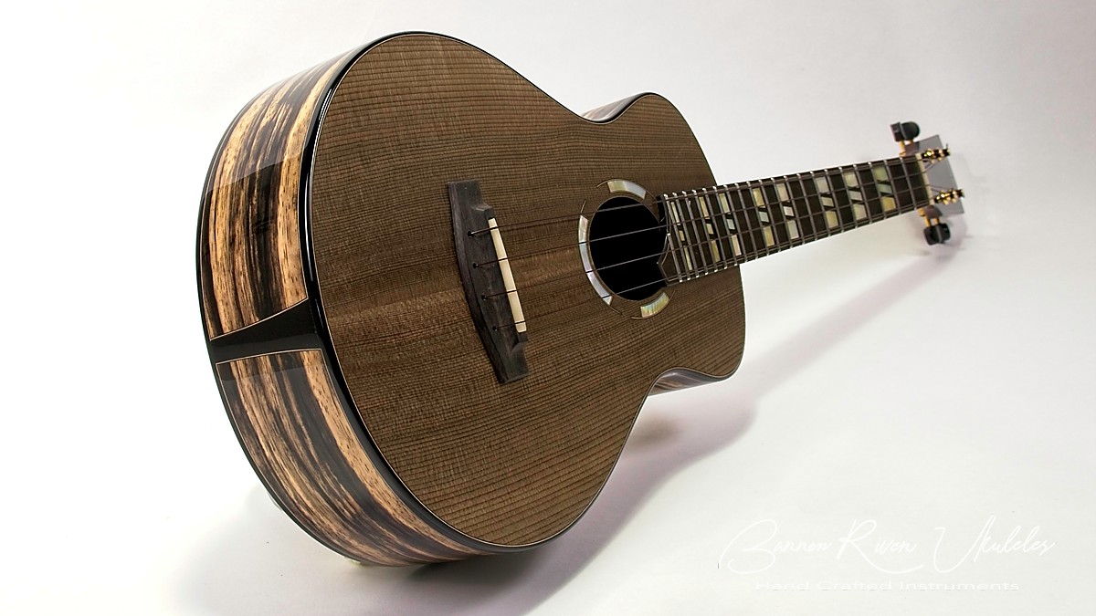

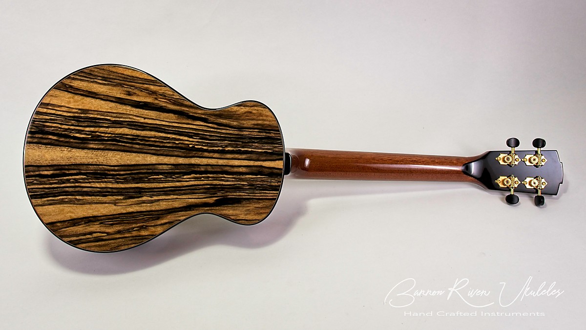

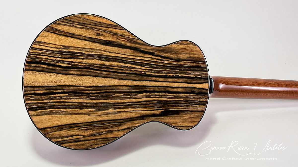

Just finished another lot of instruments. This one of two for a client that has commisioned instruments in low G and high G versions. It's a 18.5" scale to accomodate the 14 fret to body.
First time using Mun Ebony and was pleasantly surprised at it's workability and how it finishes. Sound board is the last of the 3000 year old Sitka Spruce that I have and sad to say that there is no more available (at least for ukuleles). Ebony trim and Gold MOP inlays. Finished in Polyurethane.

It glued as easy as any timber I've used, and bending wasn't a problem. I take my sides down to 1.7mm and just to be safe as I wasn't sure how it would bend I used some veneer softener that I got from Carbatec years ago and rarely use.
Pore filling was about as easy as you can get as they are small and tight. One thinned coat of epoxy as I do on all my instruments so it gets in deep. Followed by a full strenght one after sanding back the next day.
