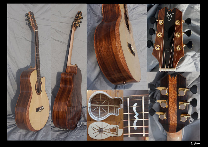

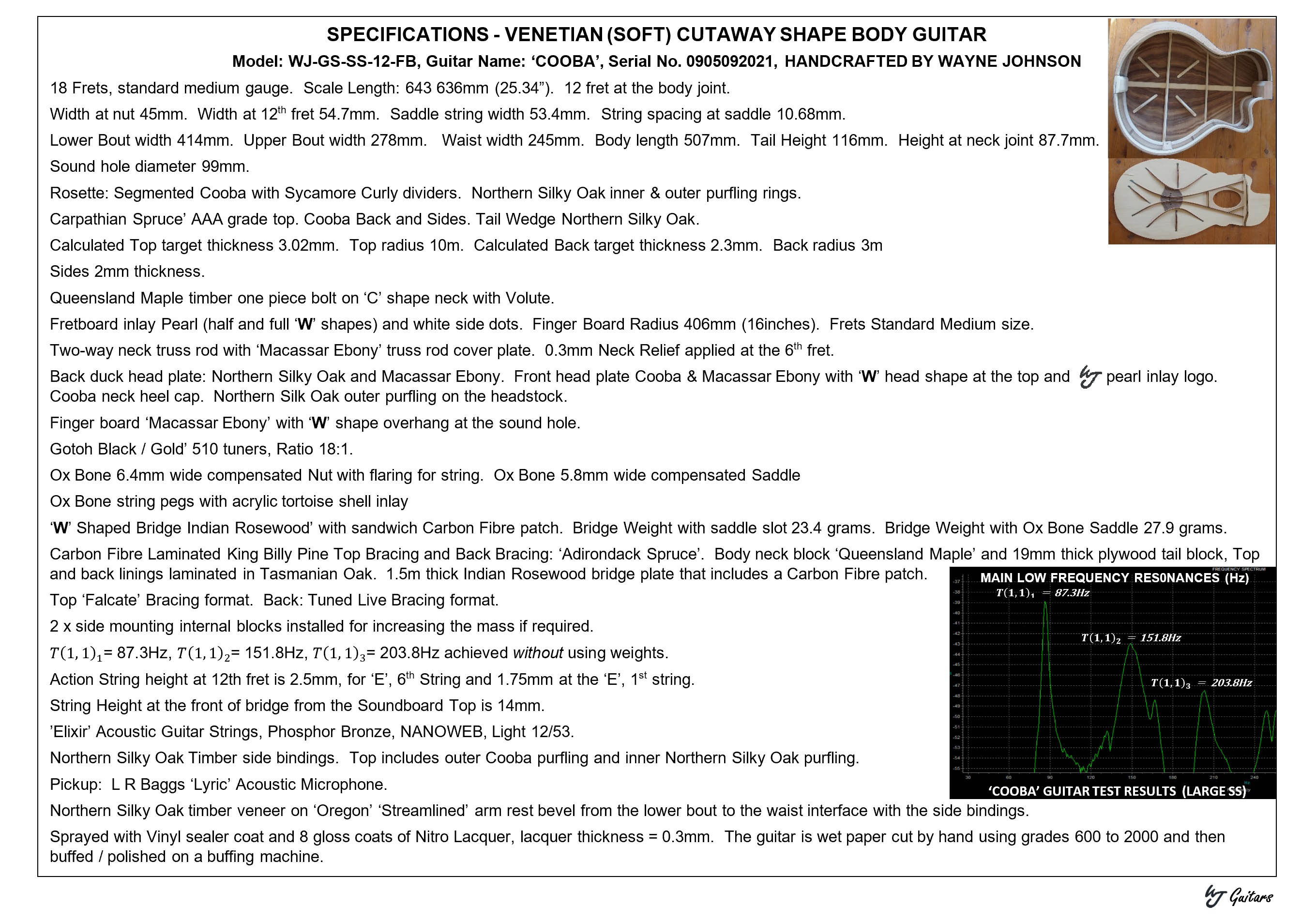

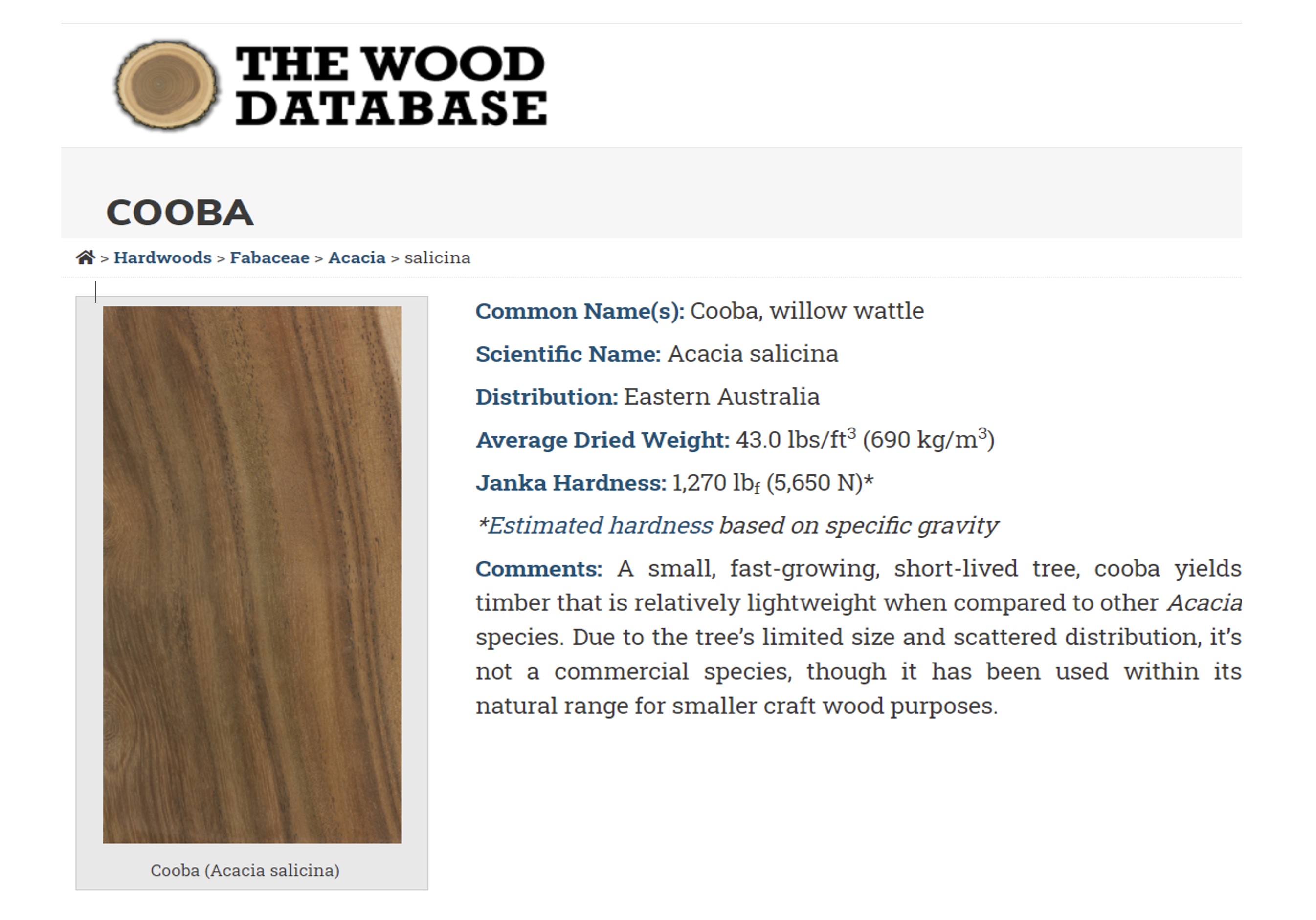

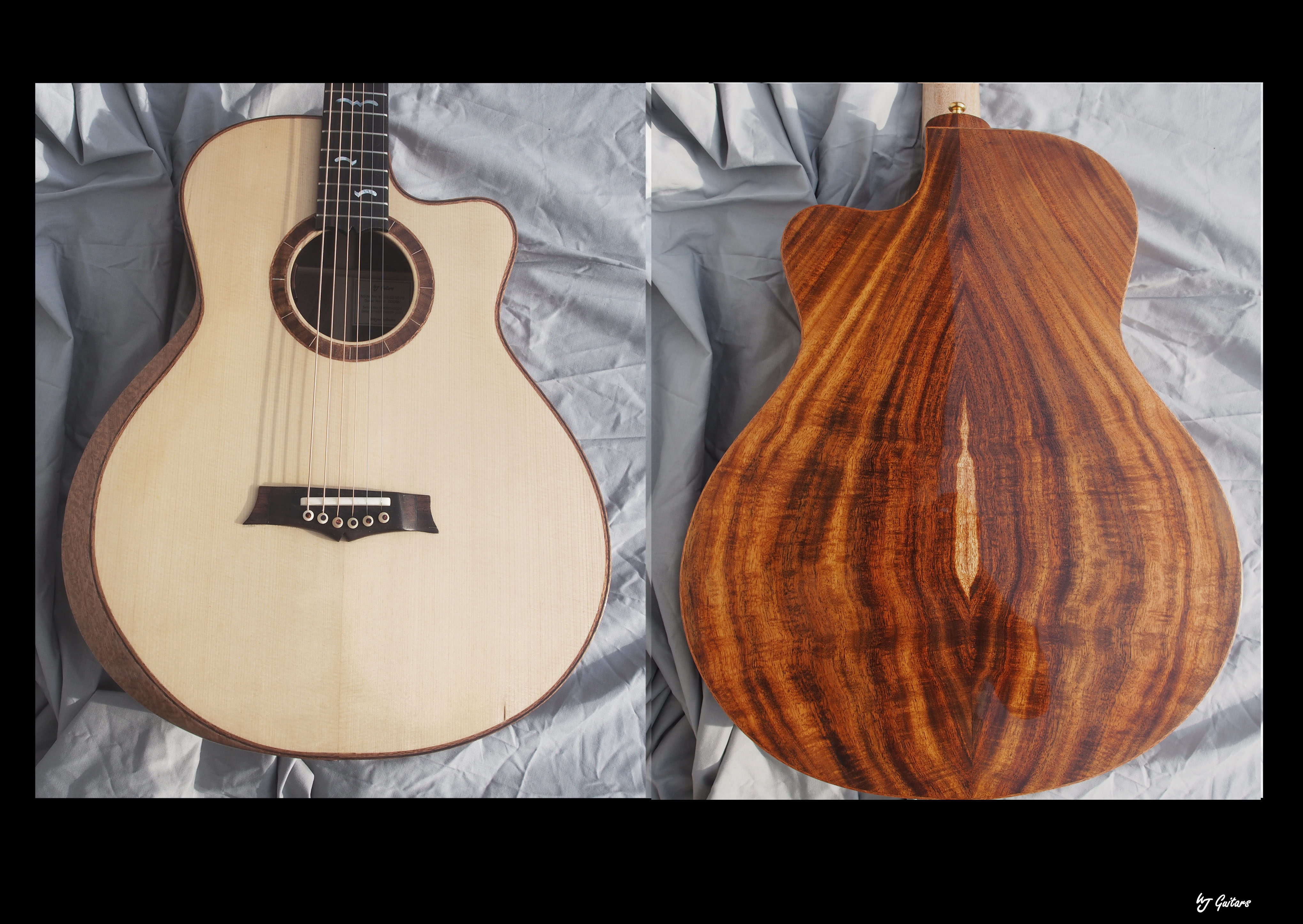

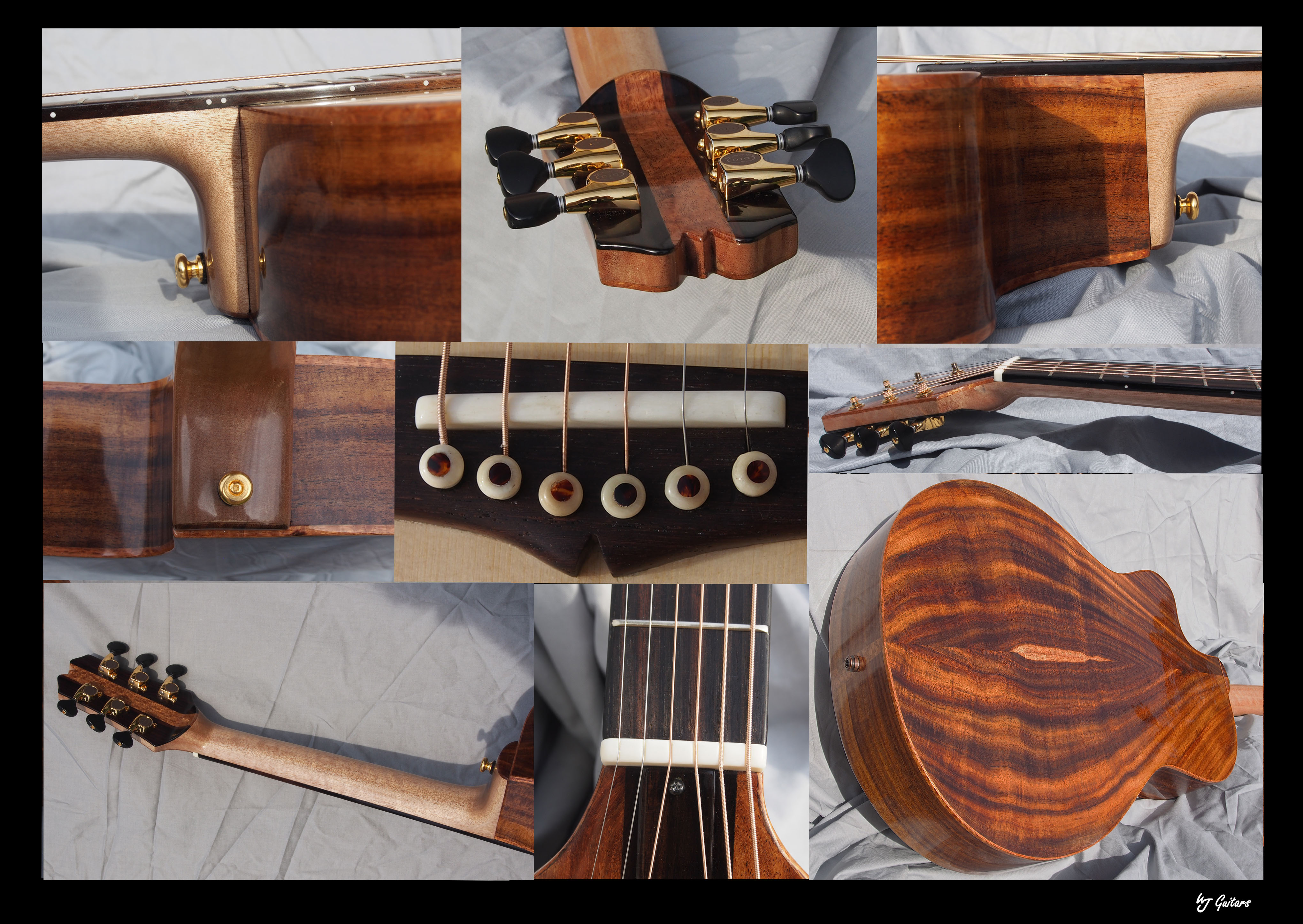

I have now finally completed the 'Cooba' Guitar and so far have not had to make any adjustments to the guitar neck or, compensation. All appears to be settled and stable so far. I have attached the final Guitar Gallery Compressed Photo pages, Guitar Specifications / Frequency Graph tests and the 'Cooba' timber information details.

Hi Wayne,
It is a really beautiful guitar. I clicked on the link and have had your playing on whilst I am working. Nice playing, don't sell yourself short!! If you are really think you need to improve your timing, there is a great app called Rhythm Trainer. It shows a rhythm and then you tap the rhythm on your phone screen. Great app and a nice distraction every now and then.
Can you confirm that the first part of the video is not EQ'ed etc?! (I actually thought the start of the recording was EQ'ed etc. until I read your post properly. Very nice).
Quick question, the distance from the edge of the fingerboard to the E strings at the nut seems wider than normal. Is that the case or is it just the photo?
Congratulations.
Dan

The width from the outside edge of the fretboard at the nut end for the 1st and 6th 'E' string is 4mm.

Very nice Wayne. I like your arm bevel is additional to the soundboard plantilla

A little wider than the guitars I have laying around, but nothing drastic. Thanks for the info - trying to learn as much as I can.

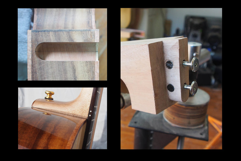

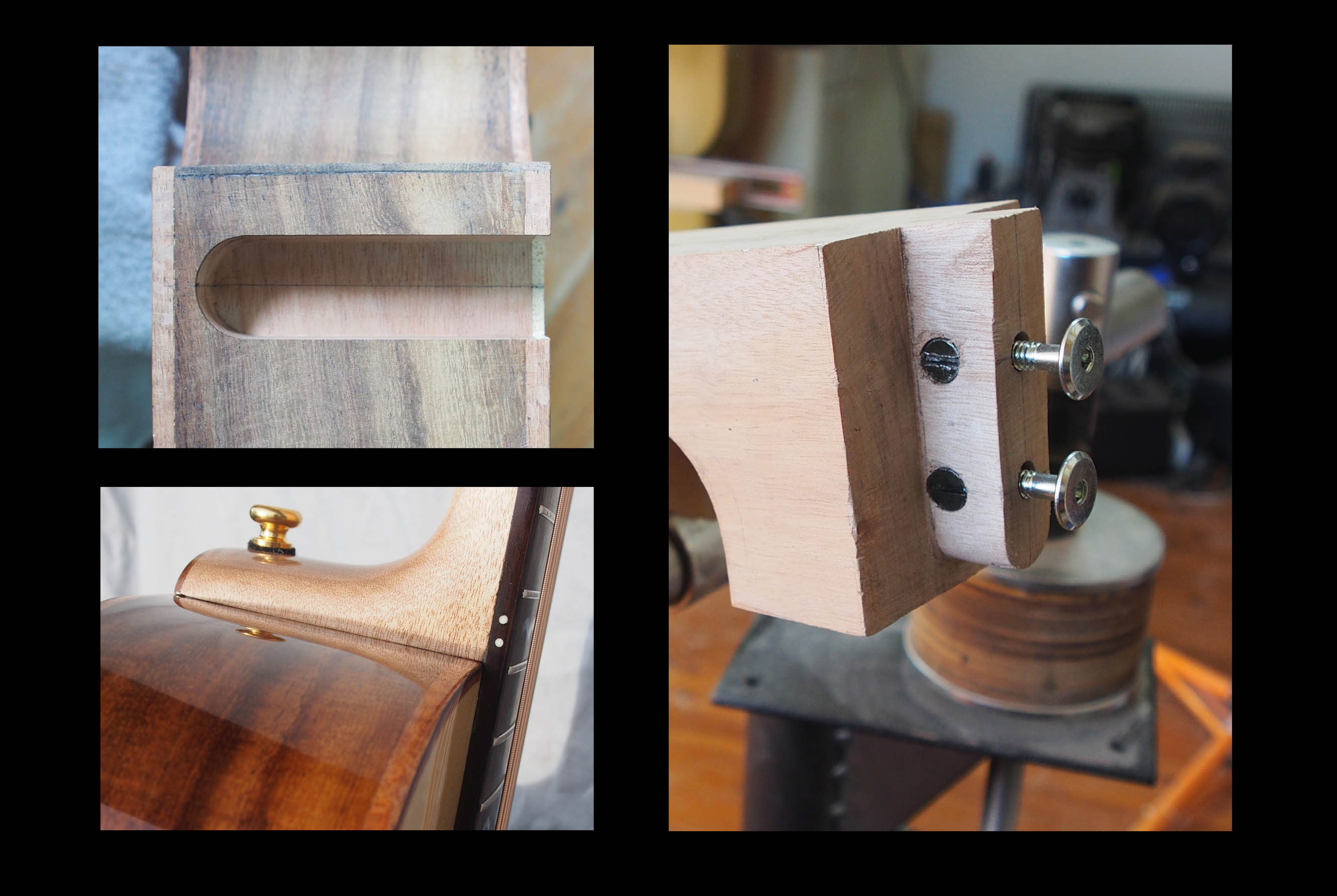

Re: Cooba Guitar now completed
So much detail - and that Acacia is quite magnificent.
I wonder what the neck body joint is? There doesn't seem to be room for the G&G bolt on, and you also have the strap button into the heel...?
Great stuff Dave
Great stuff Dave
- WJ Guitars
- Posts: 411
- Location: Sutherland NSW
Thanks Dave for the great comments. The body joint is a bolt on neck joint using barrels (see photo attachment) and yes there is enough meat in the neck heel to screw the strap button on.by Dave M » Thu Oct 07, 2021 3:20 am
