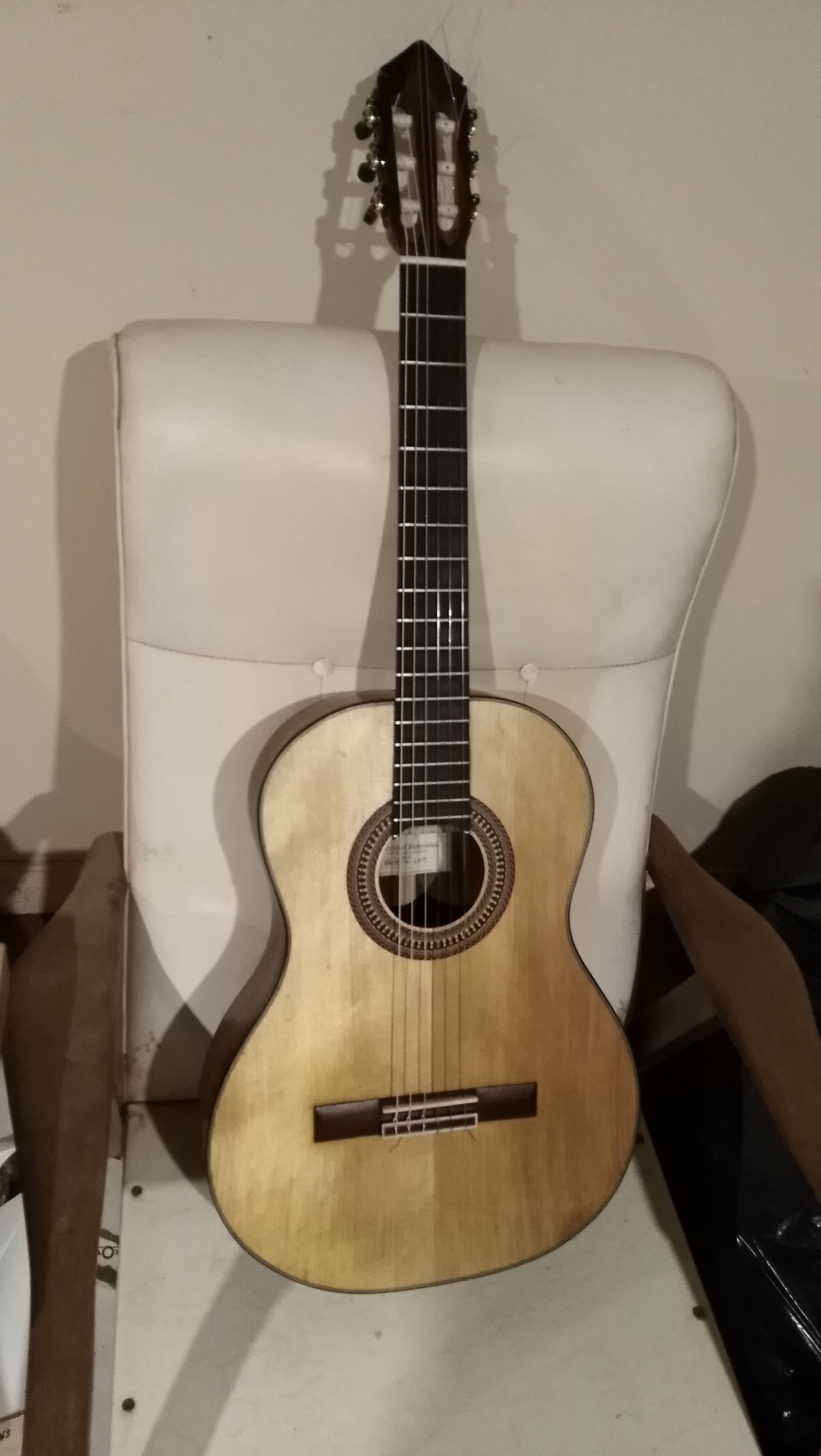

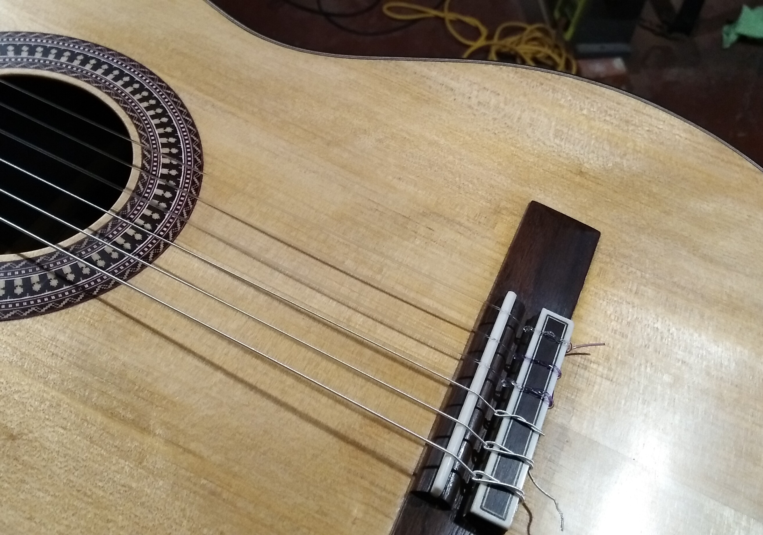

Post by kpcart » Wed Jul 24, 2019 2:23 pm
Krzysztof Piotrowicz No. 11 Classical Guitar.
Ive been getting great results from the Araucaria timbers (Bunya Pine is the most famous) and recommend these woods as a Spruce alternative, and a better instrument timber for classical guitars than the tasmanian soft conifers (Huon pine and King Billy pine). Though as with any wood, pick a light and stiff cut with excellent tap tone.
Specs:
Soundboard: Norfolk Island Pine (Araucaria heterophylla)
Back and sides: Ringed Gidgee (Acacia Cambagei)
Neck: Spanish cedar with Spanish heel connection
Fretboard: Indian Ebony
Bridge: Indian Rosewood
Bracing: soundboard 7 fan, no lower bout V braces or bridge plate. Back 4 horizontal (usually I use 3, but need to tune Gidgee to work)
Tuners: Der Jung 18:1 with Acacia buttons
Binding: Ebony, probably won't use again
Rosette: pre purchased online
Finish: Tru-oil, low sheen
The wood combination has resulted in a guitar with deep basses, and thick woody trebles with great sustain and vibrato, but at the same time has clarity and brightness. Need to make recordings of this.

Post by RodC » Wed Jul 24, 2019 3:56 pm
Nice guitar Krzysztof. I'm looking forward to a sound snippet :-)

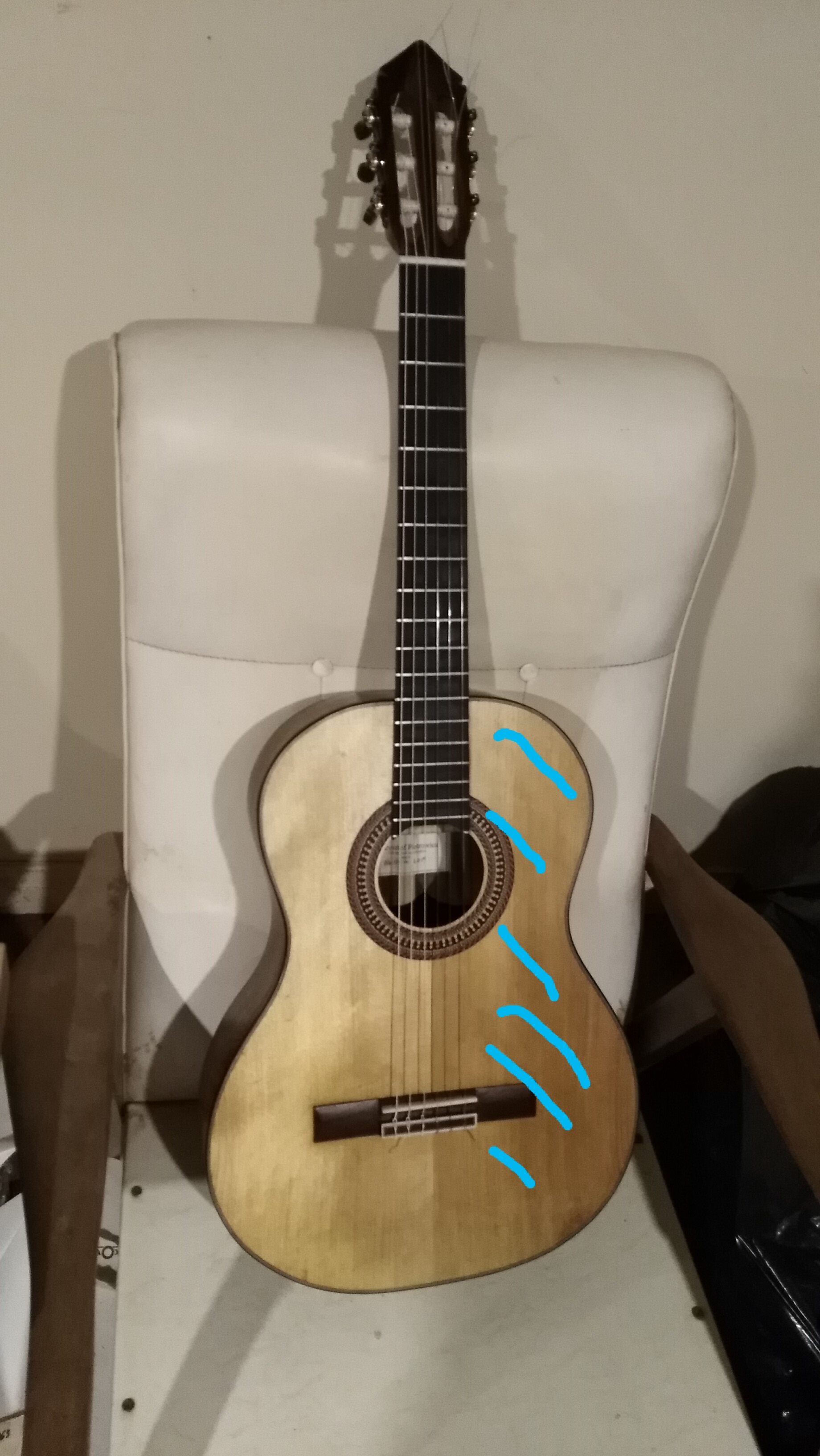

It may be just the light in that photo, but the soundboard looks a little mottled and there seems to be some colour difference between leaves. Is that a feature of Norfolk pine? or is it just the photography?
I don't think these things are bad per see, just a bit different from the monotone you see on most sound boards.

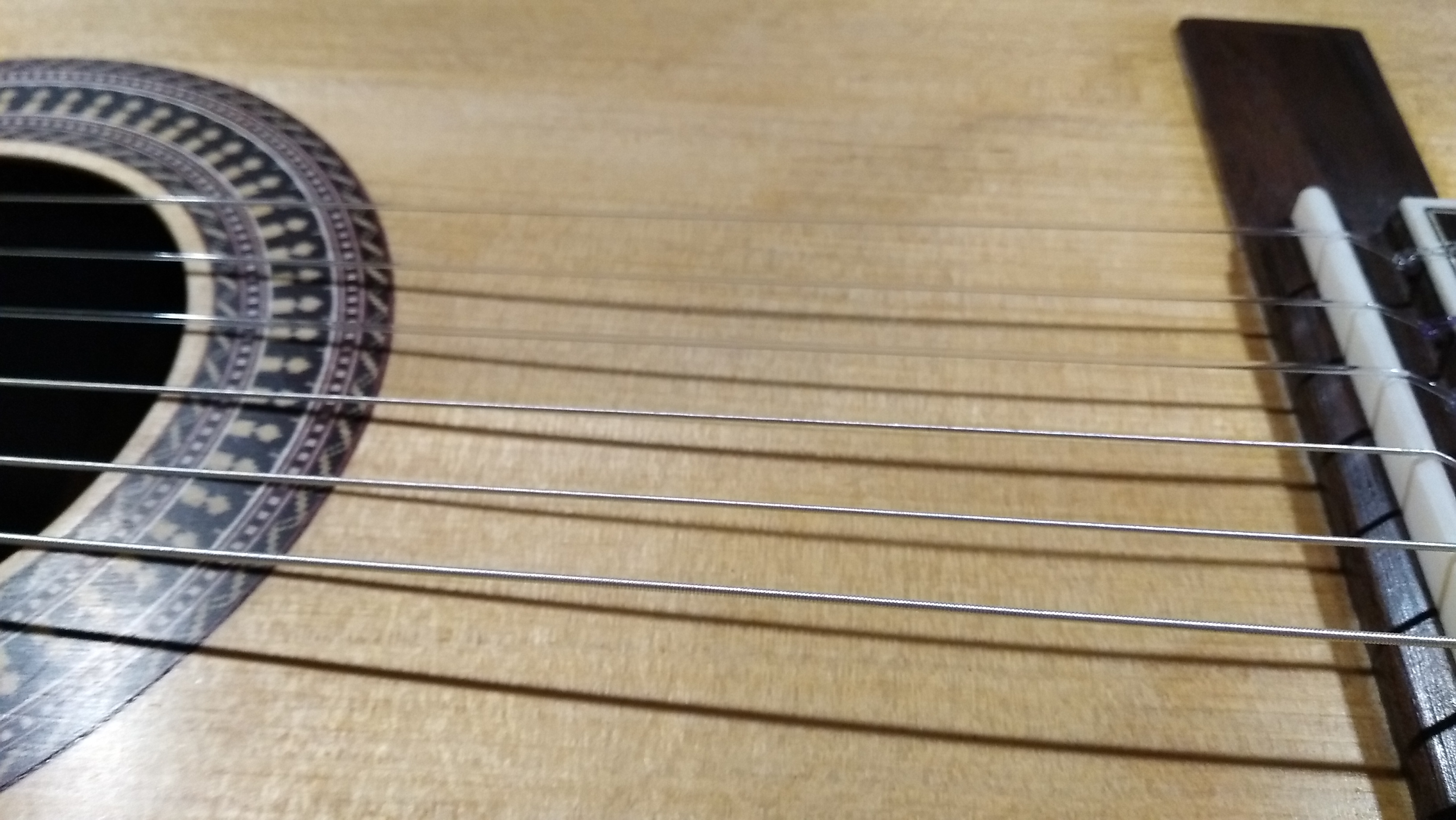

Post by kpcart » Wed Jul 24, 2019 8:11 pm
Yeh I haven't seen any as even colour as spruce for instance, but I don't care, I judge the timber on its tap tone and feel (stiffness, weight). These trees grow more ornamental and in different weather conditions and not in forests like alpine conifers so I doubt there would be much spruce looking, but I'm also sure there is some out there. I like this set of Norfolk, because it looks like vintage old wood, has nice tight grain towards middle of board with nice cross-grain, nice figure and colour and grain variety.
Also this nice figure I don't know what it's called, comes in at angle:

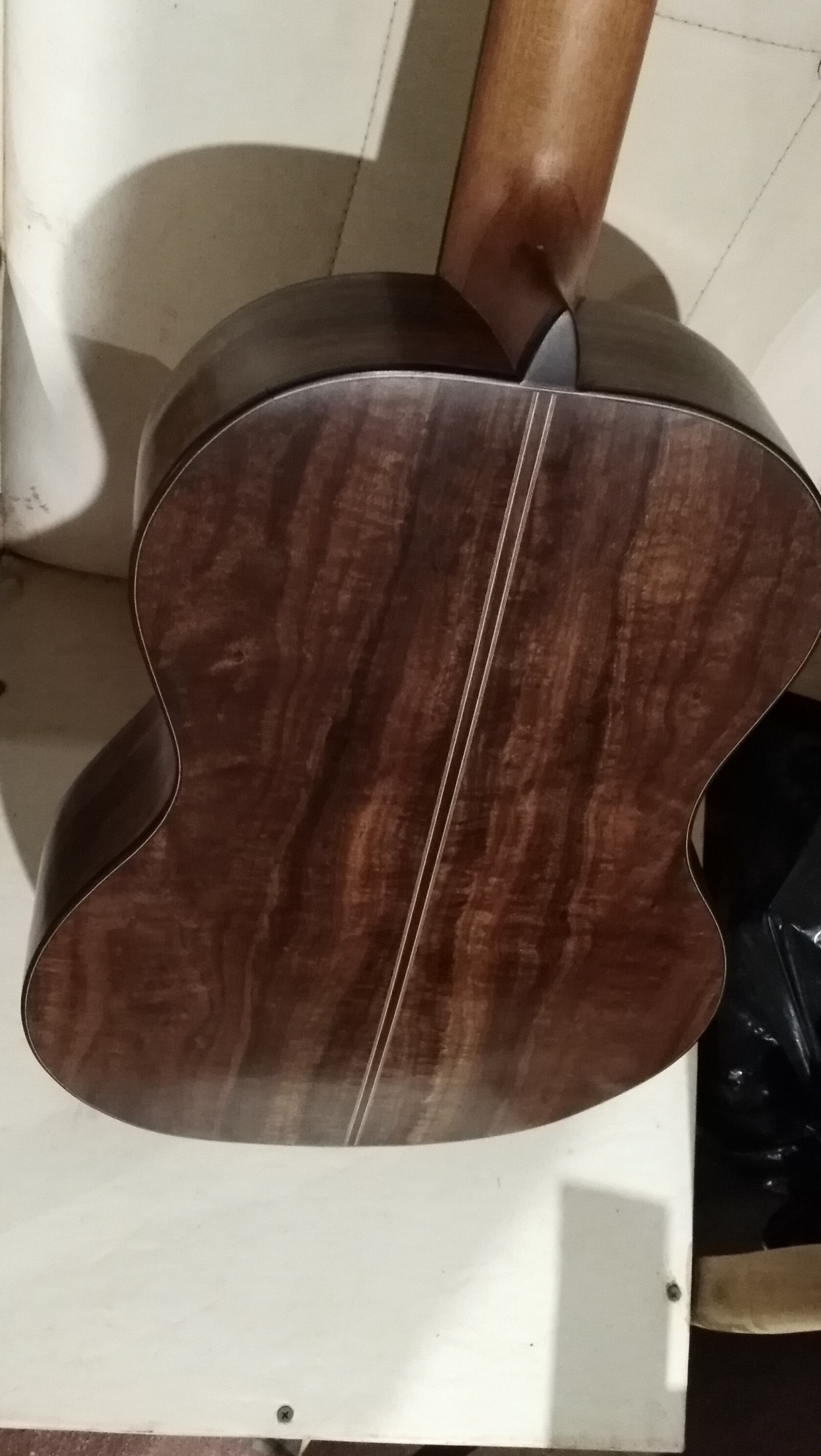

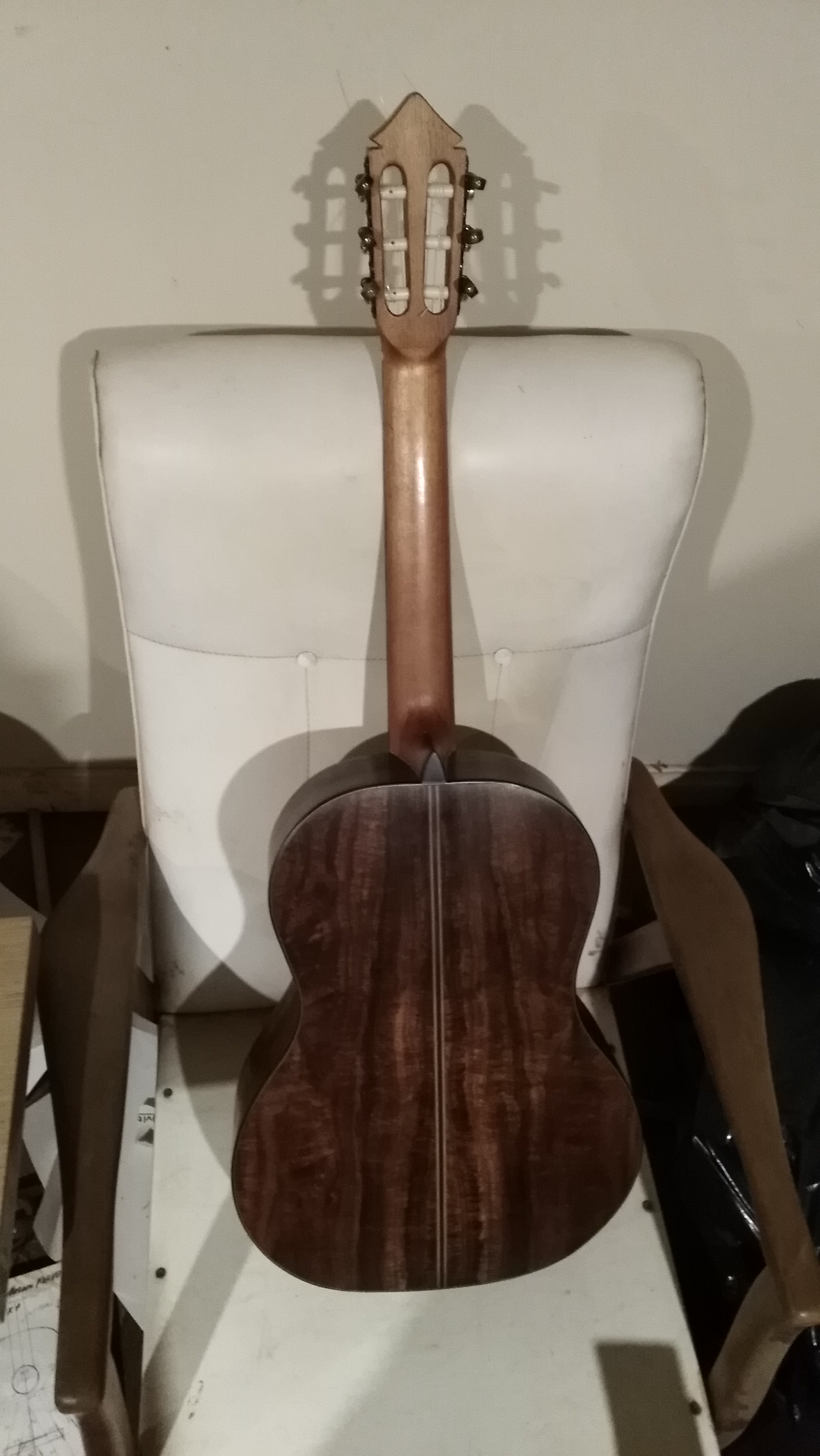

The Gidgee from curly timbers was sold as parlor size, so sides were a bit short, hence big endgraft with vic blackwood.
