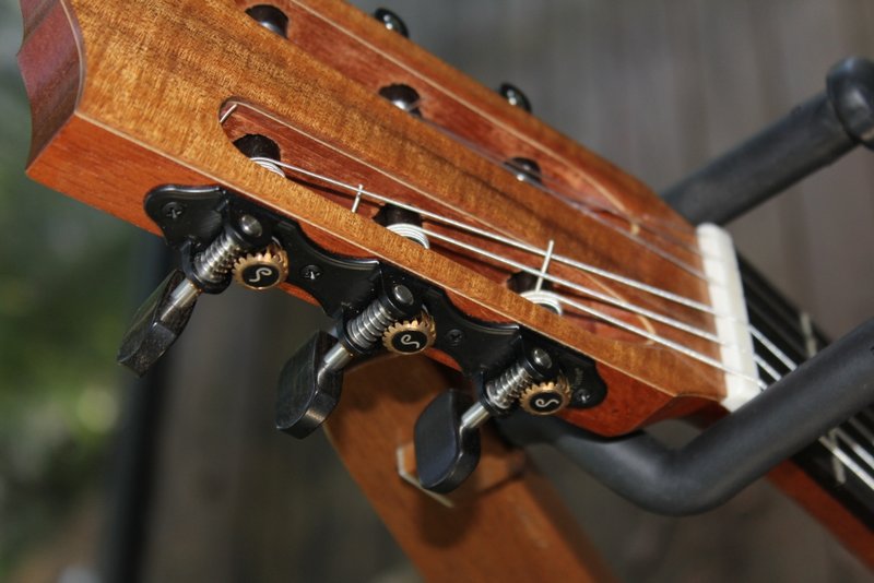

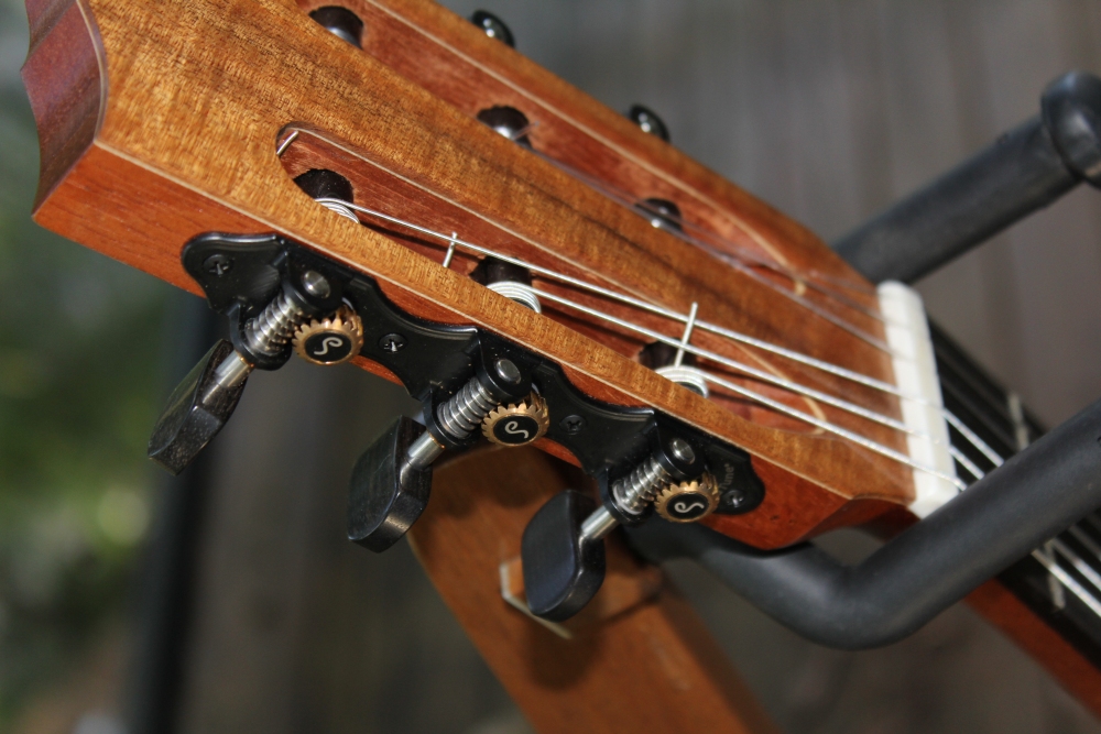

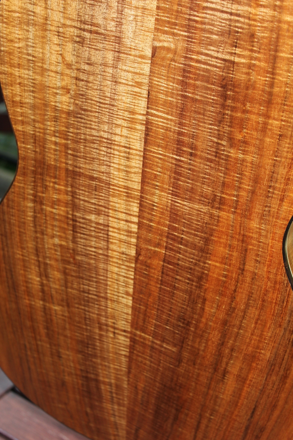

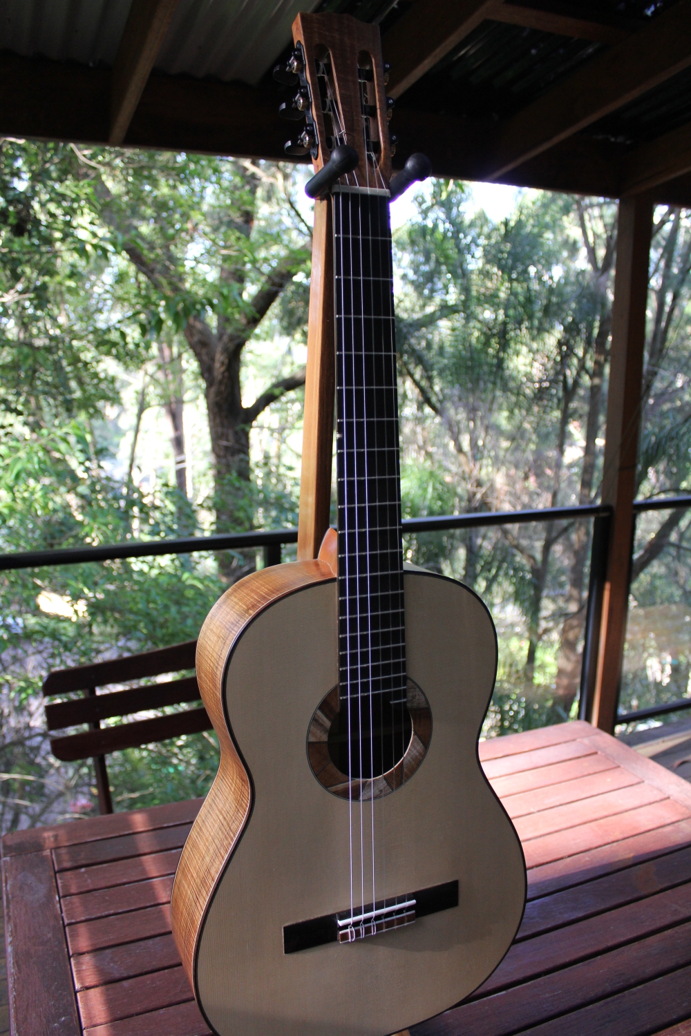

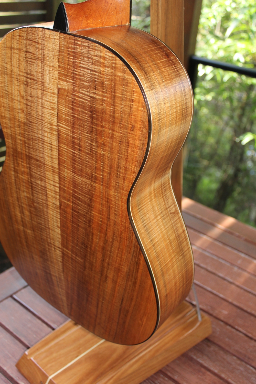

Recently completed Zenith model Classical for 'stock'.
Soundboard: Spruce
B&S: Tasmanian Blackwood
Neck: Australian Cedar
FB: Ebony
Bridge: Brazilian Rosewood
Rosette: Tassie blackwood
Tuners: Schaller Grandtune
Finish: Thin Semi gloss nitro
Has my typical sound - huge and very responsive.

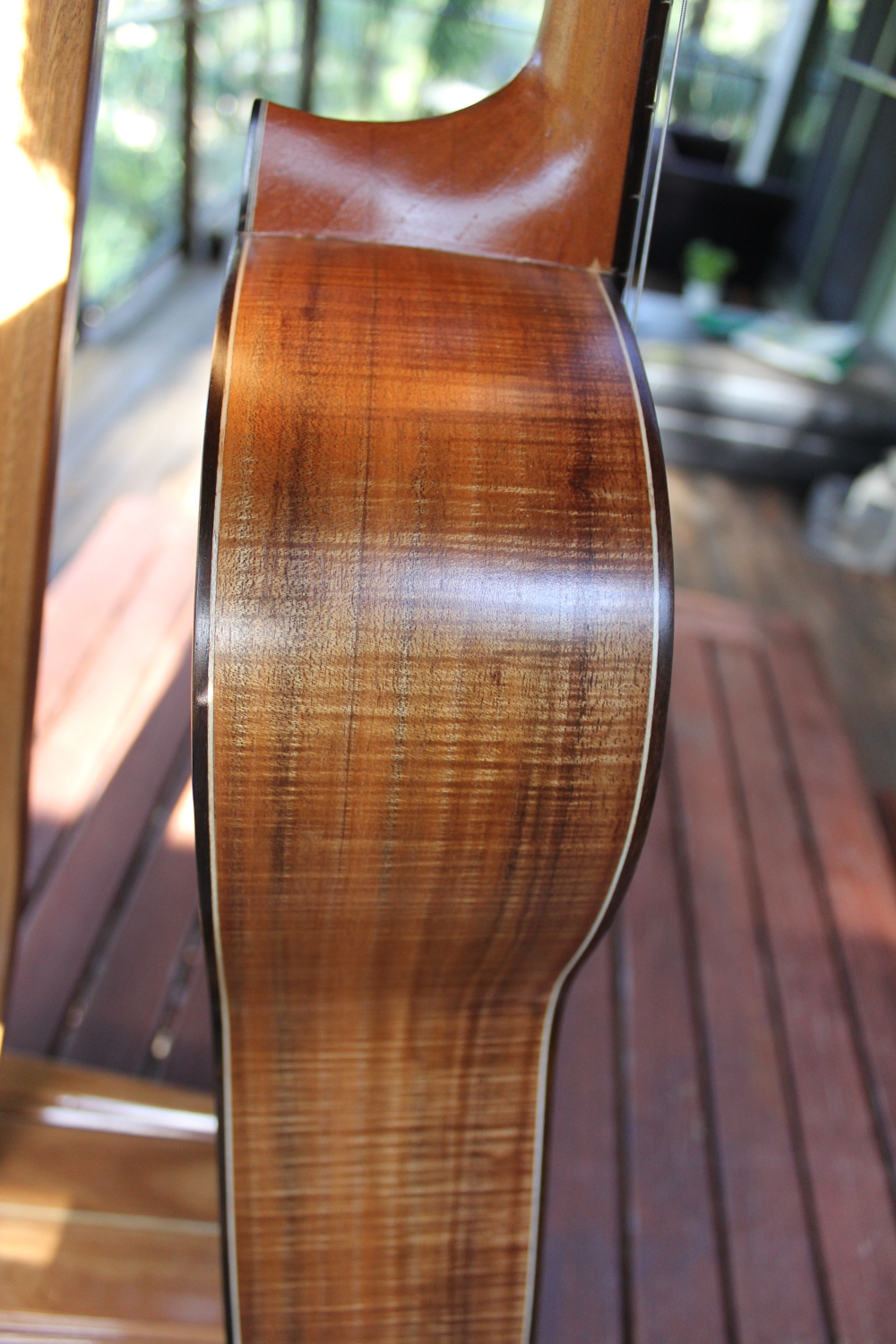

I particularly like your heel shape. That is the style that I used to aim for but unfortunately since I now always do cutaways I'm stuck with a rather formless round shape. But I love the access to the upper frets.

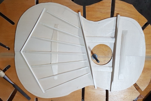

What bracing are you using? And have you decided on a particular layout?

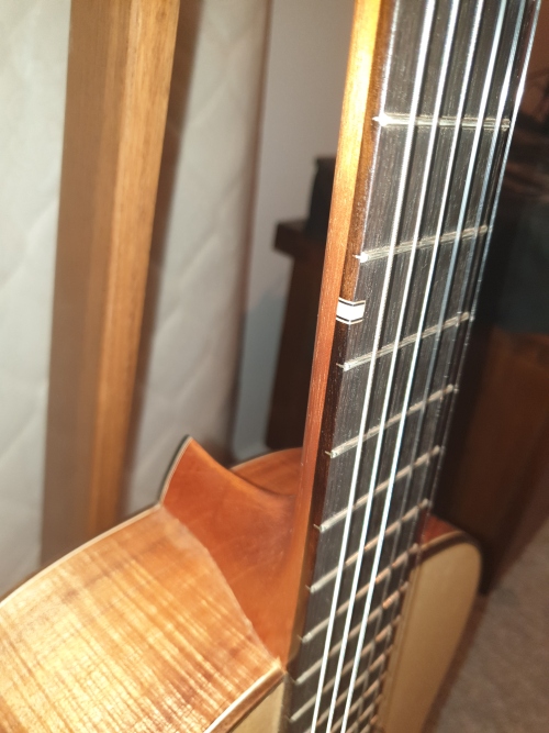

Post by lamanoditrento » Mon Apr 15, 2019 4:23 pm

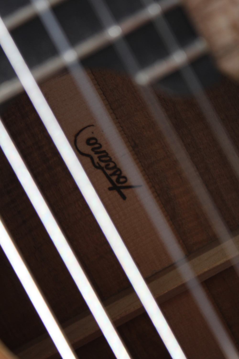

Very nice Steve. What have you done with the 7th fret marker?
Dave M
Thanks for the kind words Dave.
The inspiration for my bracing setup was based on a 1937 Hauser plan, but i've modified the positioning and made it asymmetrical with a slanted lower transverse. It's since ended up more like a 7 fan Fleta design then a hauser - but yet still very different.
Thanks Trent,
See below poor quality phone pic :)
It's my usual bone and veneers setup.
2019-04-15 22.41.31.jpg (147.54 KiB) Viewed 17132 times

Nice guitar, what about back bracing? I find that just as important to the sound as the top, they have to speak with each other. I'd probably use 4 braces instead of 3 on blackwood from the sets I've got, but haven't used that timber yet.
Steve.Toscano
Posts: 495
Location: Port Stephens NSW
Re: Fresh off the bench Blackwood/spruce classical (PIC HEAVY)
Post by Steve.Toscano » Tue Apr 16, 2019 11:39 pm
I do 3 transverse back braces and 4 star braces as per Trevor Gore. All my classicals are done this way.
For flamencos i leave the star braces out and space the trans braces equally.
I did do one non live back classical with 4 trans braces which turned out great. It was indian rosewood and was done this way as the customer requested a non live back.
