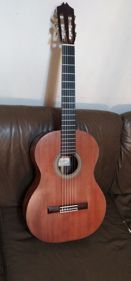

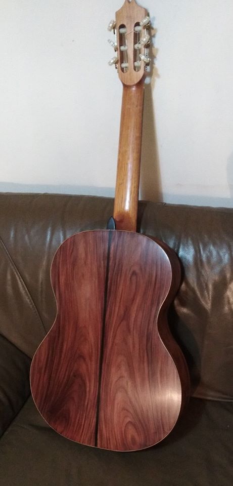

Post by kpcart » Sat Feb 09, 2019 5:41 pm
recycled Californian Redwood soundboard
Pau Ferro back and sides
Spanish cedar neck
7 fan bracing, no bridge plate, 3 brace back

:cl Great looking guitar. Out of interest what is the scale length, Neck joint? Im building at the moment and always nice to know what the detail is.

650 scale, 50mm nut. Spanish heel neck joint. 7 fan braces, no bridge plate. 3 braces back. Rosewood bridge ~19 or 20 grams. Saddle height 10mm above soundboard. Body resonance G (i prefer f# but its hard to predict).
