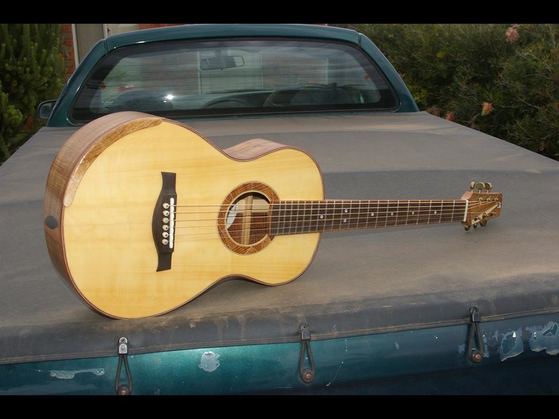

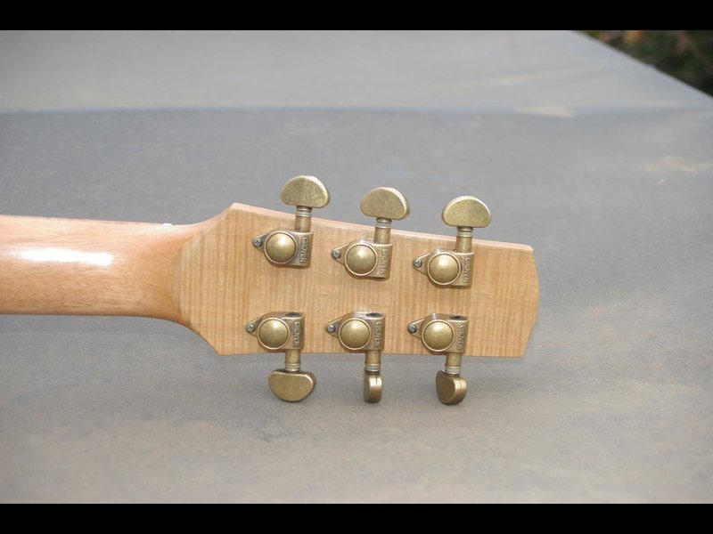

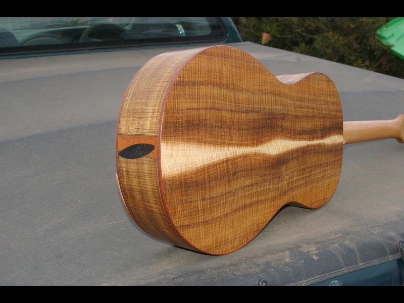

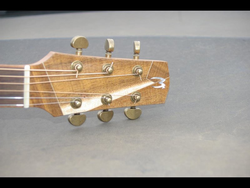

I've just finished this guitar, a parlour size made from another great set of b/wood from Pete plenty of figure in it, the Huon top is also from Pete. Mahogany neck, EIRW f/b and bridge, jarrah bindings on the body and b/w bindings on the f/b. I used off cuts for the rosette and h/stock veneer. Hard shellac finish. Grover tuners. Sounds great I'm a bit of a Huon fan now, this is about the 4th time I've used it.

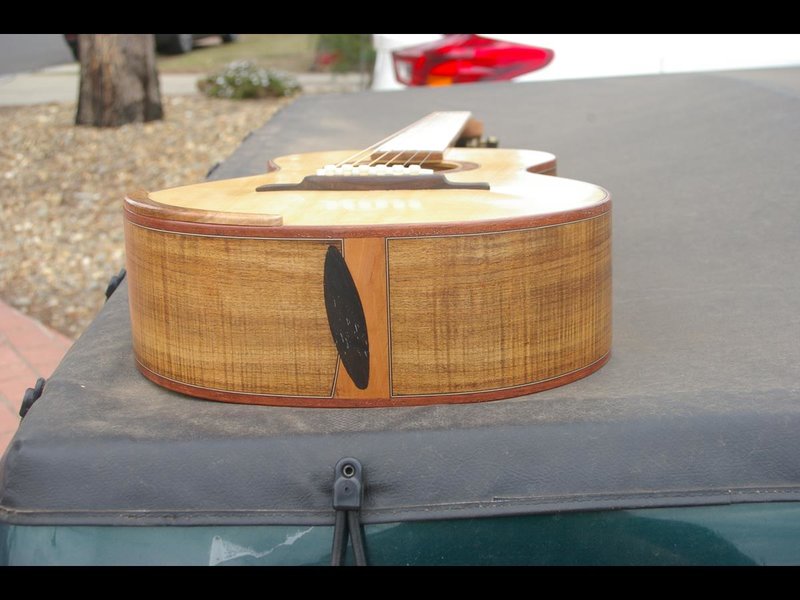

Nice! How is the armrest attached, magnetised? Also, the endgraft is interesting with the asymmetrical end to the sides and with an ebony inlay. I feel like there is a story there. Anyhoo, very nice instrument :cl :cl

Thanks guys. You’re on the ball Trent, I cut one of the sides to a wrong pencil line which left the side about 20mm short so I widened the tail block and did a bit of creative work with the end graft normally I use a piece of bindings but couldn’t this time, nice pick up lol. Wayne

Noticed it but was a bit afraid to ask what was going on. :mrgreen:

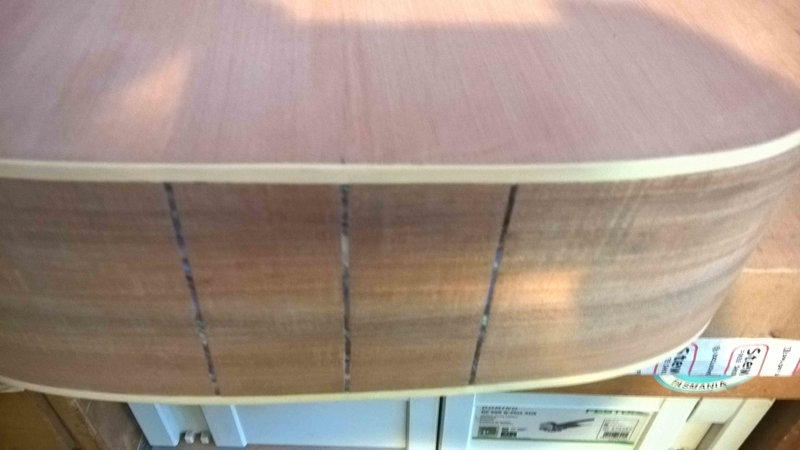

Here's one that I had to "adjust" :D
I love what you've done .........
Gives me inspiration for all my future re-adjustments.

No problem Pat, like I've said quite a few times, we all make stuff ups, there's usually some way around them ( maybe not every time ), gives the brain some exercise trying to figure out a solution ( after the initial swearing and cursing :lol: ).
