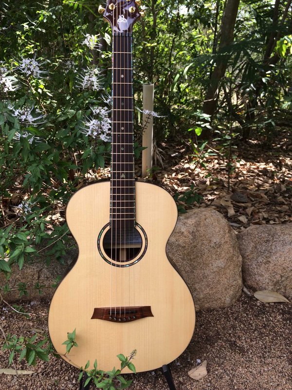

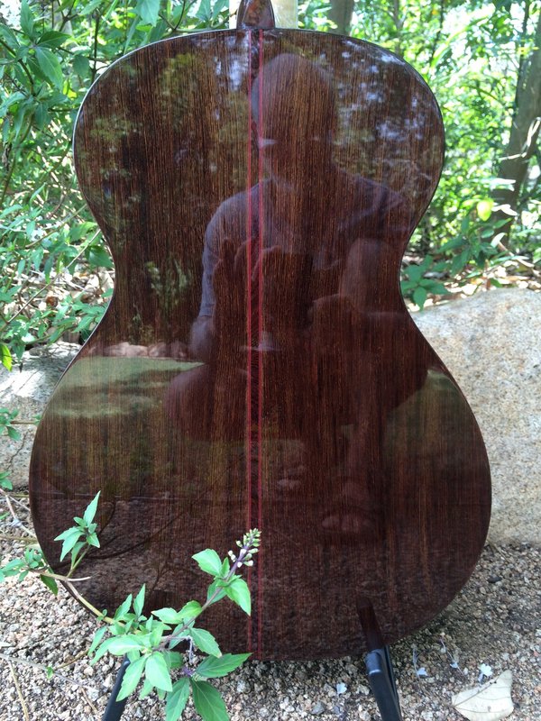

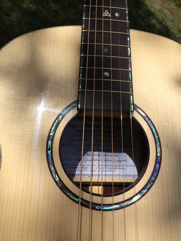

Wenge Back & Sides, mirror Nitro Cellulous finish
Paua Rosette with Black/red/black purfling

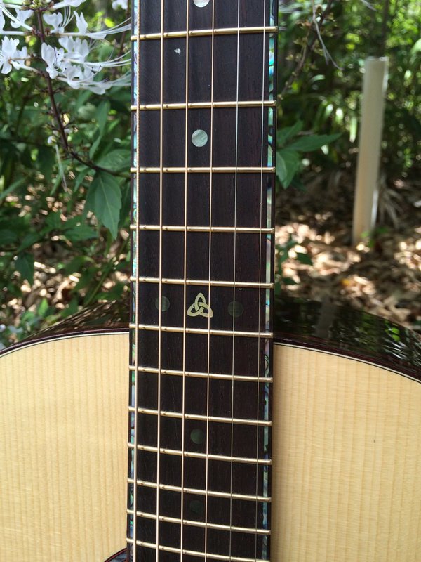

Purple Bauhinia Fretboard, Evo Gold Fretwire

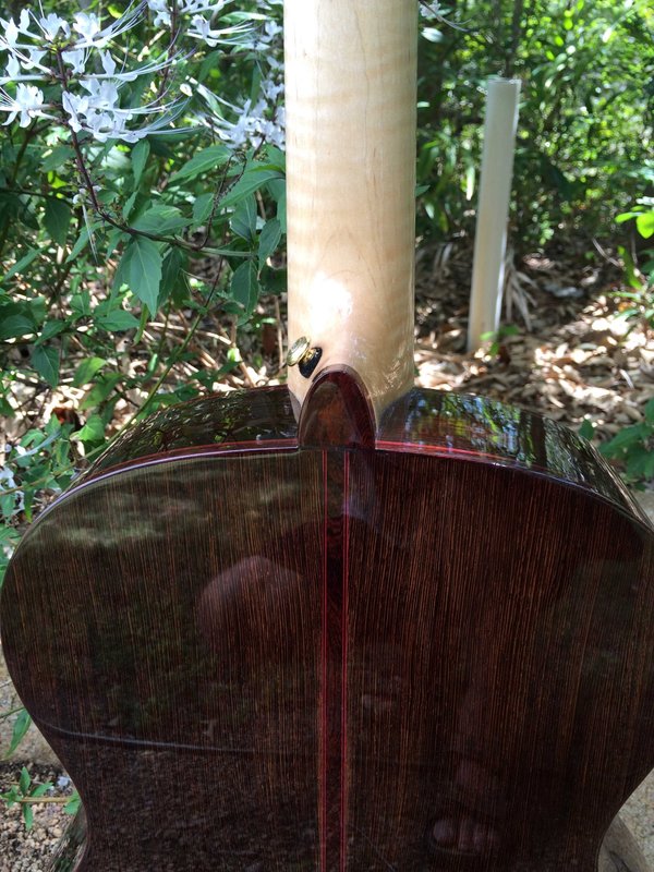

Curly Maple Neck, Purple Bauhinia Bindings, Backstrip & Heel Cap

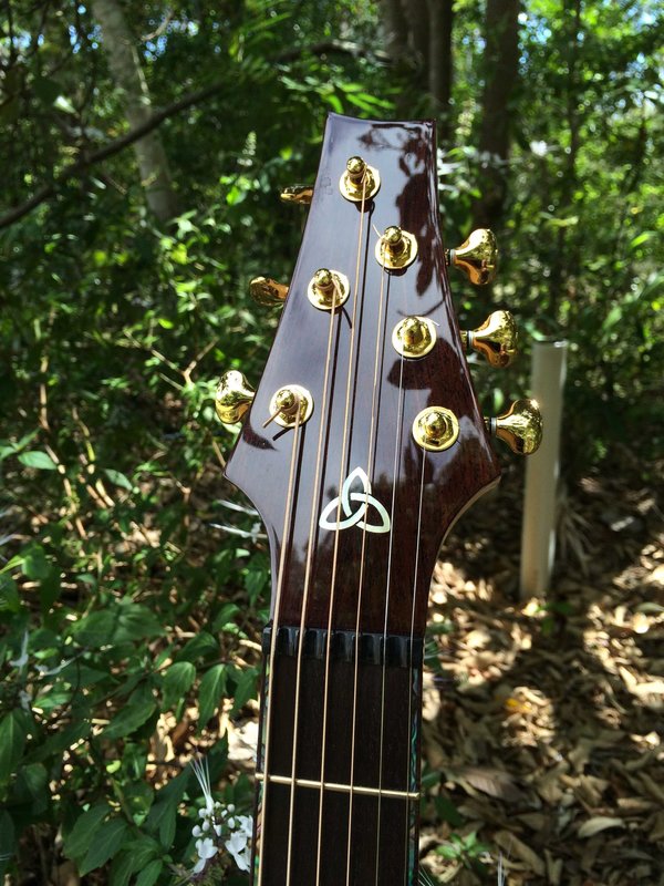

Gotoh Mini 510 Tuners

Adirondack Soundboard, Paua Rosette and Fretboard purfling

Post by demonx » Sun Jul 03, 2016 4:56 pm
That looks great! Very nice!
I bet you had a great time pore filling the Wenge!
Graham Long
Posts: 140
Re: Mini Jumbo Wenge
Post by Graham Long » Sun Jul 03, 2016 5:10 pm
Yep, sure did, it's like trying to pore fill a cheese grater.
I think it's worth the effort though. Sounds Great.

Post by Mark McLean » Sun Jul 03, 2016 9:36 pm
Looks outstanding Graham.
Is it falcate braced (I note some G&G influence in the bridge and headstock shapes), or CF reinforced traditional bracing?
Also, what is the black material in your nut and saddle? Looks nice, and quite different to bone.

Post by Graham Long » Mon Jul 04, 2016 3:45 am
Hi Mark,
Yes, its CF Falcate Braced. The Headstock is a give away isn't it.
The nut and saddle are Northern Teritory Buffalo Horn. I was given a couple of Buffalo Horns, its easy to work and polishes up really well.

Post by Dave M » Tue Jul 05, 2016 5:11 am
Extremely nice looking. The Wenge I've seen in the UK has ben rather blacker looking than that.

Post by Fisherman » Tue Jul 05, 2016 12:22 pm
Looks great, Graham. My next build will be Wenge so I'm glad to see how nice this guitar turned out!
What did you use to pore fill?

Post by Graham Long » Tue Jul 05, 2016 12:54 pm
I used Bote Cote epoxy resin on this one, also used West Systems and Z-Proxy. I think Bote Cote is the best of them, and its made in Australia
Boat Craft - Brisbane
(07) 3806 1944
They sell it in sample packs.

I have some large billets of Wenge and they look darker than the back and side sets that have been sanded.

Fisherman wrote:Thanks Graham.
Forgot to mention that purple bauhinia is pretty striking stuff! Like the colours...
It looks darker in the photos than it is in the flesh. It's feels quite oily but machines and sands well. I'm keen to get some bigger pieces for back and sides, they are hard to get as most trees hollow.
