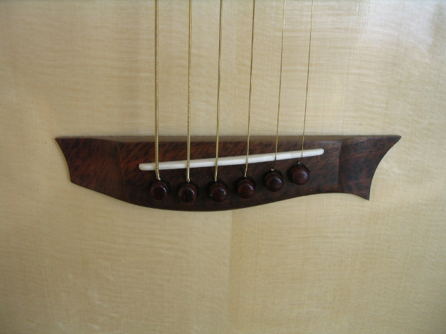

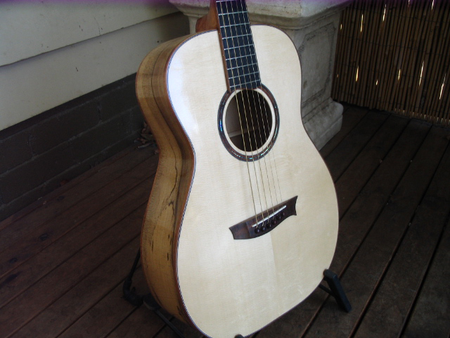

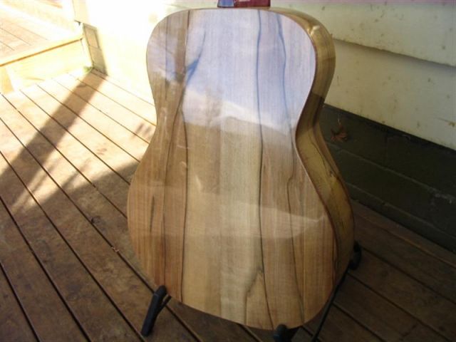

We finished this this week.
Blackheart Sassafras with an Engelmann top, Blackwood bindings, Tiger Myrtle Bridge.
As I had assumed, the Sassafras is a warm sounding tonewood not unlike Mahogany. I have another Dread made from Sassafras that'll be finished in the next week or two so I'll be able to compare it with my D18.

A very Sassy looking guitar Bob.....
I love the bridge

Very nice looking silk figure in that top. I assume it's one of Graham's?
The one I'm building with at the moment has similar figure. I'd never seen it like that before. Very subtle and quick beautiful. Your finish is looking good. Those lessons at TAFE look like they've paid off.

Thats one beautiful looking guitar Bob! I have a soft spot for the sassafrass. The engleman certainly has a luster to it and nice figure.

Now I like that, a very classy looking guitar.

Boys, another guitar of quality from your stable. Looks an interesting wood , and of course if it sounds like mahogany must be a winner.

Another Great job Bob,Dave !! The sassafrass looks very appealing and "sounds like mahogany"
is a very good sound to have. It reminds me a little of
your native olive! I like your bridge too and thats some sweet Engleman.

Wow, you guys can put out some beauties. That's a knockout! Tasteful simplicity with beautiful wood.

I likes that a lot. The sassafras looks great.

It will be interesting indeed when you do the D18 comparison. Did you weigh the myrtle bridge?

Yes this one does have a home Allen and it is one of Grahams tops.
Kim the bridge weighs 20 grams so it is quite light. I usually shoot for about 25 but this is a really light guitar weighing in a little over 1500 grams (3.3lbs) and the top is very lightly brace so I thought that weight would be appropriate.
One thing I will say about Sassafras is that is extremely easy to work, is one of the easiest bending woods (right up there with EIR) with very little springback and has no pores to fill. The figure in Sassafras runs the entire spectrum from none through to the extreme figure that Tim showed us a couple of days a go.
I glued up a neck blank yesterday from Sassafras with a Blackwood centre strip so I'm hoping that it will also be suitable for necks. I can't see why it wouldn't be, but Sassafras has generally been avoided by the majority of established guitar builders here in Australia so there is no body of evidence to support it's suitability.
