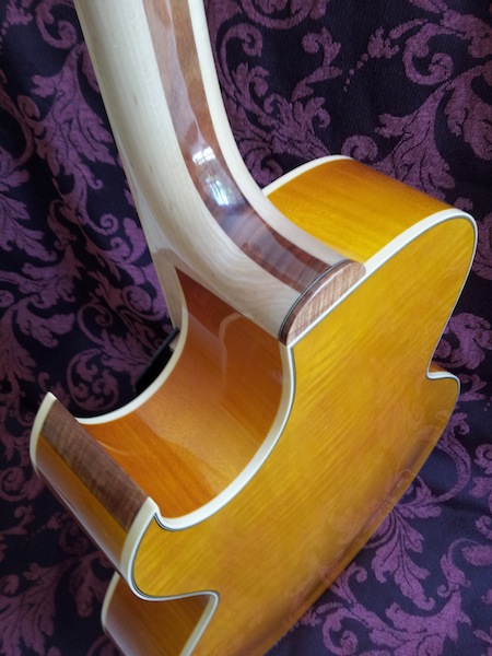

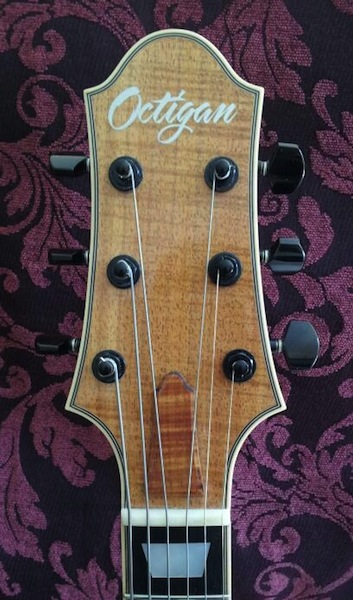

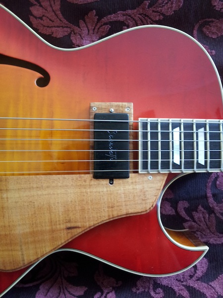

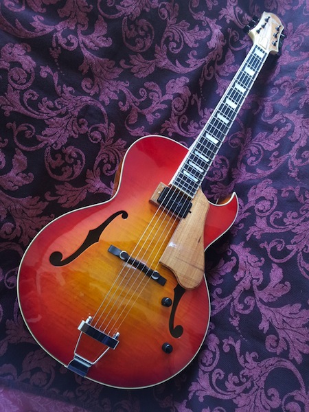

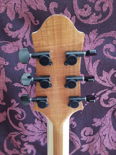

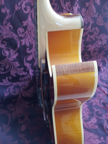

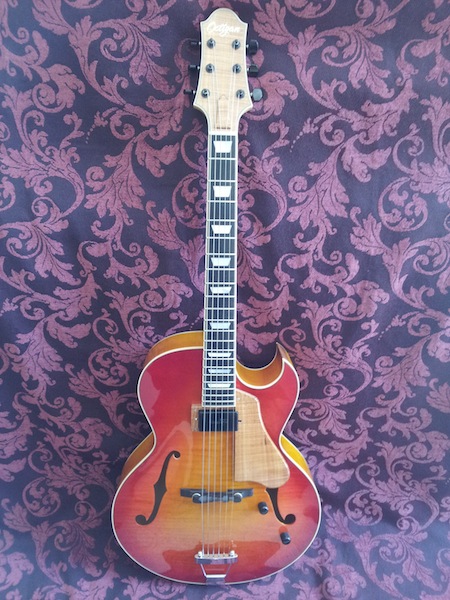

In the dimensions of the ES 175 this 25 scale jazz guitar has laminated maple plates front and back sides are laminated maple also, maple and blackwood neck,21 fret ebony f/b with wmop block inlay,I've made use of some figured blackwood in the veneers and finger rest and other locations just to add a bit more interest, Benedetto B6 pup, black Gotah tuners, finished in Mirrotone gloss.
Thanks for looking
Cheers.

Brilliant take on the 175 Rod.....one of my favourite jazz axes.

Thanks Martin, yeah they look kinda nice don't they, forget to mention,, has a bolt on neck too, c/f in the bracing and in the neck, blackwood from the Otways.

Very nice Rod, great workmanship.

That is a very special build.
I have a good mate who owns an ES 125 SC and it has a great playing action and tone.
Love it and look forward to a sound file in the future.

That is absolutely stunning. Well done.

Love Florentines on archies and Venetians on flat top goose sticks, just personal preferences. But stunning work as ever Rod well done :cl
