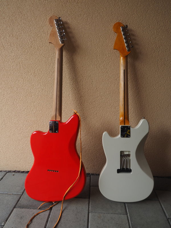

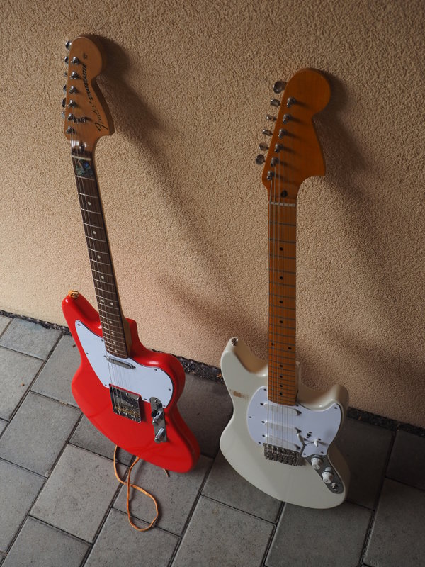

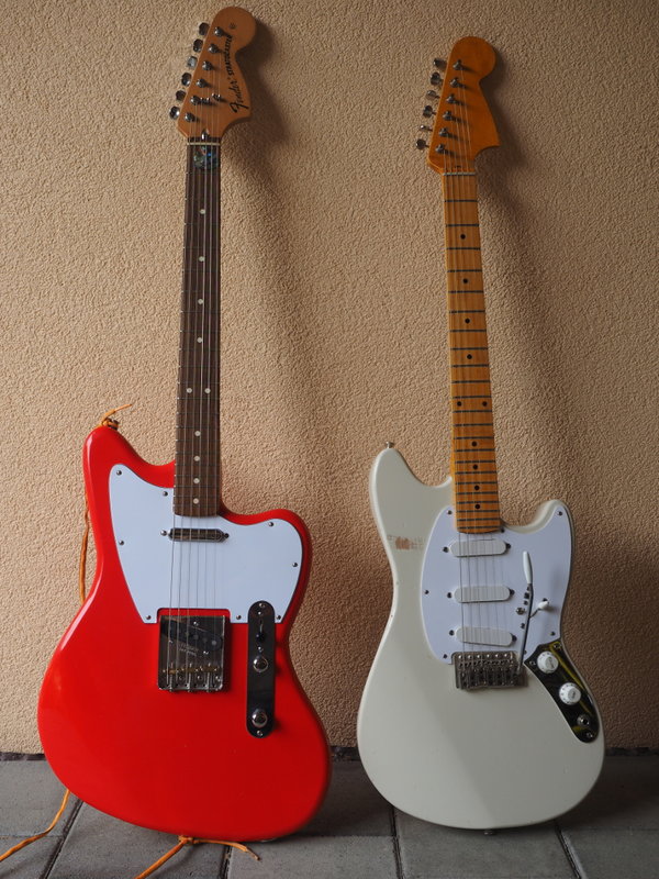

and while taking some snapshots of it I took some of my trusty Mustang as well, played that for about half a year as my main axe so it looks a bit worn already...
they both feature alder bodys, the stang has the standard 45mm and a rather thick one piece neck with the short scale
the tele has only 40mm, as a weight reduction measure, and a 70 classic strat neck (for now)
pickups are wound by me, the stang's mid one is there for catching feedback as that was something I needed in my old band...
might get kicked out or swapped for a sustainer at some point
the stang also features a kill switch in form of a taktile SMD, similar to Johnny Greenwoods, except that this one stopped working after a short while...
and a floating strat tremolo
tele has the 4 way switch series/parallel mod
thin nitro finish on both
and yes, the strap is a shoestring...
