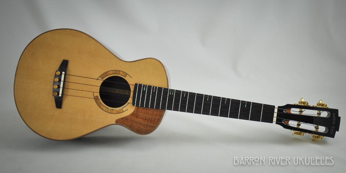

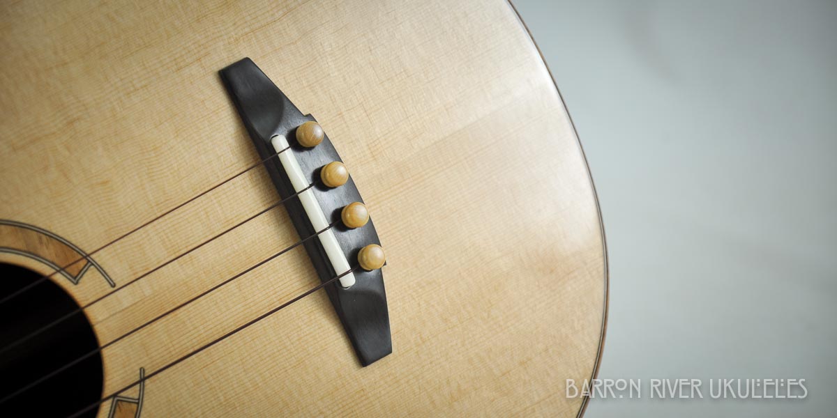

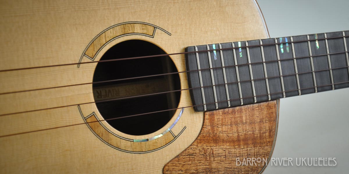

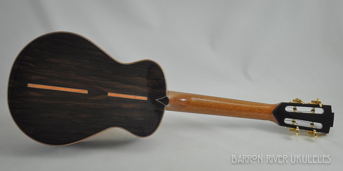

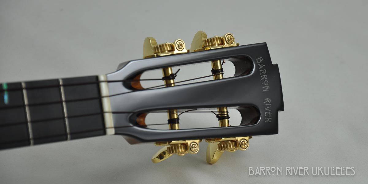

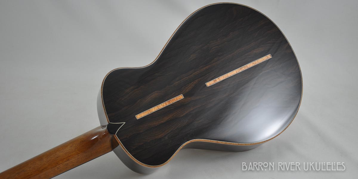

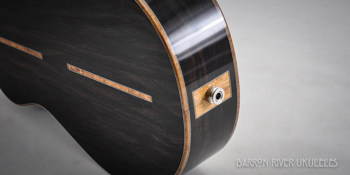

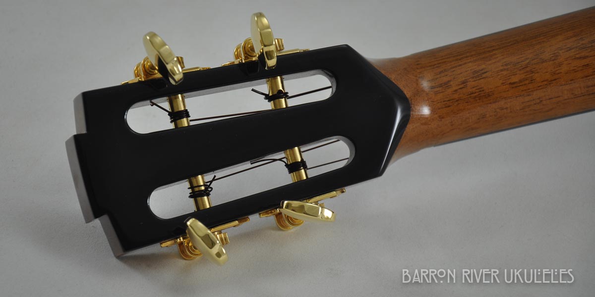

This one for a returning client that already has a Zircote Tenor from me. Must really like it. :D
Body - Zircote
Soundboard - Sitka with mild Bear Claw
Bindings - Australian Blackwood
Rosete - Australian Blackwood
Scratch Plate - Australian Blackwood
Fret Board, Bridge, Peg Head - Ebony
Neck - Mahogany
Machine Heads - Grover
Strings - Worth Browns, low G
Pickup - K&K Aloha Twin
Finish - Mirotone 3220
