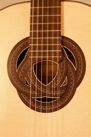

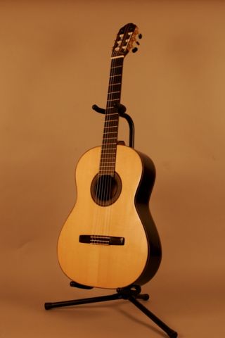

Hello ladies and gentlemen! I'm new to the Ausssie luthier's forum and thought I would take a moment to say hello , introduce myself, and share my latest lutherie project with you. I'm Gregory Fulghum from Denver, Colorado USA. I'm a classical and flamenco player and luthier in my spare time. I've been a student of Robert O'Brien, http://www.obrienguitars.com for the past two years, and I have constructed some truly wonderful instruments under his tutelage. Robbie is an amazing instructor, a great friend, and "I'd like to thank the academy... yup, cheers, thanks alot!".
Though I am strictly, and passionately, a classical/flamenco builder, I strive to interpret this instrument with a contemporary twist, marrying modern artistic sensibilities with a classical voice. I'm not a purist, I'm an artist.
My most recent project I submit for this forum's constructive critique. This guitar is made from a stunning back and side set of Tasmanian Tiger Myrtle that I obtained from Stephen at http://www.colonialtonewoods.com In fact, when this wood set arrived, I was so pleased that I immediately arranged for another set and was lucky enough to obtain the sister set from the same flitch. Stephen has some of the most amazing wood in the world and all my beer money and all my gratitude go to him. Trust me, his wood offerings are unparallelled.
The guitar I present today is paired with a master grade German Spruce top (LMI), braced with a hybrid Robert O'Brien/Antonio Torres pattern, and it sounds quite promising. It appears to be quite loud and fast in response at the present. Headplate and elyptical rosette are bookmatched (but not a true match) Tasmanian Tiger Myrtle, African ebony bindings, Honduran Mahogany neck, African Blackwood fretboard and bridge, Gotoh Premium Classical Tuners. I've used reverse mahogany kerfing top and back, mahogany back bracing, German spruce top bracing throughout the top. Incidentally, this is guitar #6 for me if you are interested.
In the coming weeks, a French polish will be carefully administered and then the final test... set-up and strings. Until then... let me know what you think! Incidentally, she's a keeper- not for sale. More pics to follow when the finish is on. Thanks for considering this one!

Beautiful guitar, very clean and refined work and some unique ideas you have going there.
That shot of the bracing and also the use of tiger myrtle for the back reinforcement strip highlights your attention to detail. Tiger Myrtle is a wonderful tonewood and you are on the money about Steve Roberson of Colonial Tonewoods. Steve is not only a great wood vendor but he is a great guy to deal with all round, so much so that he is on this forums preferred vendors list dropping in to make a post himself from time to time.
Anyhow, great work Gregory and thanks for posting. 8)

Beautiful construction too. the rosette is not to my taste, I guess I am too traditional of a mindset.
I see you have used reverse kerf linings, this seems rare in classicals. Having used it on a few builds, I would not want to go to standard.
What is the white/ black rim bracing?

Jeff- I sincerely thank you for your valued opinion. Indeed, the rosette is not the usual or to everybody's taste, but it was how I felt inspired to use the wood. I wanted to show off the tiger myrtle and this seemed like a solution to maximize the wood. I'm just curious to hear what people think so your opinion DOES matter to me. Thank you for expressing it!
I agree, reverse kerf linings linings have tremendous construction advantages and I doubt I will ever return to the usual triangle kerfing. They are neater to install (I wet them slightly and rarely experience a break) and the result is a very clean look. The advantage is also that they leave a thicker edge, handy when routing bindings, and they truly do stiffen the rims/sides. I HIGHLY recommend using them. I speculate that reverse kerfing is also advantageous to the overall sound production since they seem to create a stiff barrier around the top, concentrating the vibrations on the top and allowing the top to vibrate more violently.
My first two guitars, both constructed of African Blackwood and German Spruce, were identical in construction with the exception of kerfings. The guitar with the reverse kerfing has a louder and warmer sound, and the sustain is remarkable on the guitar with the reverse kerfings.
The side struts on the rims are home-made laminations of maple and ebony used to stiffen the sides. In my very dry desert climate, humidity is a problem, and should a side eventually split, the struts act to minimize any damage just like the rinforcement strip would on a back. I suppose that an ordinary piece of wood would perform the same function, but I decided to dress things up, and all those glue lines in the lamination are added strength too. Of course, we supplement humidity with case humidifiers, and a humidified room too.
These are my thoughts. Thank you so very much for sharing your opinion. I welcome all opinions.

I'm also not sure I go for the rosette in this instance .

I really like the rosette. Unique , nouveau, refreshing.
I'm not a fan of classical rosettes
The quality of you workmanship is superb and I'm sure it'll sound great when you string it up.

Gregory, I keep coming back to look at the tiger myrtle. When I first saw it I liked it. But the more I look at it the more it bothers me and I'm hoping its just the camera angle. Is the ring offset from the top? It looks like the fret board has slipped off the ring and is sliding down the left side, as you face it. Is it?

I'm not sure about the offset rosette, like Lillian I find it disturbing to the eye, but I don't think it is the rosette (which I actually like the concept of) perhaps it is the angled scallop on the end of the fret board that is throwing my perception off kilter. However I think the tiger myrtle will have much more visual impact once you have polished the top and will become such a a striking feature it will draw the eye of everyone who looks at it.

You have a very keen visual sense. To a very small degree, the top of the guitar is off center... by 2mm at the 12th fret skating to the treble side. The lower bout is dead center. I know this because I had a FIT about it. The rosette lined up perfectly on the top but the top did not stay on center. It's a long story. Remember that this is guitar #6 for me too, cut me some slack here.
In order to minimize this defect, I decided to turn the flaw into what we jokingly call "a design feature" at school. The end of the fretboard is asymetric, longer on the bass (left) side intentionally. This is my attempt to mask the defect because a symetrical arch would have further emphasized the defect when viewed against the fret and hole. Of course, once the finish is on, and the bridge is placed, it will have to center with the fingerboard.
I do think that the photo almost exagerates this as it is much less noticeable in real life. It's 2 mm. Incidentally, cutting that rosette... it's quite challenging to get it perfect because you have to drill two perfectly center holes in perfect alignment 4 times (two to make the rosette, and then use those holes as a template on the top.) It's not as easy as it looks. I made several practice pieces in scrap and it was about my 6th or 7th try before I got it right.

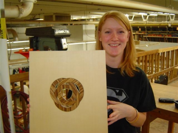

The triple knot rosette is a really fun design to execute, and perhaps one of my more "flashy" rosettes. I happened upon it because I have a gold ring that has three types of gold comprising the interlocking rings- white gold, red gold, and yellow gold. I saw the ring resting on my bureau and I thought, there is my rosette. Three rings for my third guitar. Also I am one of three brothers. It was all about the number three for some reason. Somebody later pointed out to me that another guitar maker has used this design. I was somewhat disappointed by this later discovery.
I have also duplicated this 3-ring rosette using three different pre-made Russian rosettes in different patterns but with similar colorways. I'll try to get a photo and post it later. I do NOT recommend using three different pre-made rings as each ring is slightly different in size, and so the spacing has to be augmented slightly to acommodate. The problem is when you come to cut the holes out for the sound hole... if you use a circle cutter base on a dremel... the margin of soundhole that remains is a variable distance because of the different ring sizes and spacings. You have to hand file to achieve symetry in the design. It's challenging to say the least.
I've used zebrawood for this same 3-ring rosette when helping a friend execute it, but skewed the graphic zebrawood grain on each ring so as to radiate from a central point. That made a stunning rosette. It had black purflings on the edges to anchor it to the top visually. I will be executing something quite similar this fall with Brazilian bloodwood, and Brazilian tulipwood. Here is a pic of the zebrawood rosette on my friend Bessie's guitar.Image

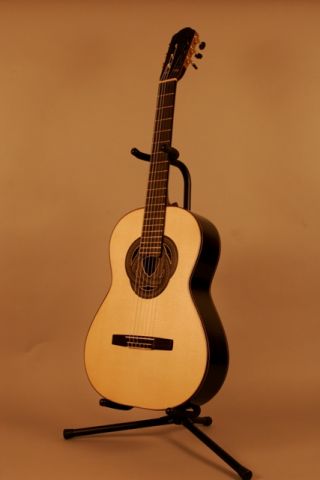

As a teaser until I can get better photos... my flamenco guitars are the upright cypress, the upright rosewood, and theclassical tiger myrtle all seen on the far right of the photo.Image
