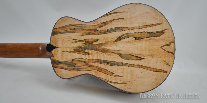

Post by Allen » Thu Mar 12, 2015 1:47 pm

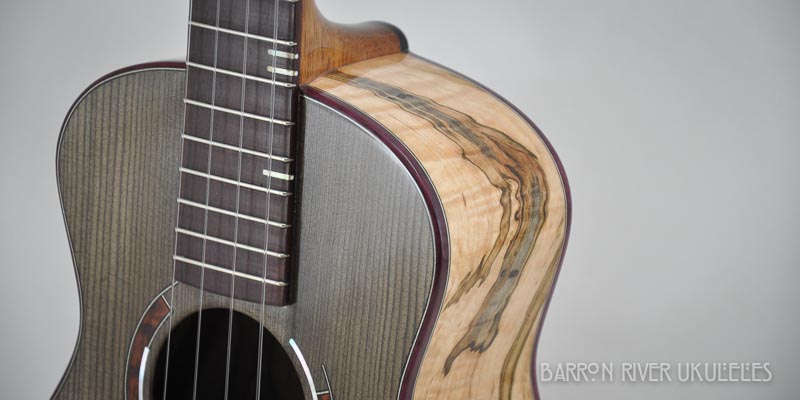

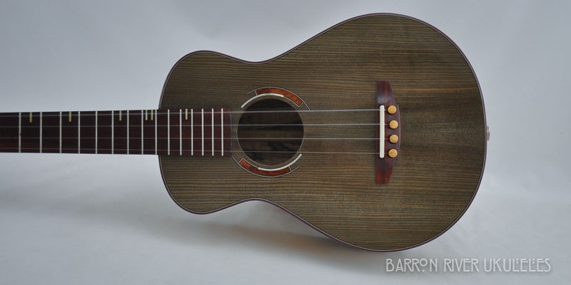

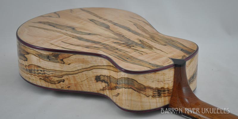

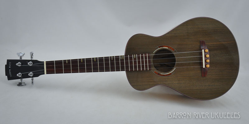

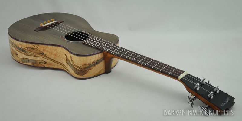

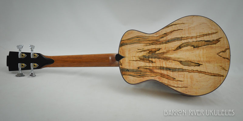

This one made from an orphan back set of the prettiest Ambrosia Maple I've ever seen. Just perfect to make a tenor from. Paired up with an Ancient Spruce soundboard. Ebony and Honduran Rosewood trim. Hipshot tuners and K&K Aloha twin pickup. And yes, it's a lefty.

How are you doing the inevitable "pore" filling? Epoxy?
Re: Ambrosia Maple and Ancient Spruce Tenor
Post by Allen » Tue Mar 24, 2015 6:40 am
I tapped over the holes on one side prior to bending sides and after the back was joined. Then sanded careful over each hole so that a bit of dust from the surrounding area of the same color got into the hole. Then drop filled with thin CA glue. Repeat until level. Then flipped the parts over, removed the tape and did the same from that side.
Afterwards it was just the usually epoxy pore fill, to really even things out.
