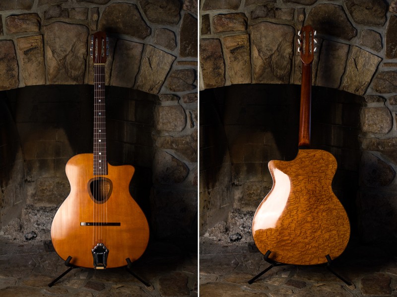

I don't put up much of my work here, but I've learned so much from reading this forum, I thought in appreciation I might post this, my new model Corasón, a replica of the elder Joseph DiMauro's manouche guitar with a heart shaped sound hole from the 1940s. More pictures and details here: https://craigbumgarner.wordpress.com/

Yes, it's certainly a beautiful looking instrument Craig. I love the aesthetic of the Selmers, but this is a considerable step beyond, without losing the gypsy jazz identity. I suspect Django would have loved it. It only remains for you to let us know what it sounds like.

Beautiful work Craig, you've really done that birdseye justice and I'm just LOVING the colours you've managed to get. Looks so authentically old yet modern. :cl :cl :cl :cl

looks really great.. which finish did you use? how did you build that colour into the top?

Thanks! The finish is French polish with Royal Lac shellac. Epoxy filled the back and sides first. Maple is a closed grain wood, but the birdseye maple has lots of small grain pulls which would have made pumice filling tedious. Sealed the top with regular shellac, then mixed aniline dyes with Royal Lac and sprayed it to get the color. Locked this down with a couple sprayed coats of blond Royal Lac. Did the same with back and sides, but with a slightly different mix of dyes.
Tried spraying the dyes mixed in regular shellac, but it was drying too fast in the air before it hit the surface. Royal Lac dries slower and seemed to build up better. It still dries instantly and it is possible to spray dozens of very thin coats in one session with no chance of running.
Let it set up for a couple days, then lightly sanded and finished with blond Royal Lac in the usual French polish method. Had to be very careful until enough coats of blond are built up, very easy to rub or sand down through the VERY thin stain level, but the result is a more transparent staining.
Next time, I might consider a layer of varnish or lacquer over the stain layer to reduce the chance of breaking through later on. Still finish out with French polish.
