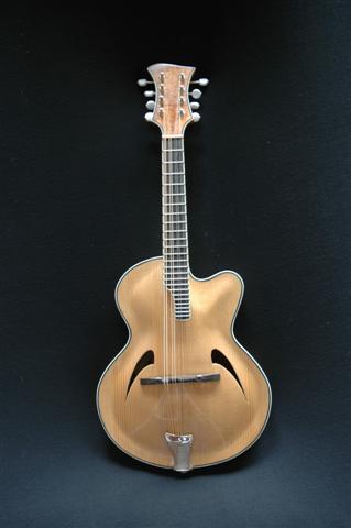

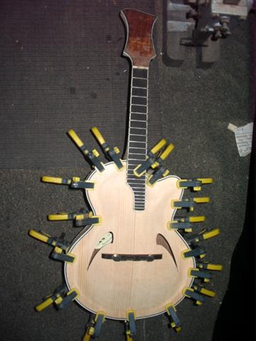

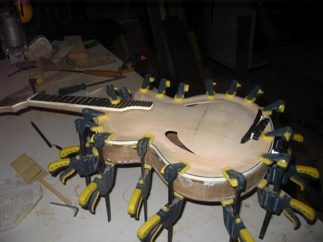

Post by Bob Connor » Fri Jun 13, 2008 5:46 pm
Well it's almost finished.
Got the back glued on today so there's only the back bindings to do, install the machine heads, some finish and we're done.
It's been a very interesting process throwing up a lot of problems and questions that you simply don't come across building flat top guitars.
If it doesn't fall apart when we string it up it's heading to Ireland and then Europe for a couple of months. :D

Great looking instrument Bob, what are your finishing plans?
Post by Bob Connor » Fri Jun 13, 2008 6:41 pm
Mirotone pre-cat laquer on this one Sebastiaan.
We've just about finished the tin that we have and then we're going to try some of the Mirotone polyurethane. Apparently it's tougher, hardens quicker and it sands to a fine dust.

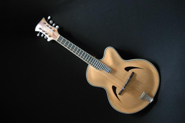

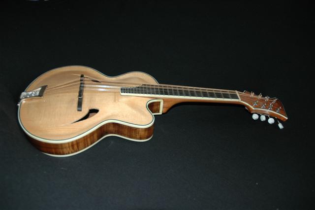

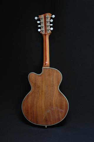

Post by Bob Connor » Fri Jun 20, 2008 2:37 pm
Well it's finished and has been delivered to it's new owner.
Tony was well pleased with it from first impressions but he's got 3 gigs on this weekend to put it through it's paces so I guess I'll get a full report early in the week.
Thanks for looking.
