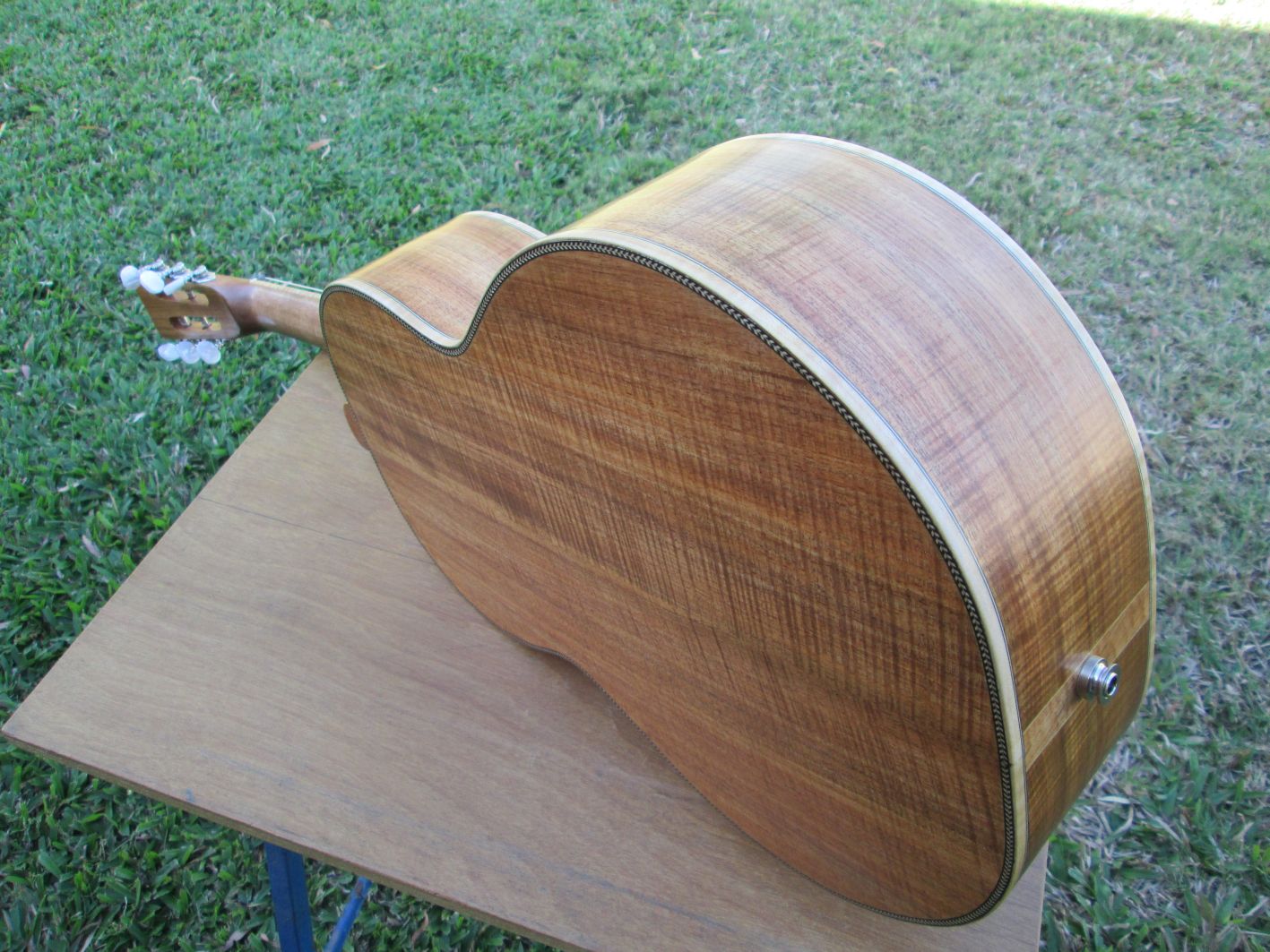

Hi there,
This guitar has been on the bench for sometime. Like over two years. It has caused me some grief through out the build but I am very happy the way it turned out. It is a copy of an old Stella concert size guitar that is 13 1/2" lower bout. John How in the USA builds guitars similar to this one I have come up with. Some years back he posted a thread on the OLF, he described the build included an outlined template with a few of the necessary specs to build a copy of a Stella acoustic and I was lucky enough to download a copy. The most famous was the small bodied Stella twelve string guitar. Anyway, I liked the challenge so I started working on the build.

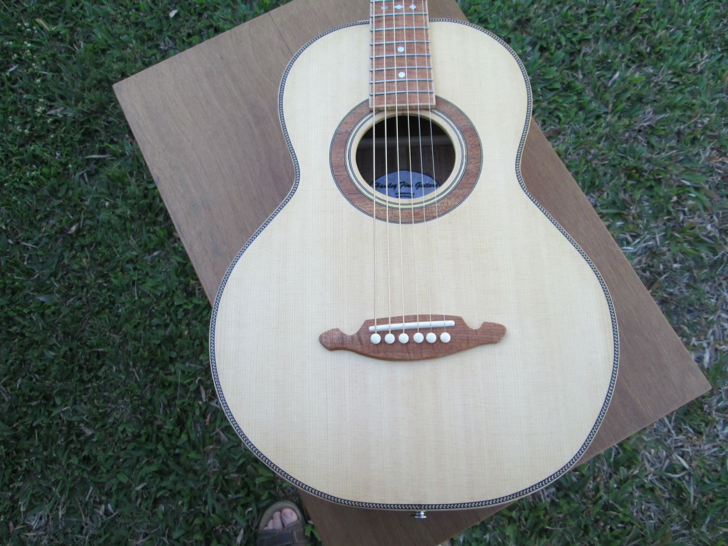

The first issue was I had two builds on the go at the same time which can be dangerous as what turned out. The dreadnought got the correct size sound hole and Stella as I call her also received the same size sound hole. It took me a few days to get over the mistake but I got out of it by making a doughnut shaped patch and fitted it under the sound hole inside the box and left a ledge the correct sound hole size. I then matched some sitka spruce and inlayed it into the sound hole opeing gluing it to the ledge. I then made up a small jig and routed a channel with the dremel and inlayed some black white black purfling. Phew, issue resolved.

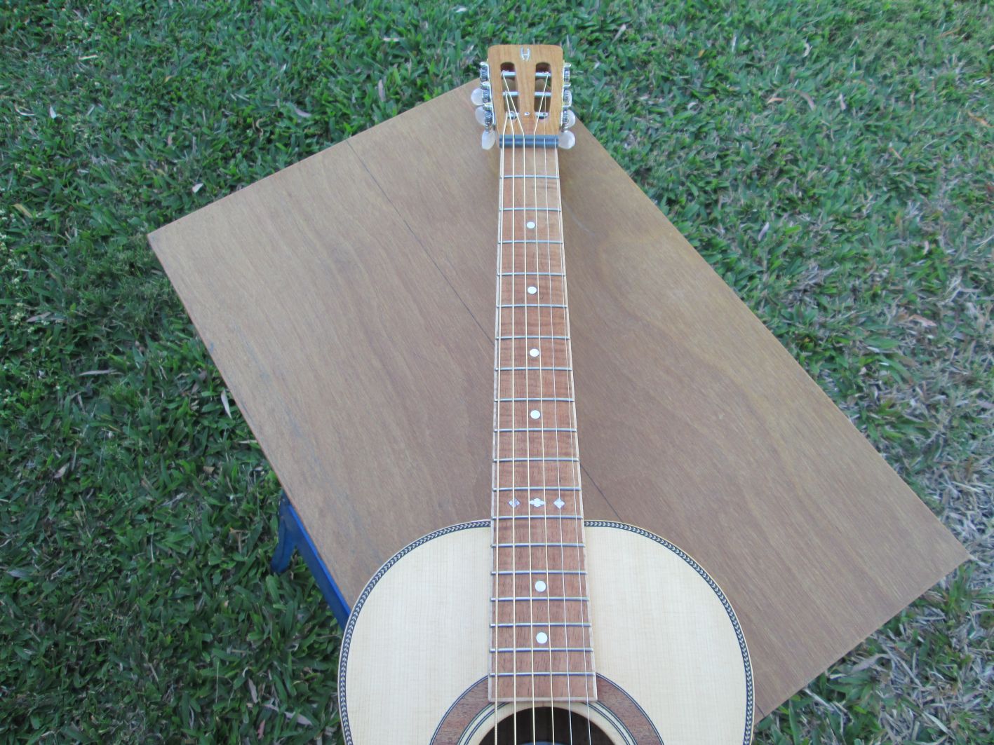

So the build was going along nicely and I was working on shaping the neck profile under the neck at the first fret area and tried to wing it as I was in hurry to go out for lunch and of coarse put the rasp into the truss rod. Not a good feeling. Lunch tasted bad and it took me a few more days to get over that mistake. I then decided to teach myself a lesson not to profile necks without a template so I set to and removed the beautiful figured fingerboard from the stuffed neck. Well that took me the weekend and I certainly had plenty of time to think how big an fool I was. So I made a complete new neck and glued the lovely fingerboard on again.

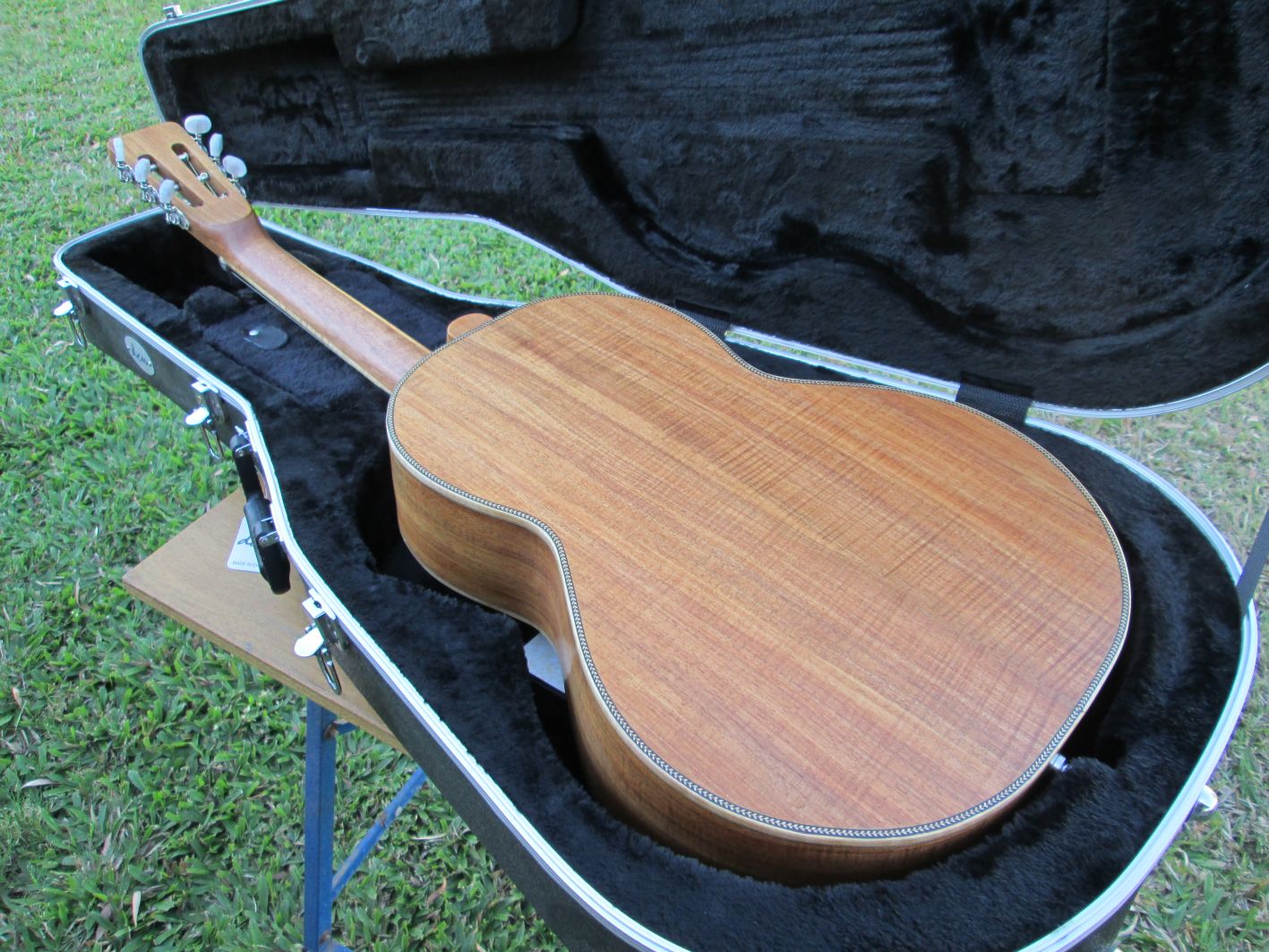

Every thing was going along nicely and I noticed a flaw in the Blackwood that I thought would sand out. Wrong again and after sanding away fro some time gave up and left it as character before I sanded a hole through the guitar back.
Last mistake was I broke the binding on the last pass near the lower bout on the top and had to join in a piece and trying to get an invisible join on figured maple is not easy so so if you look closely it stares at you! Shit happens.

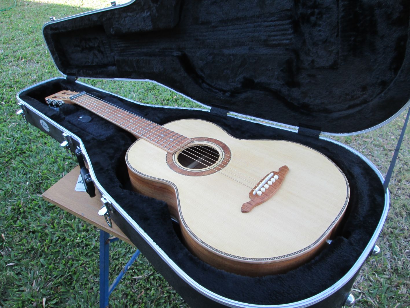

So I got to stringing her up two weeks ago and started with some 12 to 53 light medium strings as it is a 25" scale and I had left the neck very chunky. It has good volume but was very bright. I set it up and a few mates played it and some liked the brightness and some didn't. She played well though even with a very fat neck that I think added to the sustain of the instrument.
So I like open tuning's and thought how will she perform in a lower tuning. I tried DADGAD and all of a sudden she come to life. Loving slide guitar my next thought was try some medium gauge strings and set her up for slide in open D DADF#AD. So Stella is now a slider, has a new owner and she sounds bloody great!

Looks really good Alan. How did you go about fixing the hole in the back?

Thanks Col.
Sorry mate, I exaggerated about the hole is was a a flaw in the timber about the size of your thumb nail. I thought when I first noticed it early in the build I would be able to sand it out but not the case. You have to look hard to see it but there is also a slight dip in the same spot where I tried to sand it out.

Looks great Alan. Obviously you committed some mistakes sou thoroughly that you will never ever make these again. Oh, and it would have been a shame if you had ended up sanding through this amazing back, I'm glad you stopped before this happened!
