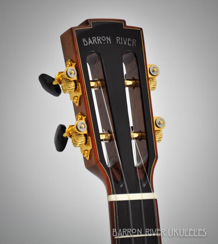

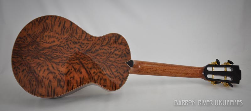

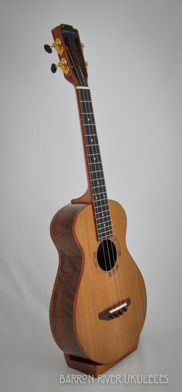

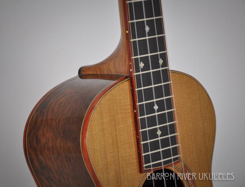

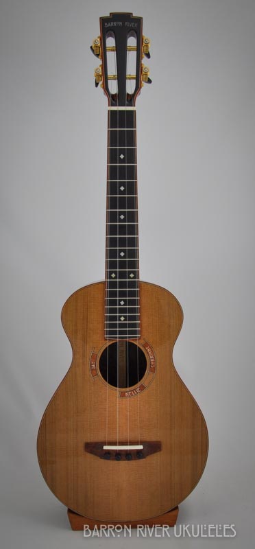

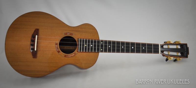

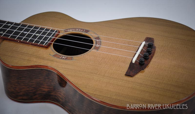

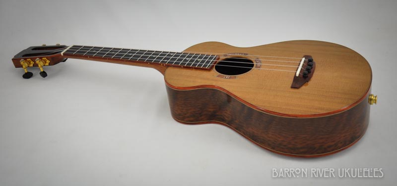

This one fresh off the workbench and leaving for San Francisco shortly.
The client had some ideas about building a very customised instrument and there was a lot of back and forth about wood choices, where to inlay names etc. In the end everything was settled so that we were both happy with the plan and I was given a bit of free reign on the trim. First time binding my new head stock shape, and it was most definitely a challenge with all those mitres. When it came time for the bridge, I was struggling with an appropriate wood. Didn't want to go with ebony as it was a bit too much black, and then what to do about the pins. Tiger Myrtle is crap for a bridge, but then remembered that I had a big box of goodies I got from dumpster diving at HNT Gordon's premises the last time I was down in NSW. And low and behold a piece of Snakewood that is the perfect compliment to Tiger Myrtle and ebony.
Back and Sides - Tiger Myrtle
Top - Western Red Cedar
Bindings - Cocobolo
Fret Board - Ebony with 12" Radius
Peg Head overlays - Ebony
Neck - Spanish Cedar with CF truss rod
Rosette - Koa
Bridge - Snakewood
Pickup - MISI
Tuners - Gotoh
Strings - South Coast Ukes
Finish - MIrotone

Always a pleasure to look at your ukes when they appear on the forum. I'm really digging the way you are inlaying "Barron River" into the headstock. It is nice to see such organic lines of text on an instrument rather than very sharp edges or crisp lines.

Love them all Allen but this one's my favourite and the new shape slotted headstock is superb.

Gorgeous! Love that heel cap detail.

Missed this one! :oops: Great Job Allen, you just keep stepping it up with each and every build. Love the headstock detail. :cl :cl :cl :cl

Absolutely beautiful Allen. What a gorgeous set of tiger myrtle.
