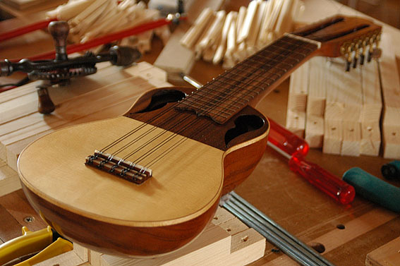

You can find the thread about my struggles with building this non-standard charango here.
Below the pictures (overdue since mid-2012) of the finished charango.
Materials:
Body: Mahogany
Neck: Mahogany with a centre strip of (if I remember well) "Quina", no idea if this is Myrocarpus frondosus or Hyeronima alchorneoides or maybe even something else!
Soundboard: Swiss spruce
Binding: Pear and maple
Fretboard, bridge, headplate and upper bout soundboard: some "rosewoods"
Tuning machines: Rubner (custom made base plate, price of custom machines go per number of tuners (strings) and materials used)
Varnish: Shellac ("french polish")
Image Image
Image Image
Image Image
Thanks for looking.

I'm liking this, the whole look is sweet, the headstock is huge compared to the rest of the instrument yet it just looks right and the contrasting top sits well too. How do you hollow it out and shape the back, any fancy Marcus/Swiss techniques or is it just plane and gouge and plenty of sweat?
Re: Charango
Post by charangohabsburg » Thu Apr 04, 2013 10:07 am
Thanks for your kind words Nick.
There were no special Swiss techniques involved, and not too much sweat either, at least not with such an easy to carve wood I have worked with here.
Shaping the outside gets done with a chisel and then with spokeshaves (with rounded sole for the waist). Many charango builders use rasps and files for this task, which is slower and dirtier than using spokeshaves. In the end stage I used cabinet scrapers for the waist.
The hollowing out takes several steps. The bulk gets removed by drilling holes with a drill press followed by removing the wood between the holes with a chisel (hammering) and cleaning up the inner surface with a gouge. One can also use an angle grinder with a toothed wheel like the ones from Arbortech (or something similar) but it doesn't speed up the process much, if at all. Then the body goes again to the drill press, this time with a pin beneath the drill bit, with a spacing set at about 3 mm more than the desired maximum wall thickness. The rest (final wall thicknessing) gets done with a set of differently shaped gouges.

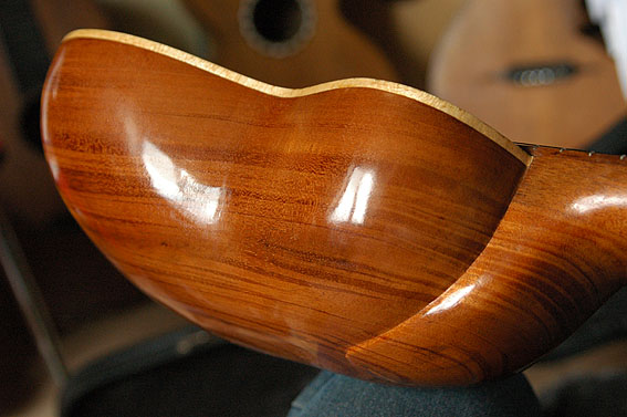

Markus I like how the grain in the heel matches the body, have i got this right? How the bloody hell did you make/match that up, it looks like it was fairly difficult.
Re: Charango
Post by Kamusur » Thu Apr 04, 2013 6:45 pm
Just checked the photo again and reread posts so its the one piece, which makes it easy to match lol but a pain to carve?
Re: Charango
Post by charangohabsburg » Fri Apr 05, 2013 12:07 am
Thanks again for your comments.
Wayne, the back of this charango is 6mm thick, except at the left and right side of the heel, where it is 8mm. However, charangos made of denser wood than mahogany tend to have a thinner back. I have measured charangos with backs as thin as 1.5 to 2 mm in the area of the lower bout, but in the upper bout area these backs were about 3 to 4 mm, and close to the heel up to 6 mm thick.
Indeed Steve, matching the heel and the body was fairly easy! :) Carving the whole thing, also the heel area, is not much more difficult than peeling a raw potato, even carving a neck is more demanding.
