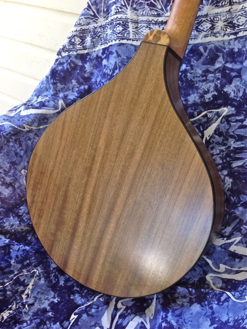

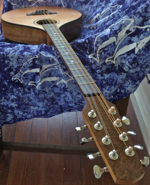

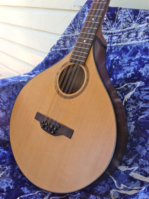

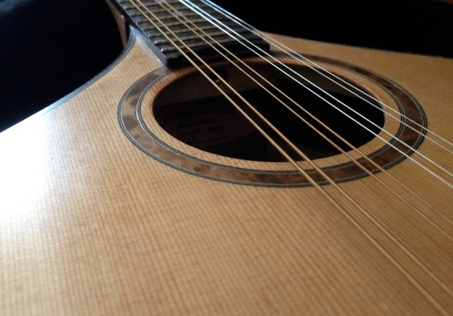

This is my first attempt at a Bouzouki. Made for a friend who's keen to incorporate a little Bouzouki playing at his local Irish Session.
Scale Length - 25.5"
Fret Board - 12" radius
Back and Sides - Queensland Walnut
Bindings - Ebony
Neck - Queensland Maple
Bridge & Fretboard - Gidgee
Soundboard - King Billy Pine
Head Stock veneer, heel cap and rosette - York Gum Burl
Finish - NC Satin
I know expert at playing bouzouki but it sounds sweet, has a nice action and the intonation's good. I'll let you know what my mate thinks if it survives its journey with Aust Post :?

Mark I pretty much tackled it like I do my guitars. My main concern was the potential for excessive relief in the neck seeing as the the neck join is at the 17th fret. I decided to put some carbon fibre in to stiffen it up and it seems to have worked. But maybe the truss rod would have been enough?
Plans? It's basically an adaptation of Graham McDonald's plans from his "Bouzouki Book" (thanks Graham :))

What is that you have done at the end of the fretboard near the soundhole ? (sorry mate but my eye's :( )
