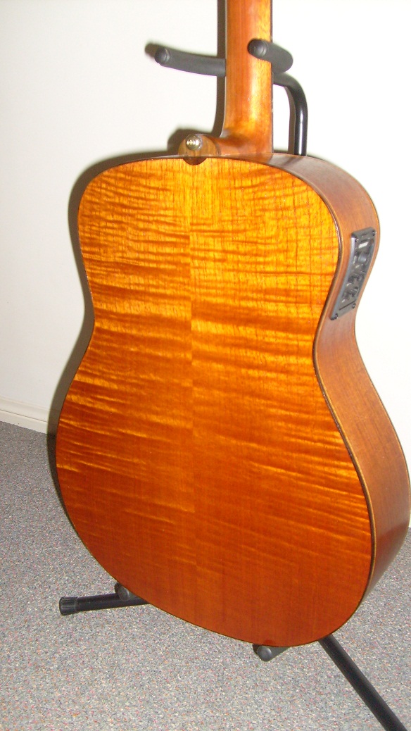

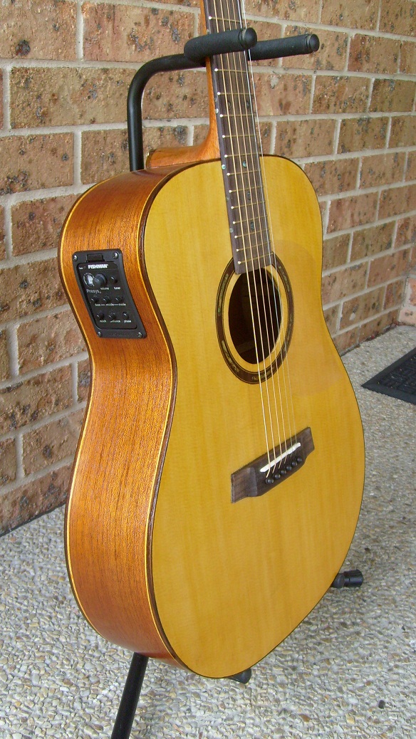

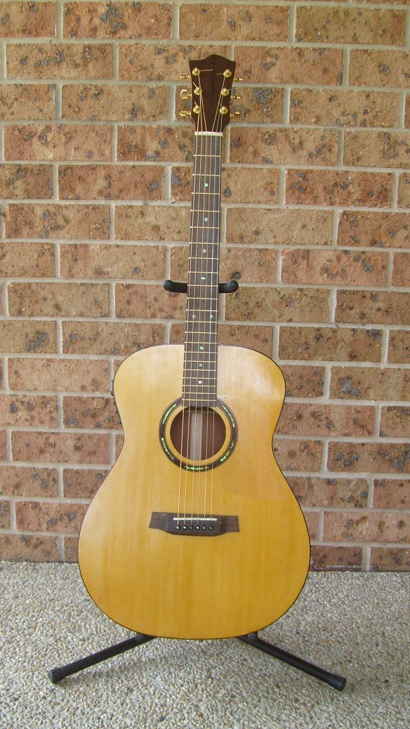

I hadn’t intended to post this one, but it could be of interest to someone building from Trevors Books.
This Guitar was meant to be a replacement for what I call my workhorse guitar, the requirements were, to be able to be gigged through a PA and or played acoustically at a Jam and hold its own, I also wanted it to be unadorned and plain to a certain extent and just let its tone and playability do the talking, it had to be very playable and sturdy enough to handle being carted all over the place.
Thanks To Trevor and Gerard and their books, it has fulfilled those requirements perfectly.
Also Thanks To John The WoodRat for his advice and that fantastic example of Oz Red Cedar on the back :)
Soundboard: Lutz Spruce finished thickness 2.8mm
Back and sides: Australian Red Cedar
Neck: african mahogany, plantation grown in QLD
Bridge and bound fingerboard, back and front head plate: ei rosewood
Binding and tail graft: ei Rosewood
French polished finish
Machines: Gold Gotoh SG360-0
Electronics: Fishman Presys plus UST

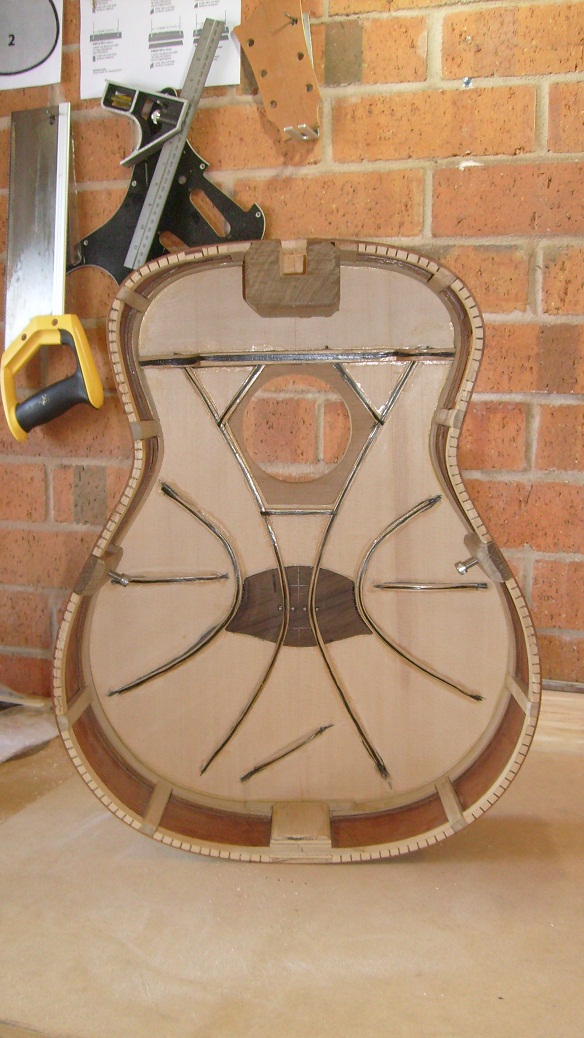

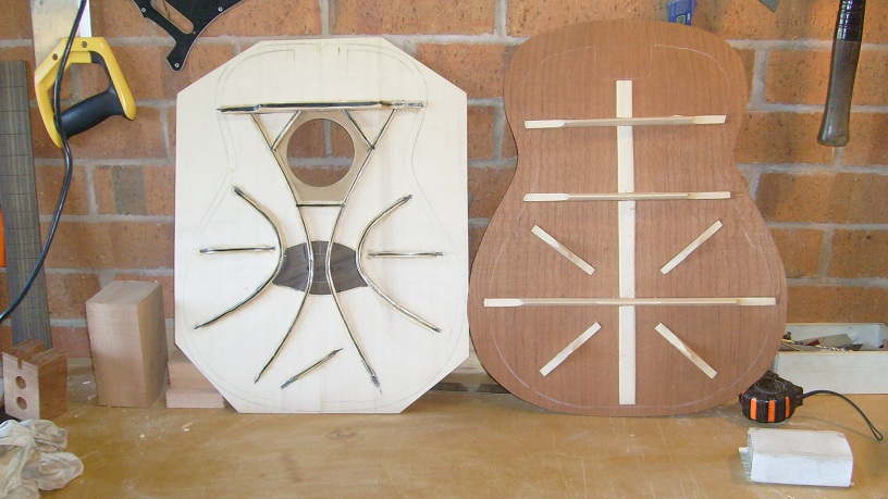

Falcate Braced (Sitka Spruce) 8mm

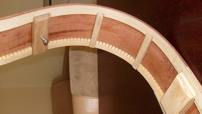

Live back and mass side blocks (No Added Side Mass)
Bridge Rotation 1.91 degrees (5mm variation)
T (1, 1)1 90 T (1, 1)2 160 T (1, 1)3 211

Well Done Tod....Tod brought it down here on Monday and it sounds really lovely....Kudos too for taking on the Falcate bracing and succeeding!
...When I saw it I had a touch of sellers regret as he got the cedar from me...you rarely see figure like that in cedar.
