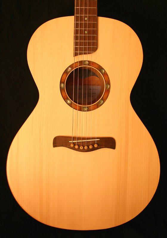

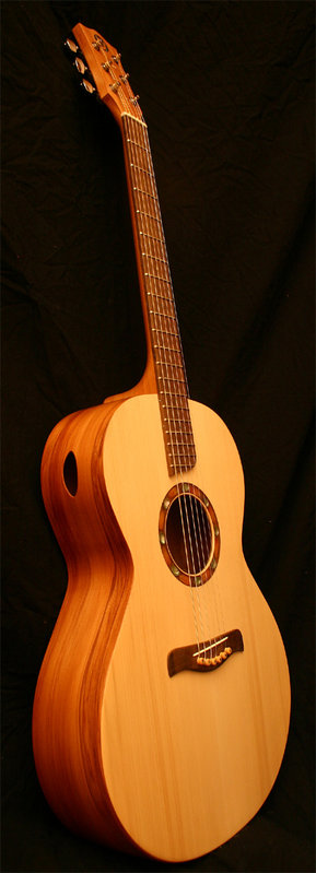

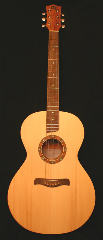

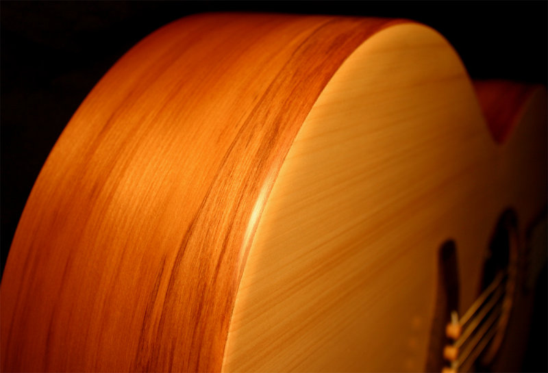

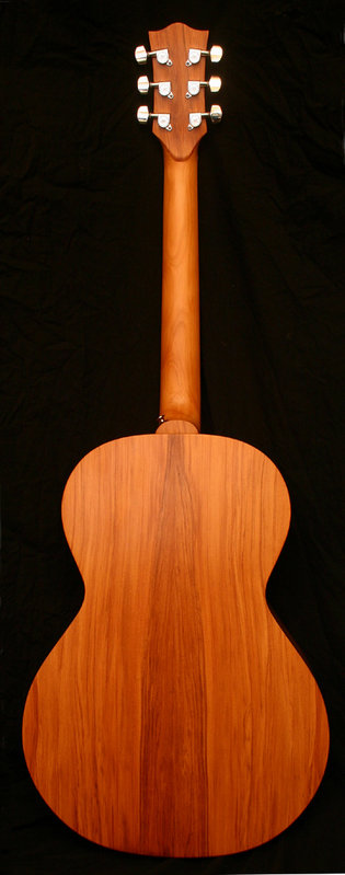

Finished "Roreka" (Sweet Singing) on Saturday, been quite an experimental build but I'm thrilled how it looks and sounds,
I've used a couple of NZ natives which I havn't used before, a new hybrid double X bracing an armrest
and a rosette made from Kauri leaves and baby paua shells.
Features.
Top: Kahikatea

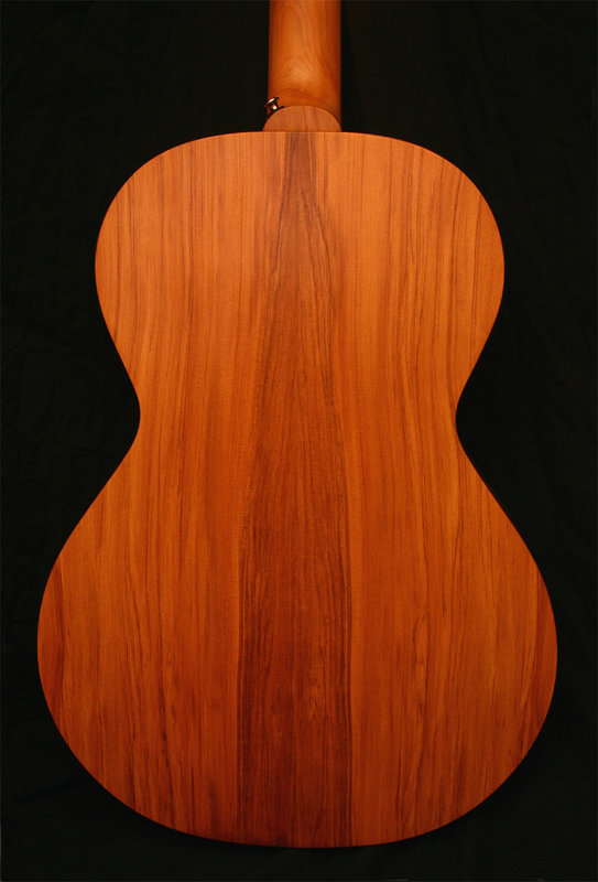

Back: Heart Rimu
Sides: Heart Rimu
Neck: Matai
Fretboard: Puriri
Bridge: Puriri
Headplate: Heart Rimu
Rosette: Baby Paua shells & Kauri leaves
Soundport: Kauri leaf silhouette

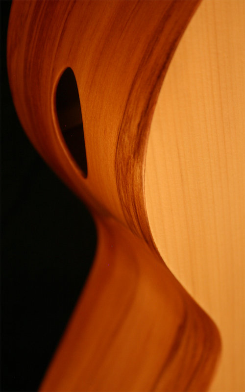

Rounded arm rest
Mitred Body
Bracing: Hybrid Double X Bracing

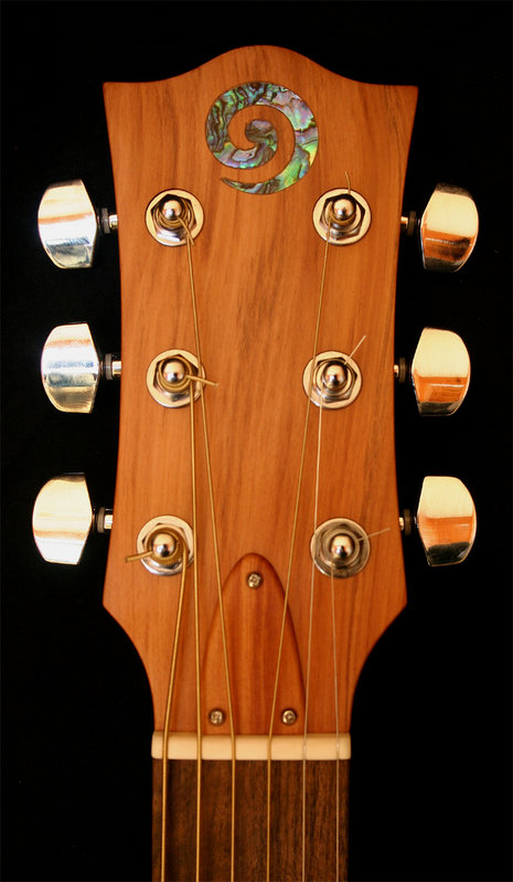

Bridge pins End: Boxwood with Paua dot
Position markers: 2 & 5mm: Paua dot
Christian.

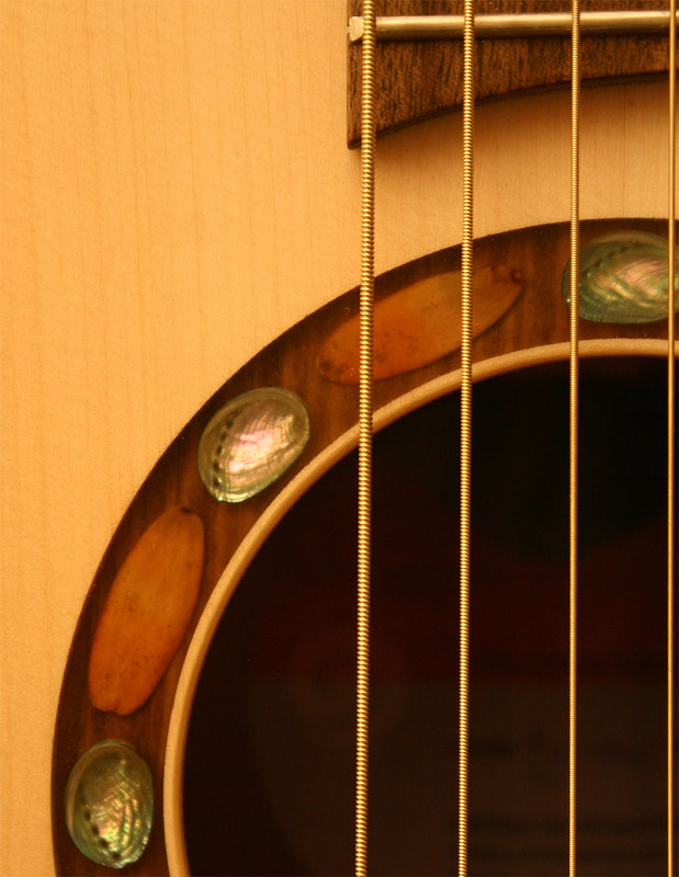

Congratulations on a beautifully crafted guitar. Could you please give us
an idea of body size/scale length and how you made the rosette?

The way you manage to get the top and back fit with mitres just amazes me Christian. Very sweet indeed. I really love that rosette. But what are the odds that one would get by the blokes enforcing the Lacey Act?

Beautiful instrument as always Christian, beautifully crafted. I just love Rimu, it's such a beautifully warm looking timber & has some really stunning grain features. I've never actually considered using it as a tonewood
more for fine furniture
. I'll have to look at it differently from now on. Also the three dimensional rosette is a stunner.

The rosette is relatively simple,
-mark the centre of your soundhole
-glue a contrasting timber to the underside of the top in a pentagon shape as a soundhole patch.
-set up a router/dremel with a sharp wide bit( I used 12mm) and however you normally cut out circles
-set and cut to a depth of 5mm which will cut through the top an about 1.5 mm into you patch
-should end up with a nice clean channel, seal the channel well and organise whatever you wish to embed
-line the outside edge of the rosette with bluetack to act as a wall
-mix up some epoxy resin pour into the channel typically takes 8hrs to cure
-remove the bluetack and sand flush.
Allen, I will will be testing the bloke and the lacey act with a guitar like this in Dec
I will definetely come prepared.
The mitred body is one of those tricky things to explain but easier to show
with pics, so i'll piece a complete tutorial together for you someday.

That rosette is absolutely amazing, as is the technique you describe to make it!
And it is a very nice guitar anyway. Great choice of materials, everything seems to be harvested just in your back yard, right?

Thanks Markus for the generous praise.
backyard....hahaha well yes pretty much, the baby paua shells come from a friend whos family owns a paua farm and the little guys I used are ones that didn't make it, the kauri leaves I literally picked up on a walk around the amazing Trounson Kauri park , Its a great way to build utilising whats around you, giving new life to the seemingly dead, paying homage to nature and the source of our instrument materials.
Christian.
