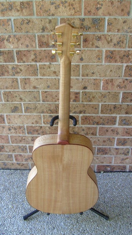

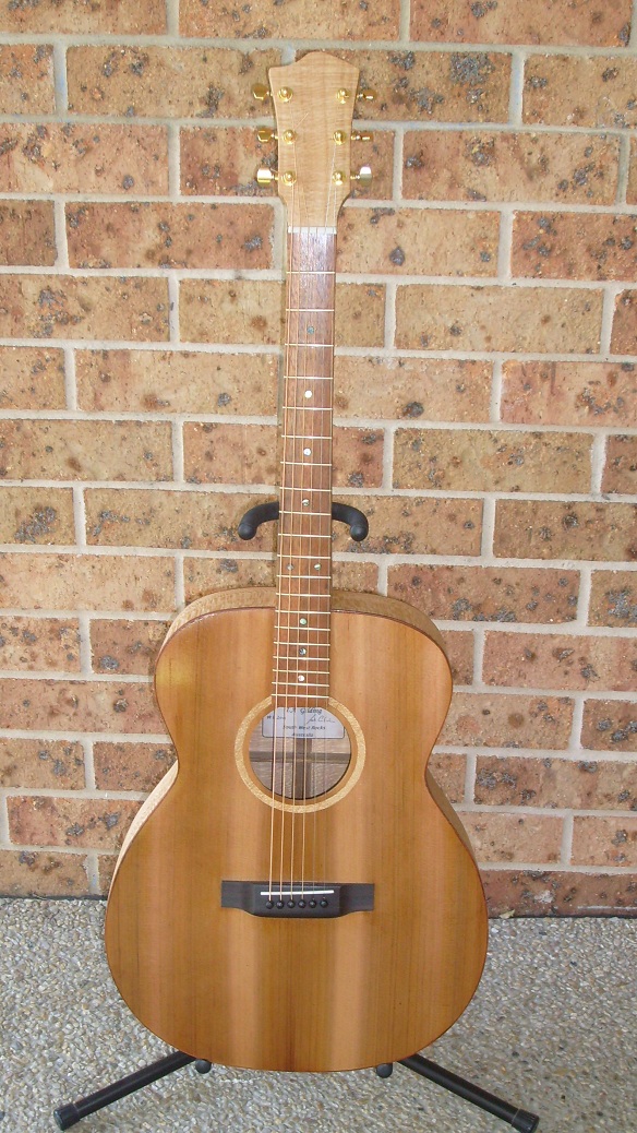

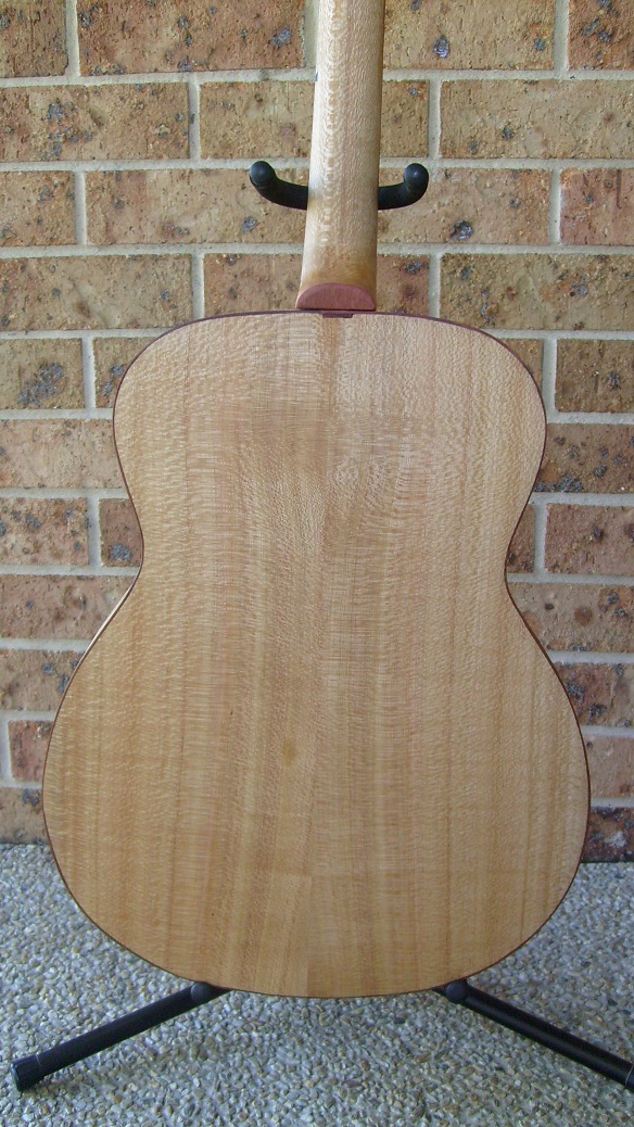

Hi All,
I have finally finished my #1 Acoustic,Thanks to everyone on this forum that offered advice and direction,especially John The Woodrat.
This guitar plays very well has an exceptional tone, warm lows with sweet highs,very even response,I couldnt ask for more,it looks like my Cole Clark will be spending a lot of time in it's case from now on,specs are as follows:
Silky Oak (Grevillea Robusta ) OM 14 fret to body
Neck Joint: Mortise & Tenon Bolt on
Top: Western Red Cedar
Back & Sides: Silky Oak (Grevillea Robusta )
Bracing : Australian Red Cedar
Bridge: EI Rosewood
Rosette: 10mm solid band of Silky oak
Binding: Australian Red Mahogany
Neck: Silky Oak Reinforced with 5mm Carbon Fibre rod following the neck taper either side of the truss rod.
Head plate: Silky Oak
Fingerboard: Cooba ( Acacia Salicina)
Frets: 21 Medium Evo Gold . copper, tin, iron and titanium (chemical composition CuSn15Fe1Ti0.1)
Machine Heads: Gold Gotoh SG360-07 1:16 Gear ratio
Nut : 45mm wide Graphtech
Scale Length: 648mm 25.5”
Saddle: Bone
Finish: Soundboard Tru oil,everything else is Howards Orange Tung Oil.
Thanks For Looking, I'm off to start #2
Cheers Tod

It looks beautiful, elegant and flawless, much better than my first was. Well done.
Re: #1 Acoustic Finished
What a great looking guitar!

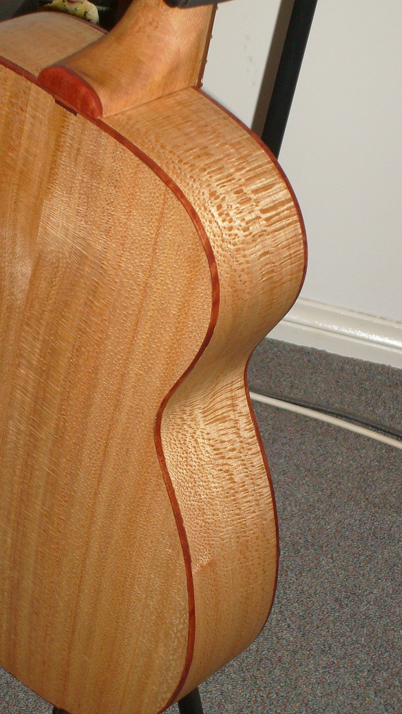

I like the binding colour which makes a nice "picture frame" for the silky oak.
And I also like the stripes of the top, it looks really good.

Thanks for the kind replies,It's not really flawless though Inoz,there are a couple of workmanship issues that i will need to address with #2,but overall there is no problems that would affect tone or playability, It's really a credit to the members on the ANZLF without the advice and direction it wouldn't have happened, and especially thankyou to Bob for hosting such a valuable resource.
Mark, #2 and 3 are already on the bench #2 is Australian blackwood B&S bunya top aust red cedar neck, #3 is Sassafras B&S Bunya top.
