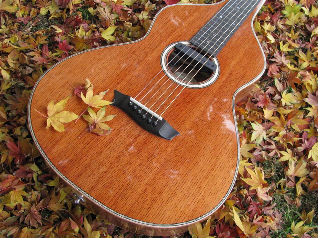

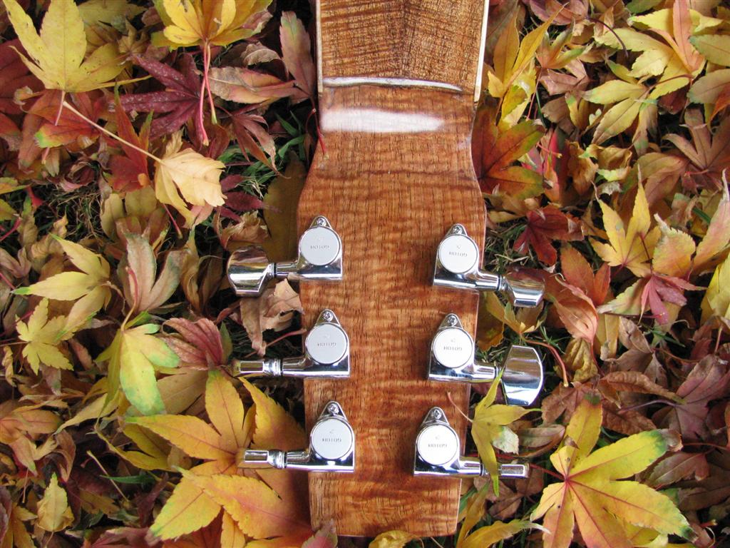

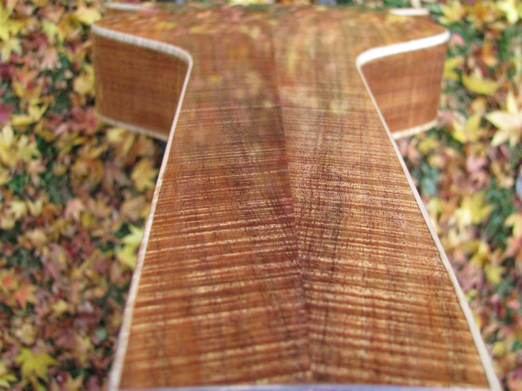

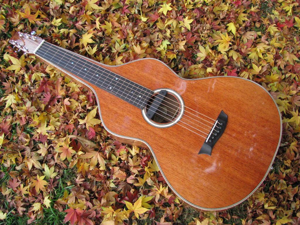

Well this ones finally finished and ready to be delivered to it's new owner in Sydney.
Vital Statistics are:
Back and sides - Victorian Blackwood
Top - Surian Cedar
Fingerboard and bridge - Ebony
Bindings and rosette - Blackwood
Pickup - Fishman single coil
It's very loud, louder than any of my others in fact, sustains forever and no I can't put any sound clips up because it's a lefty. :D. Overall I'm very happy with it.

That Surian is beautiful. I really love the way it compliments the Blackwood. Good to see that it's found a new home. Always gratifying when that happens.

Great looking guitar which lets (visually) speak the wood and the guitar shape for themselves. Even the fish tail shaped bridge wings and the pickup brand name go together! :)

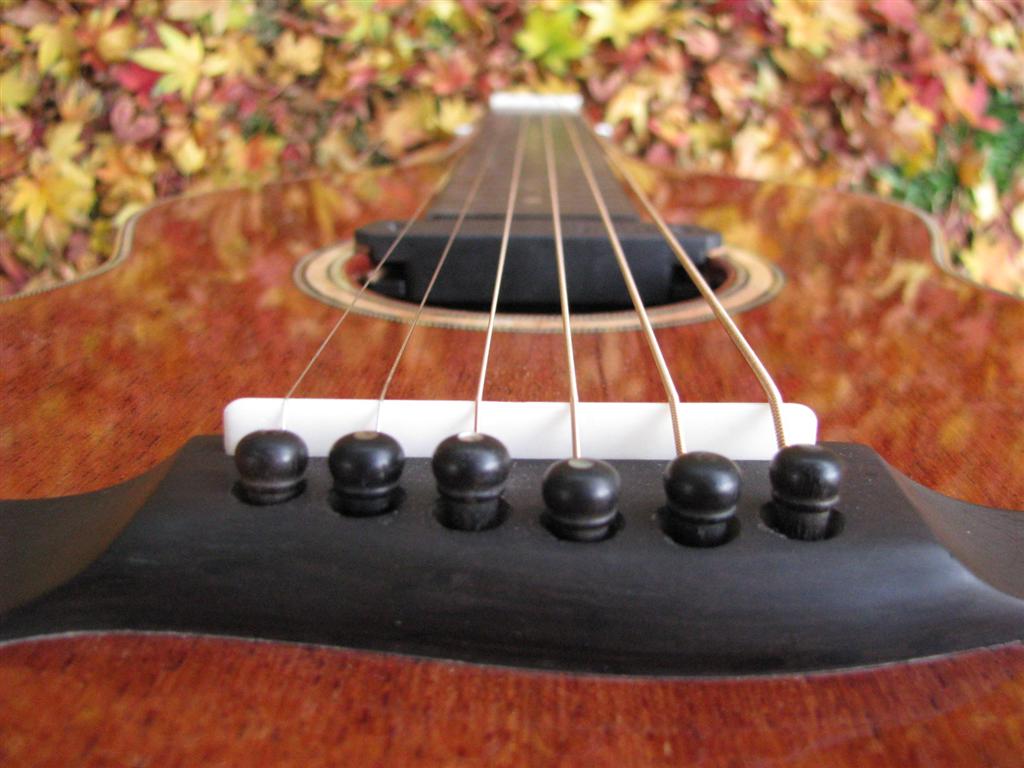

Ahhhhh My lovely Blackwood fix for the day. Looks great Bob & it's the first time I've seen Surian & I must say it looks like an interesting timber with it's 'intermittent' grain lines. The brown purfling lines to...homemade?
Also I'm interested in your thinking in the staggered bridge pin heights, is this just for looks or has it some string geometry thinking behind it? Looks good whichever it is!

Nick - the bridge pin heights will be one of the final adjustments before the guitar gets delivered. Nothing intentional going on here other than it's a set of John Pearse Weissenborn strings for D tuning with a low E of ".060. So they're bloody thick. I actually don't like the sound of the low E so I'll be replacing the set and will do the final bridge pin fitting then.
I've been using Martin SP's (.056 low E) and replacing the unwound strings with an .018 and a .015.

As always top notch craftsmanship and a nice bit of back drop to the pics Bob. The way those bridge pins rise in that 1,2,3, 1,2,3 pattern was surprising and interesting.

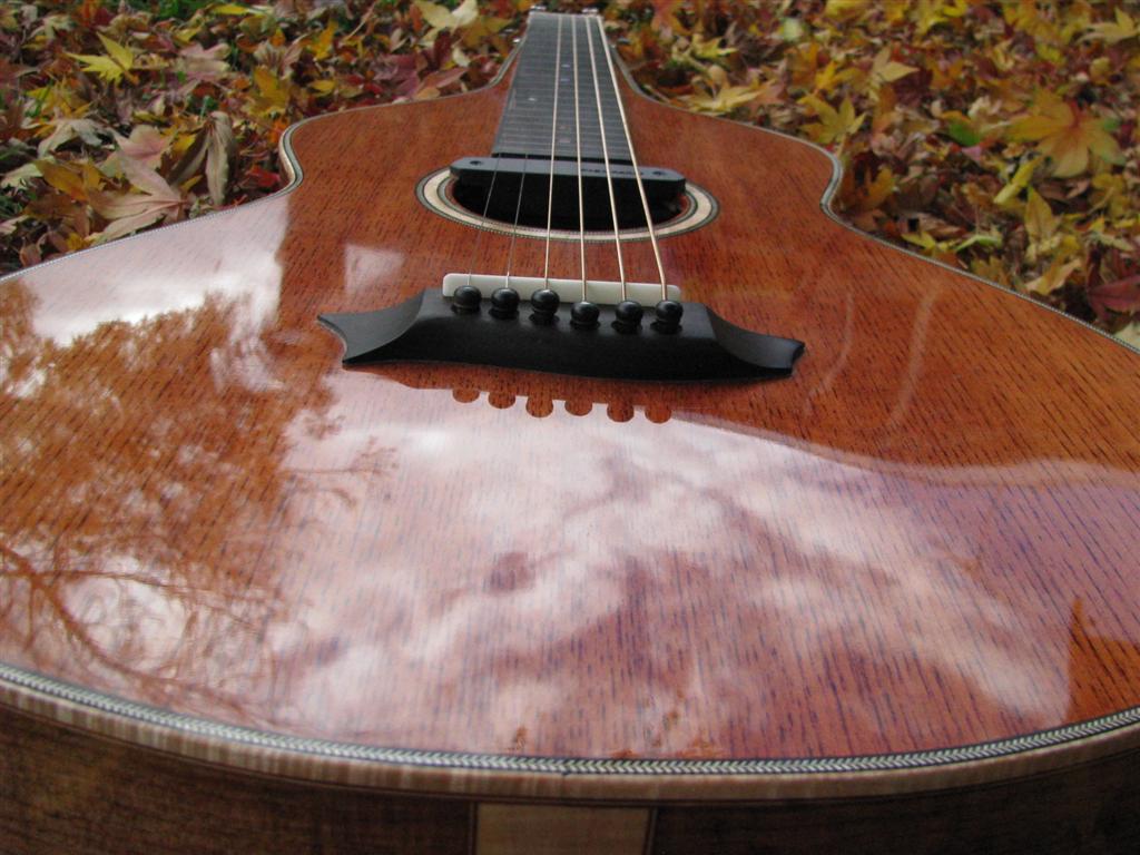

Bob, what did you pore fill the surian with?
Re: Blackwood/Surian Weissenborn Style Lap Slide
Post by Bob Connor » Wed Jun 01, 2011 4:01 pm
Pores were done with Z-poxy Liam.
3 coats sanded with 240 grit Abralon between coats
