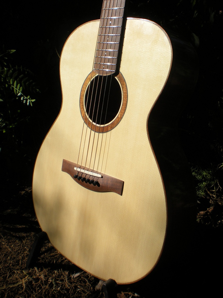

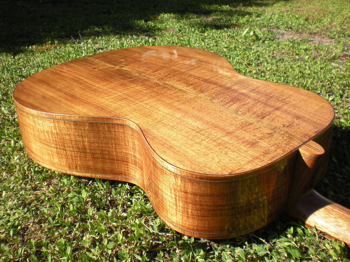

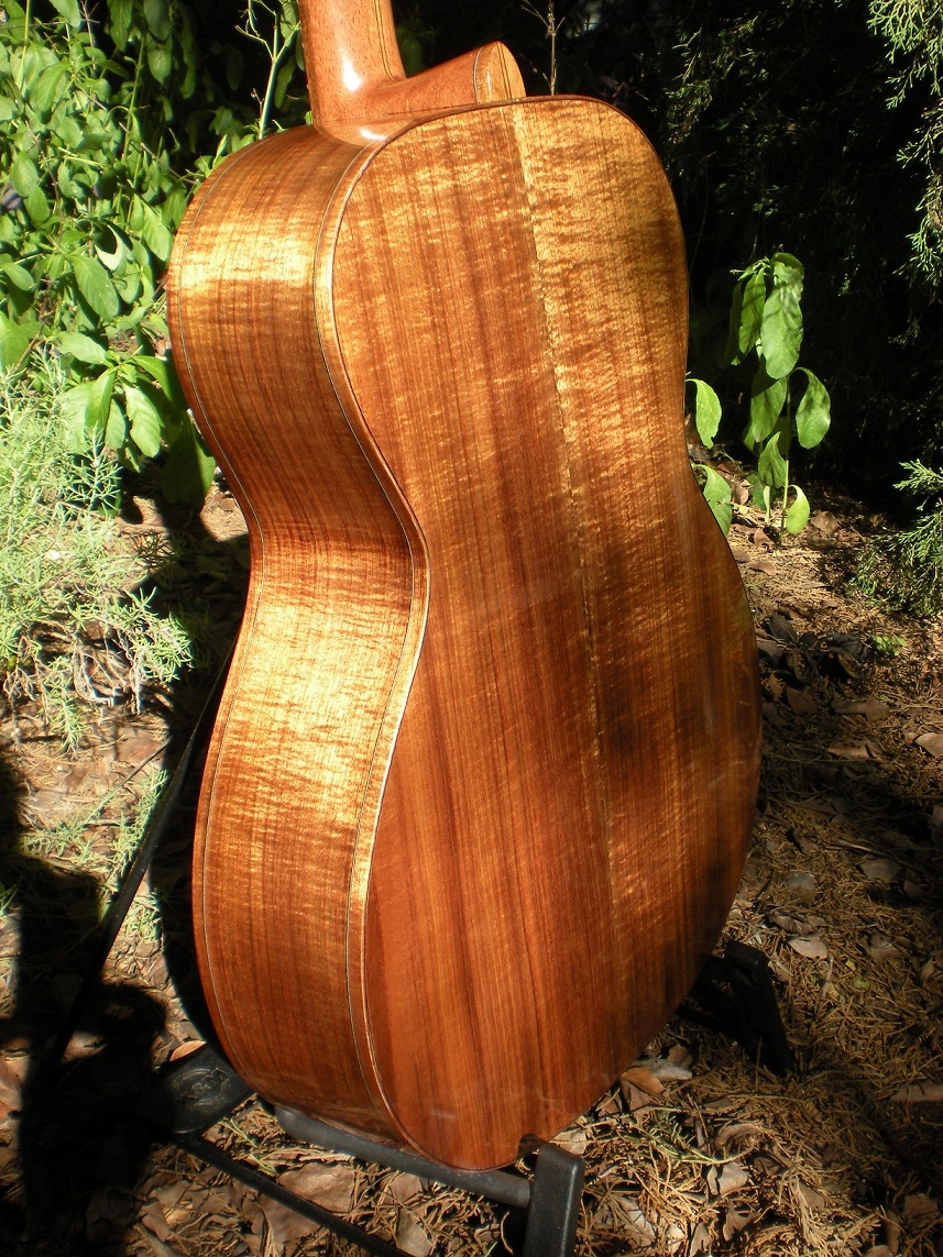

Post by Clancy » Wed Apr 13, 2011 8:57 pm
As usual, it's taken a while to get something off the bench.
This one's been strung up for abou 10 days and is really performing well.
Hard to get it away from anyone who tries it :D

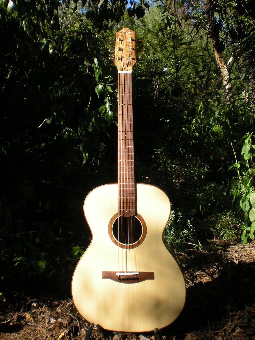

Tried to keep things simple & let the wood speak for itself.
Top - Some of Graham Hein's Englemann Spruce (without a doubt the real star of the show)
Back, Sides, Rosette, Bindings, Headstock, Backstrap, Heel Cap - Tassie Blackwood
Neck - African Mahogony & Tassie Blackwood
Fingerboard, Bridge - Gidgee
Inlay - Some of Jim's (DarwinStrings) refurbed Kiwi Ahstrays
Finish - Ubeaut Hard Shellac (French Polished)

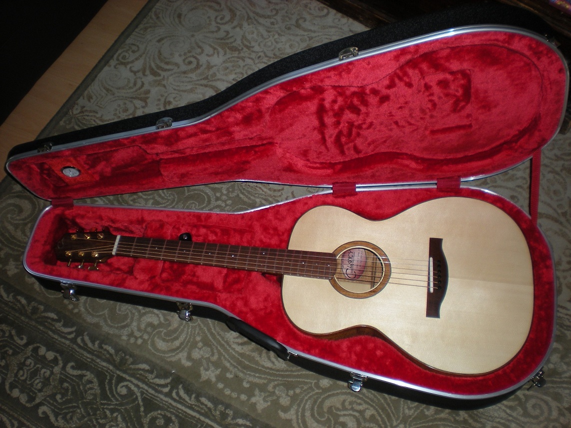

Post by Clancy » Wed Apr 13, 2011 9:03 pm

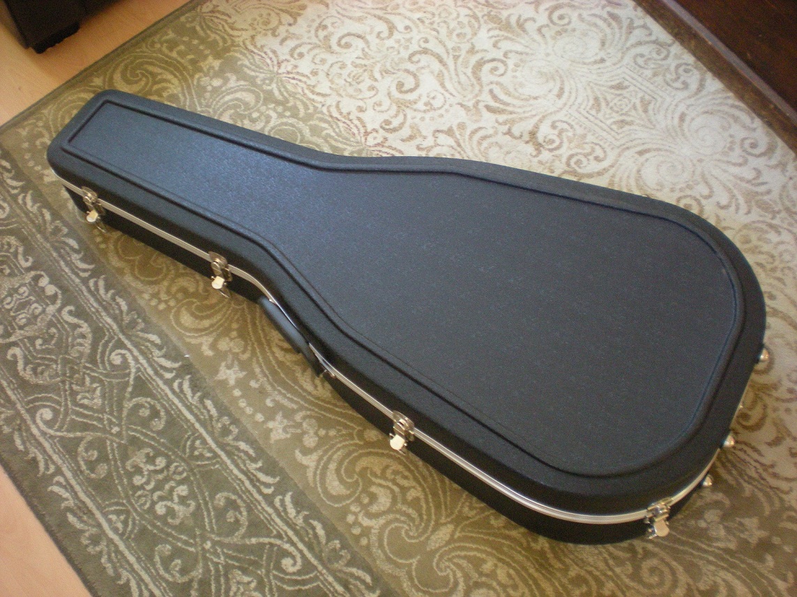

For those interested, I got this case off Aust Ebay for $100.
Plenty of foam padding & velvety stuff with a plastic outer skin.
The reason I'm showing it is that I used the Grellier OM Plan for my body shape & this case fits the guitar nice & snug.
I won't advertise the seller here, but if you want further info just PM me.

Re: Tassie Blackwood OM
Post by Kim » Wed Apr 13, 2011 9:14 pm
Hey Craig :D

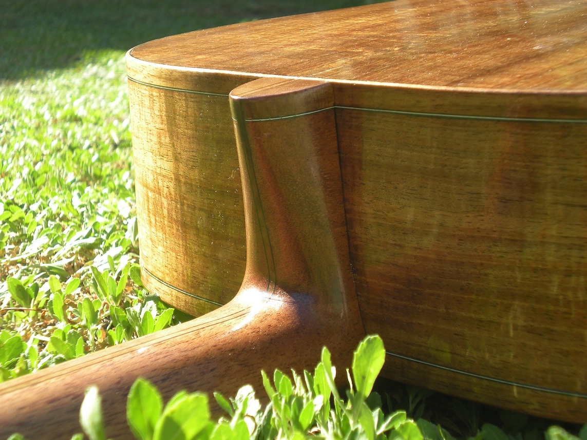

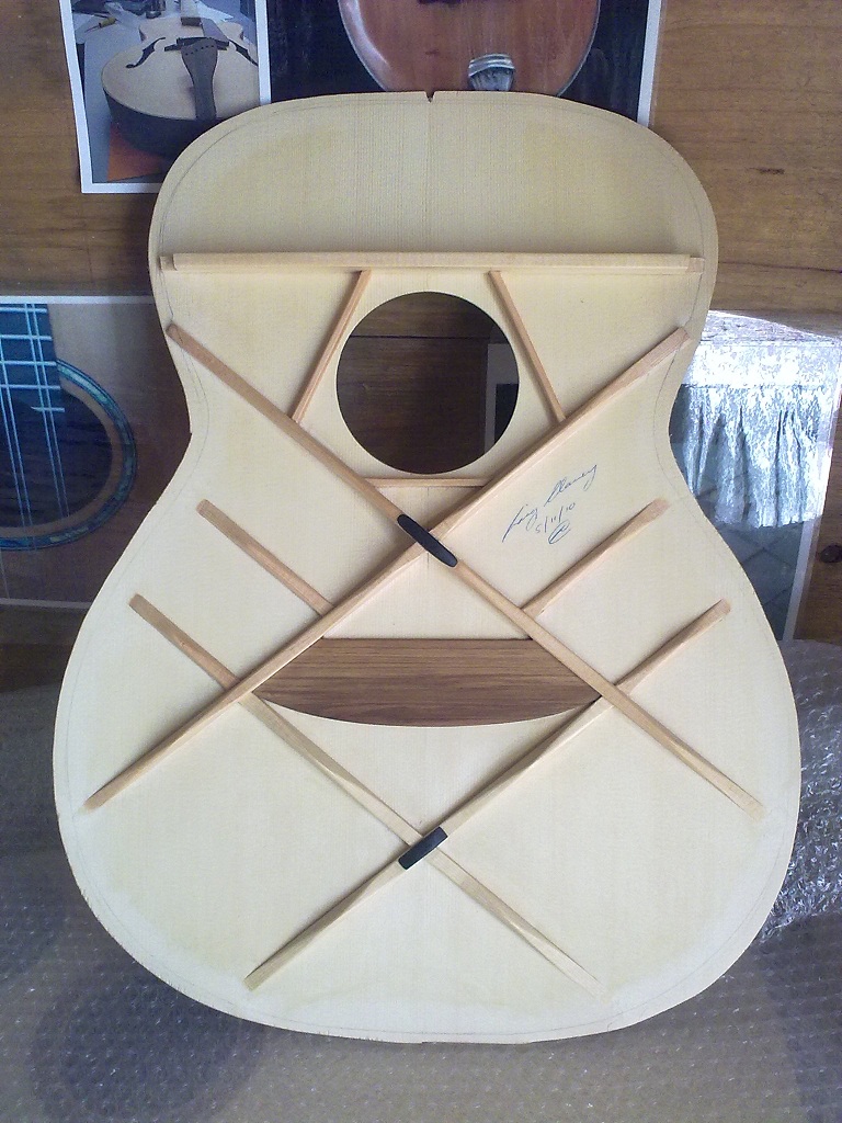

She looks wonderful mate. Shot 6 seem to tell of bracing that has produced a nice even 'dome' behind the bridge indicating the load is spread through the top as it should be. Therefore if you find it difficult to get the guitar back from players, you have obviously done justice to Graham's wonderful Englemann.
Must ask because the heel sweep is pronounced, what kind of neck joint are you using?
P.S. Please feel free to name the supplier of your guitar case. This topic is about 'your' guitar and that information is relevant to this topic.
Post by Bob Connor » Wed Apr 13, 2011 9:16 pm
Very tasty instrument Craig. Simple, elegant, understated and classy.
Post by Allen » Thu Apr 14, 2011 5:57 am
Looks very good. I like the shape of the heel too. Don't see anything like that too often.
Post by charangohabsburg » Thu Apr 14, 2011 6:18 am

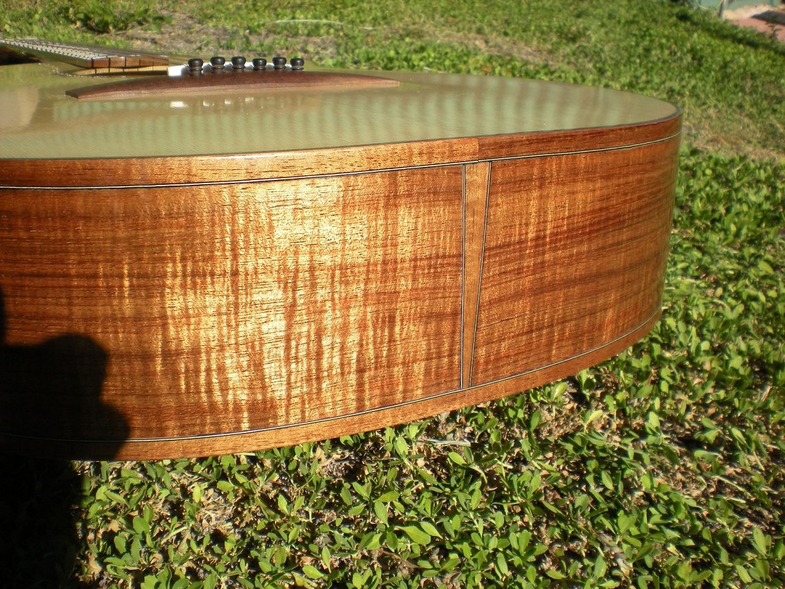

What a beautiful guitar! Well done with the bindings, "doing nothing" they really draw the attention to the wonderful wood of the sides! :cl

Nice job Craig, what's not to like on this! Evenly grained bit of spruce and I've always got a soft spot (or should that be a hard spot :oops: ) for anything with figured Blackwood, think it has to be my favourite looking timber & you've certainly got a good example of it there!

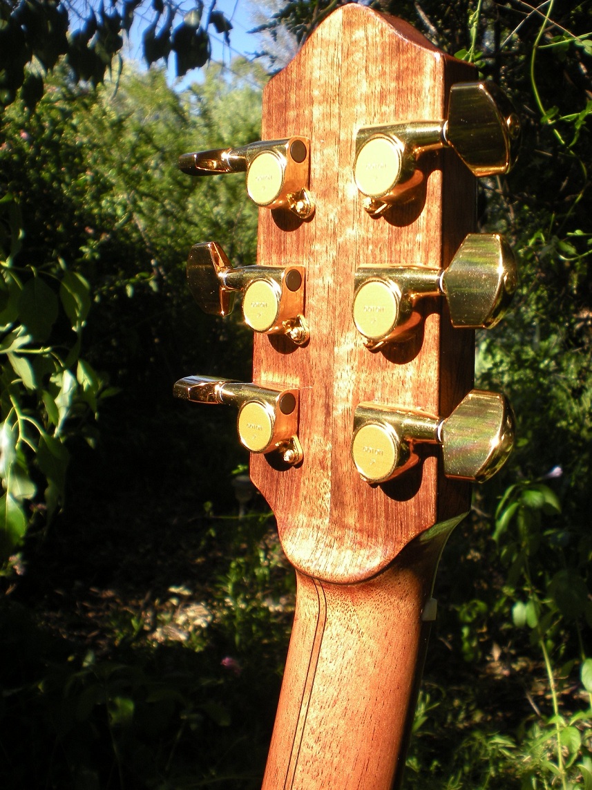

I love how you've carried the neck stripe right through the heel cap too, very classy touch! Perhaps you'd care to expand on how you achieved that (and keep the horizontal purfling perfectly inline with it's side cousins!) for enquiring minds?

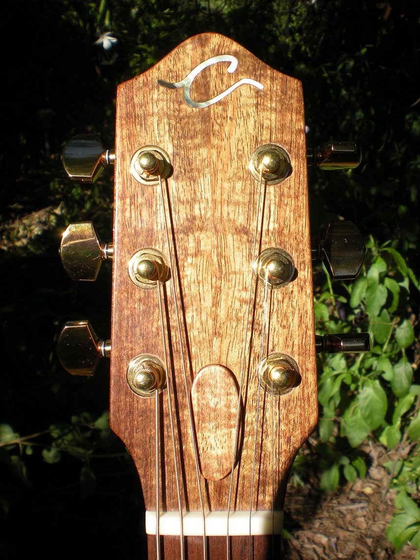

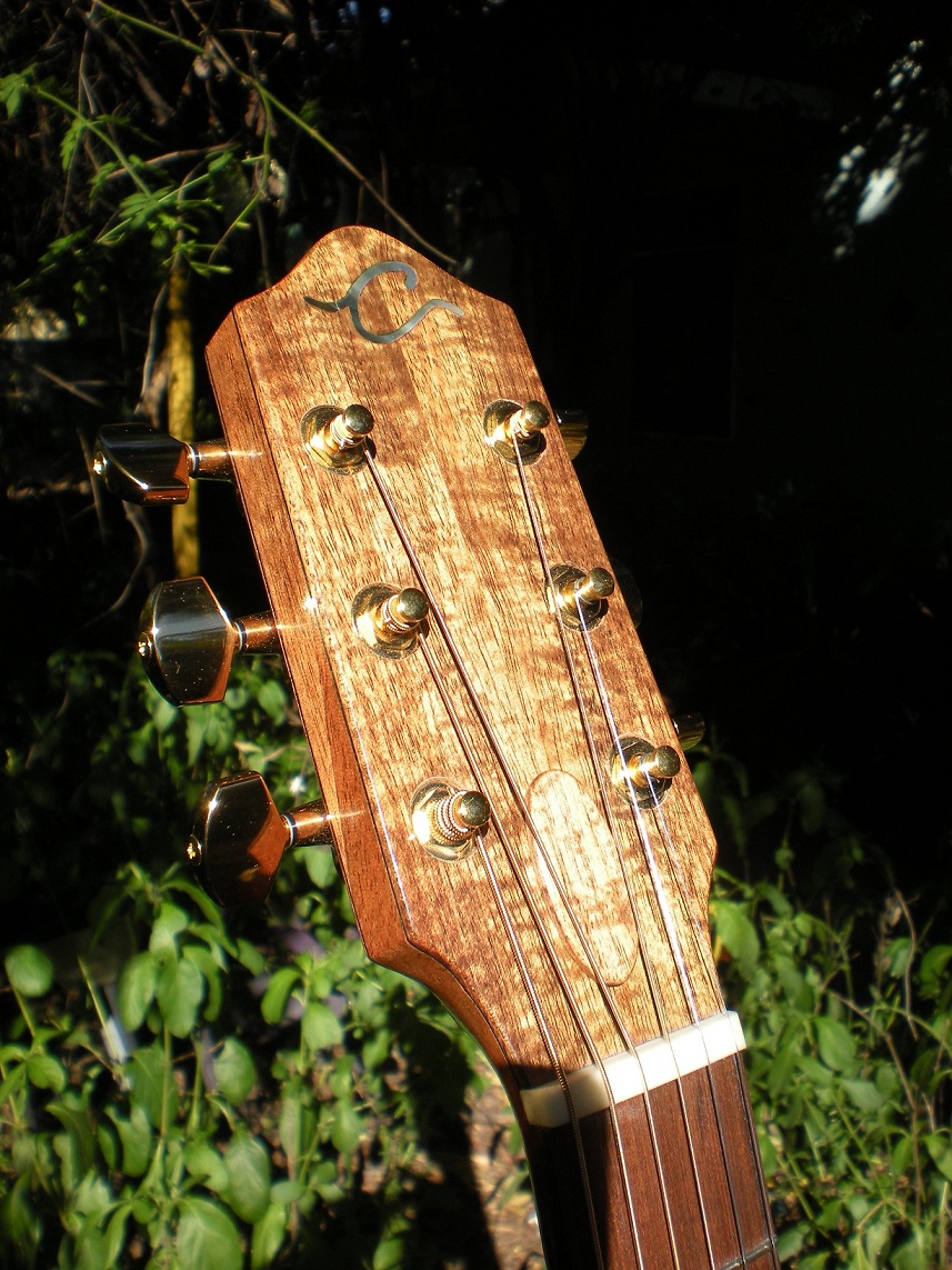

Post by ozziebluesman » Thu Apr 14, 2011 9:01 am
What a classy guitar Craig. I do like the small dot inlay and your truss rod cover. Blackwood is my favourite wood and your finish has a gorgeous luster.

I agree with Kim, I'd love to hear more about your neck design.

Nick, the heel stripe was achieved by simply making the 3 piece neck, cutting of the sections for a stacked neck & gluing them up, shaping the heel, then sawing & chiseling away the sections on either side of the stripe and gluing in 'heel cap' replacement pieces.
Smooth back into the heel shape.
(Does sound simple but I did have some nervous moments. Kept telling myself if I stuffed up, I could just cut the lot off & put on a heel cap and no-one would know I'd even tried :lol: )
(Sorry Kim & Lillian, can't find a picture of the heel and neck join on this one, but if you look on the Myrtle OMC thread I've added those pictures there and it's exactly the same. viewtopic.php?f=25&t=3136)

I braced the top with a Double X, for no other reason than I didn't have any bracewood left long enough to do the 2 parrallel style braces across the lower bout :?
I worked hard on voicing the top, took Dominics advice when he checked it out & felt it was still a bit stiff & tight, then once the body was together I continued to voice it by scraping.
Here's a pic of the bracing. An idea of the brace heights can be seen in pictures in the Myrtle OMC thread mentioned before.
The case came from Selby Acoustics in Hallam, Vic - ebay shop http://stores.ebay.com.au/Selby-Acoustics?_rdc=1
The Upper & lower bout sizes are perfect but they are a little tight at the shoulders (easily remified).

I thought that's how it may have been done but the trick would be trimming exactly the right amount off each side for the cap. Very clever :cl :cl

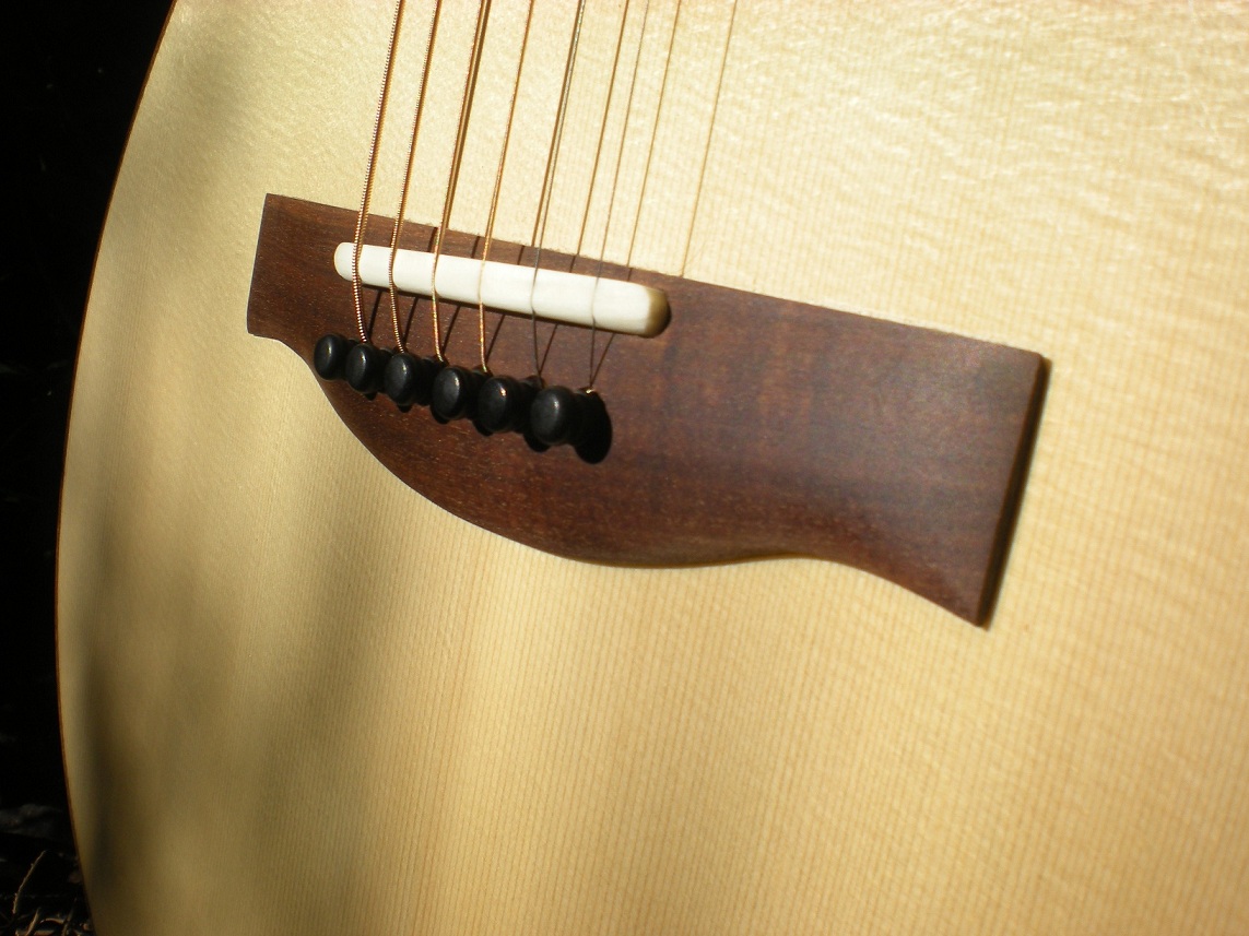

Hi Craig, I really like the way you have made the bridge with out the sanded in scallops but a graceful curve over the whole top surface. I would love to know how you did that so nicely.
Absolutely beautiful guitar. :cl

Nice work Craig. The heel cap demonstrates the level of your skills.

...graceful curve over the whole top surface.I would love to know how you did that so nicely.
Thanks John, it's one of the features I really like looking at too! (and running my fingers over it, and... no...better not go there :lol: )
Did it the hard way using a sanding stick to get the initial curve.
Then 'tucked in' some areas with a Dremil & little sanding drum.
Tidied up again with the sanding stick and sand paper wrapped around my finger.
Sanded free hand up to 600 & buffed with a cotton cloth tied around a rubber sanding disc mounted on a battery drill clamped in a bench vise :roll:

I just have to say Craig, that I love the bridge design - such understated elegance! :cl :cl I keep coming back to this thread just to have a look at it.
I might borrow the idea if that is OK?
