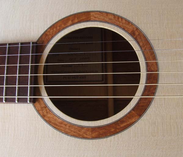

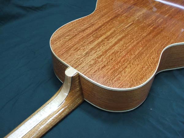

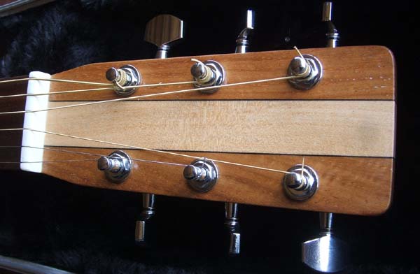

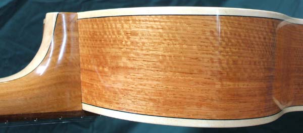

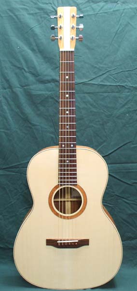

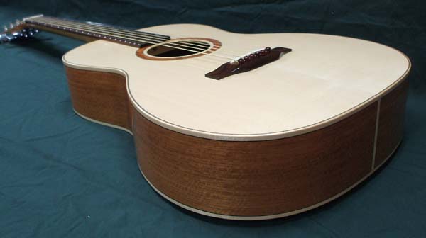

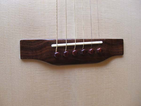

Finished and playable but the rain down here seems to have put drop marks on the NGR.This one sounds bloody great although that's only from the maker and I could be slightly biased.
Body : New Guinea Rosewood
Soundboard : Engleman Spruce

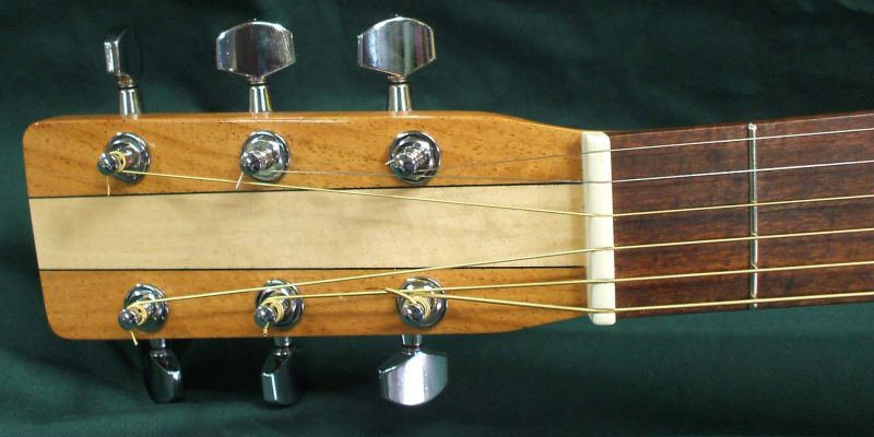

Neck : NGR and Silver Ash
Fretboard and Bridge : Gidgee
Bridge Pins : Cocobolo
Bindings : Silver Ash with black veneer under and BWB around soundboard

I've not seen Siver Ash like that before. It's bloody stunning mate !

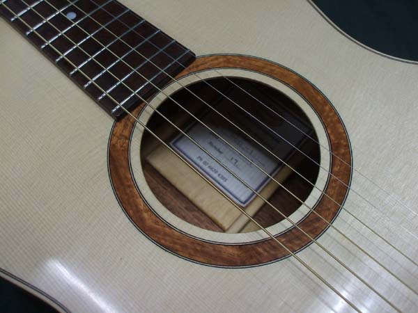

I'm going to have to give NGR a shot sometime . Everyone I know that's used it raves about it. Certainly has 'the look '. Tell us about the finish... and when can you do mine :lol: Hey !, I'm only just up the hill from you remember :wink: . It's not overly glossy , ,, just nice. I like your choice of rosette also . I've just done one similarish and am pleased I took that approach

Craig , The finish is Mirotone Nitrocellulose Lacquer and is 60% gloss.When you buff it becomes quite clear but not quite as glassy/toffee apple like the 100% Gloss.
Using Gidgee is no problem at all.It has a bad reputation for being hard but actually works quite well.I would rather cut up Gidgee or Cooktown Ironwood all day than dry Tas. Blackwood especially that dark stripy figured stuff.I don't think it matters whether the Gidgeee is back or quarter sawn for fret boards either.When it is dry it is very stable and the backsawn can be very pretty with a few grain lines where quartered can end up quite plain once it starts to oxidise .
The Silver Ash is from North Queensland ( Flindersia Bourjotiana ) and is quite white but will slowly yellow a bit mainly to do with the lacquer yellowing with age.Lots of natural lustre and subtle figure and very fine grained, beautiful stuff to work.

I love the contrast of the neck lams, good work! :D
