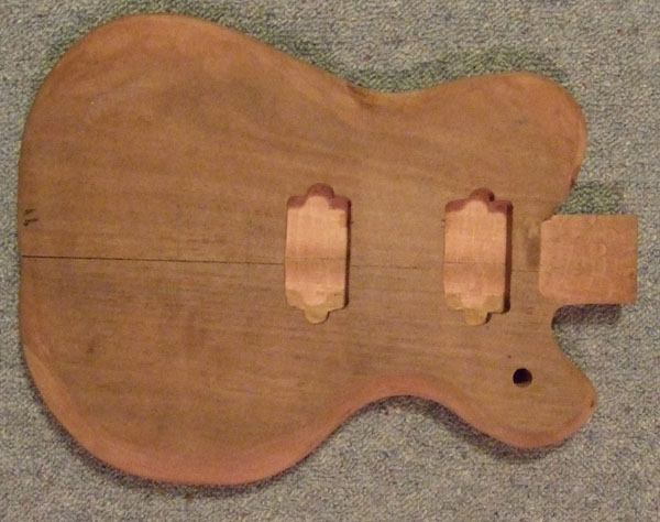

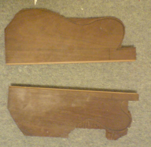

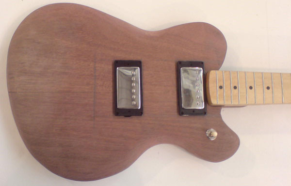

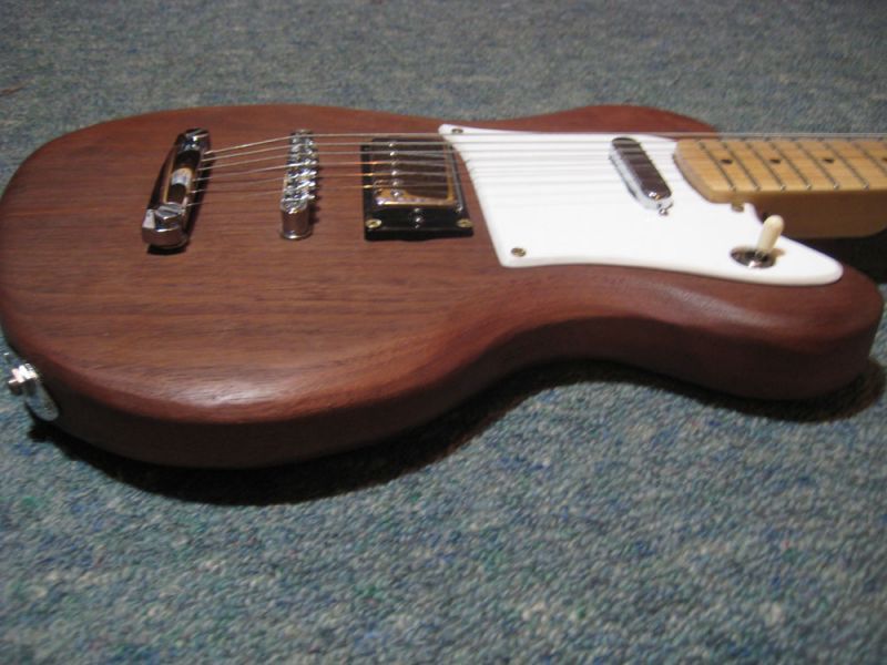

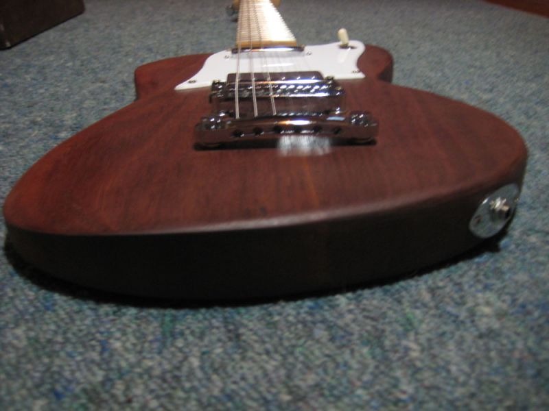

Something i threw together with some fairly cheap parts i had lying around.
Specs:
Neck: Dr Parts
Bridge: Dr Parts
Neck Pickup: Seymour Duncan Vintage Stack
Bridge Pickup: Epiphone Les Paul Standard pickup
Body: solid Jarrah (split piece)
I didn't end up using volume pots and tone pots because i wanted to make this, my first guitar, as easy as possible.
Overall, the guitar weighs in at just 3.8 kg - the problem with using such a dense wood.
Post by Hesh1956 » Tue Oct 06, 2009 11:54 pm
That's a very cool looking guitar you have there and I really like the shape of it too.
Nice job!
Post by Allen » Wed Oct 07, 2009 6:48 am
Nice simple design, and good color combinations. Don't think I'd like to have that much weight hanging off my shoulder though for any length of time. You are off to a great start. What's next?
