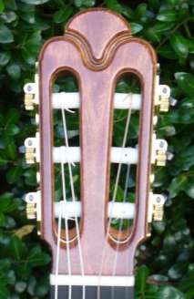

I finished up #3 over the weekend. It's another Romanillos inspired Classical with the following:
B/s - Bubinga
Top - Lutz Spruce
Neck - Spanish Cedar
Bindings - Bloodwood
Fingerboard - Ebony
Bridge - Mad Rose
Tuning Machines - Rubner
Scale - 650 mm
This one sounded really good right off the bench. It actually surprised me a bit. I can hear it changing, though as I have played it over the last few days. It has nice big basses, and strong complex trebles with lots of overtones and sparkle. #2(EIR/German) was that way too, but it has more of a "woody" sound I believe. It's hard to hear a lot of difference between the two - mostly in the nuances of the tone. I still have some cosmetic issues to deal with in my building, i.e., tighter bindings and purflings to sides. I also need to detail better before finishing. It's hard to stop and do that when you are wanting to finish the thing, and move on to another. Anyway, here are some pictures.

It's a very classy instrument Waddy. I like this rosette the best of the 3 so far for the colors you've gone with. Nice touch on the bridge tying in the design there as well.
The fret board flourish at the sound hole is a really nice touch. I've got to try something like that soon.

Nice job Waddy, it's a very clean looking guitar and, as usual, well executed. I like the little piece of rosette pattern repeating in the bridge capping, nice touch.

Even though I have said this before I really, really like your head stock shape and design - it's very classy.

Hesh1956 wrote: ... I really like your head stock shape and design - it's very classy ...
Absolutely 8) !!!
Tutorial Please, Waddy??
And while you're at it, where did you score the rosette?

Hesh, if you recall, I was working on a prototype headstock for my first and posted it on OLF, and got some tips. I think the tips helped me make it a good design, vs a ho hum one. I get comments on it from everyone who looks at my guitars. It makes me very happy! :D I especially appreciate your comments, as I feel you are discriminating, in your critiques. I hope you will tell me when you don't like something, too.

WaddyT wrote: ... the rosette is also my own design and I make them as one offs ...
Very impressive rosette design, Waddy ... and can you make that TWO tutorials?? :wink:
WaddyT wrote: ... I was working on a prototype headstock for my first and posted it on OLF ...
Can you give us the link?

Here is the OLF thread where I posted the prototype of my headstock. The original was too squat looking. Someone, and I can't recall who, said it looked stoop shouldered, so I tried to correct that in the final design.
http://www.luthiersforum.com/forum/view ... pe#p165705

Great guitar in all respects, and only #3, I'm impressed. As others have said the rosette is and eye catcher.

I guess I'm like everyone else . The headstock is a great design Waddy , but I'm also impressed by your rosette ,Bridge and fretboard flourish . Pretty amazing cross silking on the Spruce Too !
