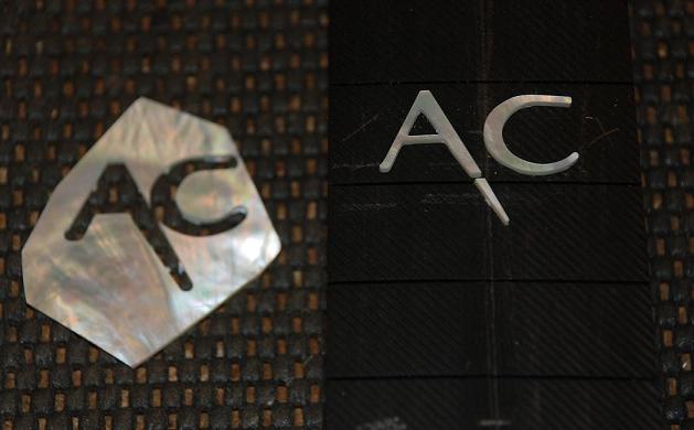

Features: Piezo Acoustic Bridge, Coil switching, stereo jack, Humbucker/Piezo blending. The new owners initials at the 12th Fret - in MoP. Thin neck.

Are you cutting your inlay by hand? Very tidy work.

Allen, yes, it is a very cool colour. I mixed a ratio of 3 parts Green to 1 part Blue. I also applied a diluted blue wash over the final stain coat to bring it to this hue - it is water based analine dye. It is the paleness and variation of the flamed maple that really highlights the colour. Maybe you could try it for a uke top :-) ??? definitely for back and sides, though.

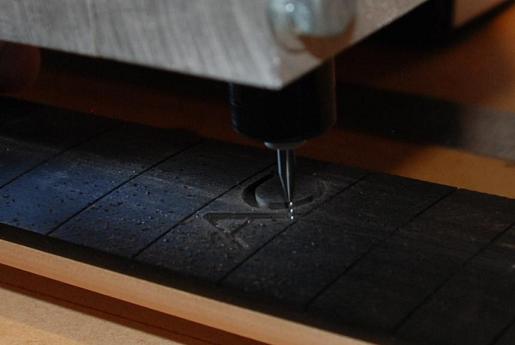

The inlay was cut with my CNC machine - both the MoP and the ebony pocket.

Also the first to use cnc to this extent on the forum also.
CNC scares me, especially considering I'm still learning
how to tie my own shoelaces properly and still can't get it down pat. :lol:
