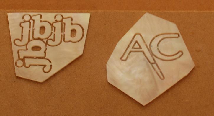

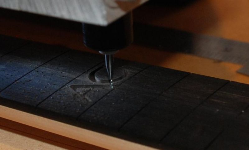

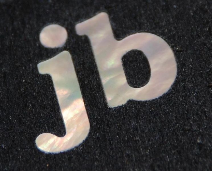

I must admit that I don't get a lot of joy out cutting inlay by hand, but I do really enjoy designing and cutting on the machine. Sometimes it feels like I don't even need glue to hold the MoP in place. The pocket can be with no offset to the MoP. Here are so photos to show what I mean

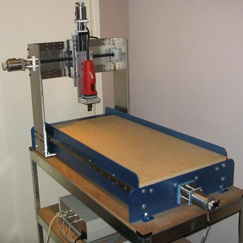

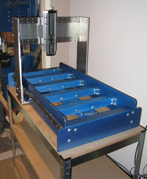

The cost was mostly in time - the actual cost was about $2000 for the parts of the CNC machine - some of it was scrap aluminium etc. About another $1000 in Software to generate and run the Gcode and about $1000 for the 3D drawing package. Here are some photos of the machine I built. It was a bit of a challenge working with Metal rather than wood and it was very strange to have metal shavings in workshop.

I think it's a brilliant way of incorporating some of the more laborious and repeatable tasks into a build scenario. Kudos for going out there and setting up for it and going through the learning curve of programming as well. Well done Jason.
It seems alot cheaper than I expected to kit out for this type of thing. :wink:
