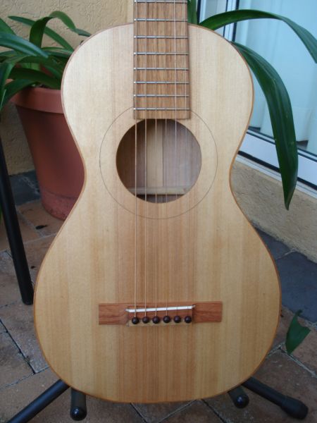

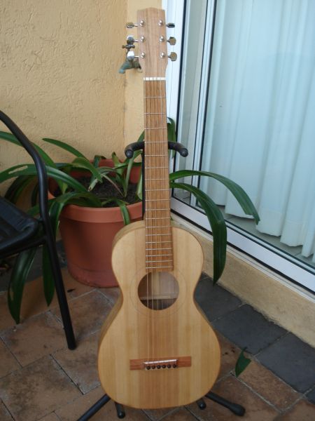

here's my first guitar, i've been working on it for about 5months and now its done.
its a small ladder braced parlor guitar of my own design.
kauri pine top.
tas oak back sides and neck.
NGR fingerboard.
bridge ?Image

very interesting guitar here especially the binding. i love how you havn't binded the back to the sides i think it looks unusual and cool. I havnt seen a kauri pine soundboard in ages and i think they are impressive but i have never heard how they sound. Youll have to post a link to you playing to give me an idea. Great first effort

being a wimpy first timer i've had it tuned to open F# for 3 or 4 days and the sound was a bit thin. uncomplicated.
so I manned up this evening and tuned up to open G and what a difference that made :D . much richer, more sustain, much better.
i based the build on a 1970 harmony stella i've got. its got a birch top and painted on binding on the top edge only. hence the top only binding on mine. also meant i didn't need to make a fancy jig for my laminate trimmer :lol:
the sound is definitely bluesy, as i intended, great with a slide. hopefully it'll get better still.

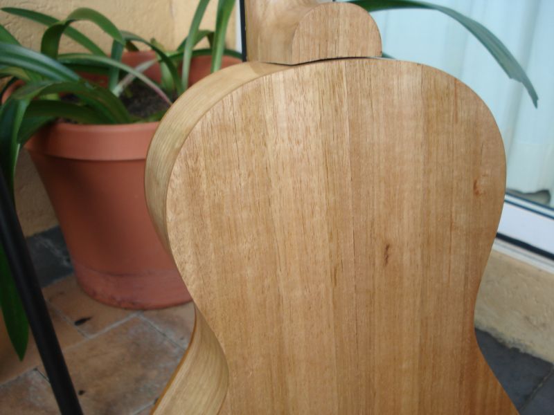

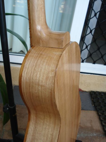

Nice work for a first effort Liam. The back/side bindings....not my cup of tea but that's just personal preference.
Um I'll probably get into serious trouble with others for asking this and there may be a perfectly valid reason but I cant help but notice the gap between the lower part of the heel and the side of the instrument. What sort of neck joint did you go for...bolt on or M and T?

the neck is an adjustable butt joint using a single threaded insert.
as you tighten the cap-head bolt from the inside of the heel block the neck angle comes down.
Post by kiwigeo » Sun Aug 09, 2009 1:14 pm
I knew there must be a reason.....thanks Liam.
