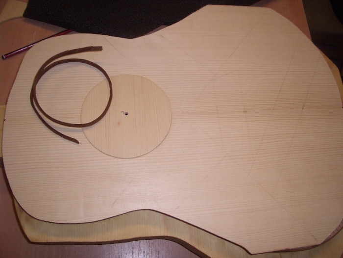

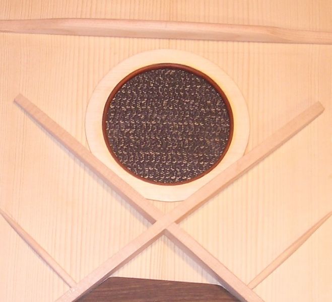

I also like the soundhole binding. Can you tell us how you went about bending/fitting it?

Dom - I took some pictures as I did the soundhole binding so I will put them up soon

Post by Mark McLean » Tue Aug 04, 2009 11:27 pm
Dominic
You asked about the soundhole binding. I followed the technique that Nigel Forster shows in this Youtube video.
http://www.youtube.com/watch?v=9f_t-wGo ... re=related
The top was about 3mm in thickness and I added a reinforcement ring around the soundhole instead of using popsicle soundhole braces. This was simply some offcuts from the soundboard glued with the grain perpendicular to the soundboard. Glue a circle which is a bit larger than the soundhole and then cut out the hole and it will end up like a do-nut. This will then give a 6mm thickness at the soundhole and my cocobolo bindings are 6.7mm tall. Bend a binding strip into a spiral and then trim it to length and glue it in. I taped the binding in place and also put a conical object in there to clamp it (did you see Jeff's post of this? viewtopic.php?t=984&highlight=soundhole+binding+jig). For the guitar I found a plastic cone once used at my Son's soccer training, or you could steal one from some roadworks nearby. These 2 pictures should tell the rest of the story. Then it is just a matter of scraping and sanding.
