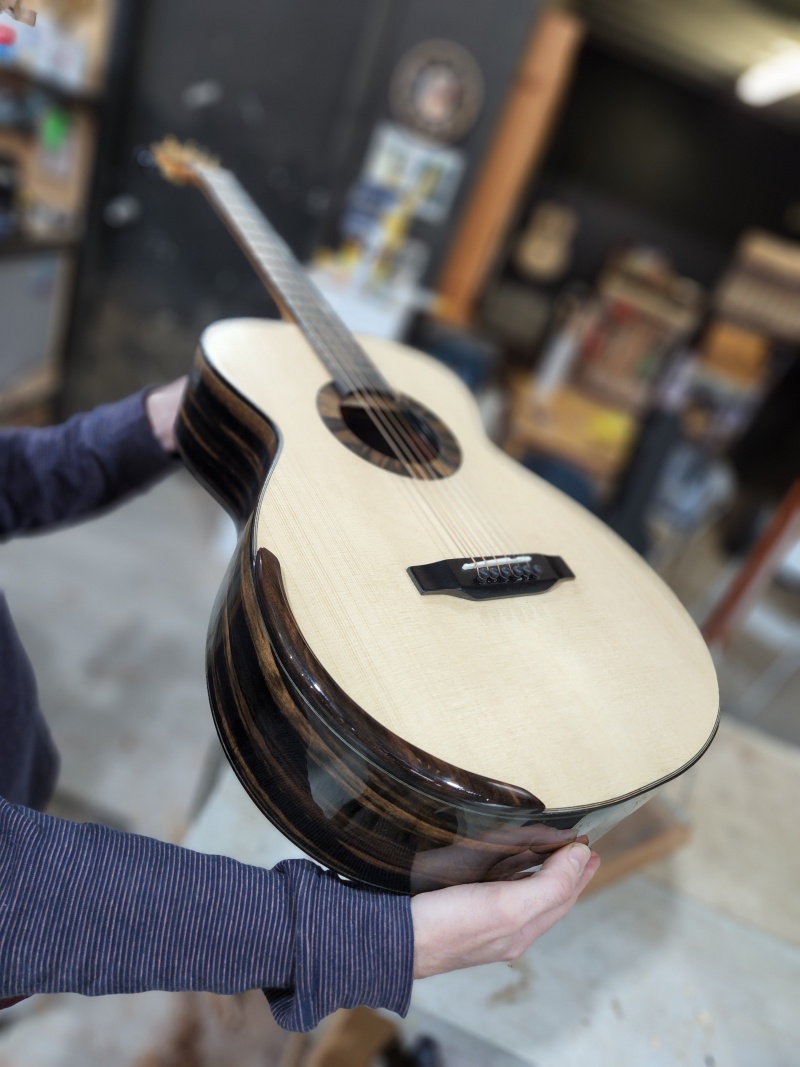

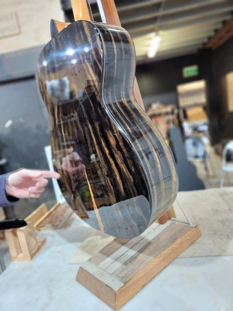

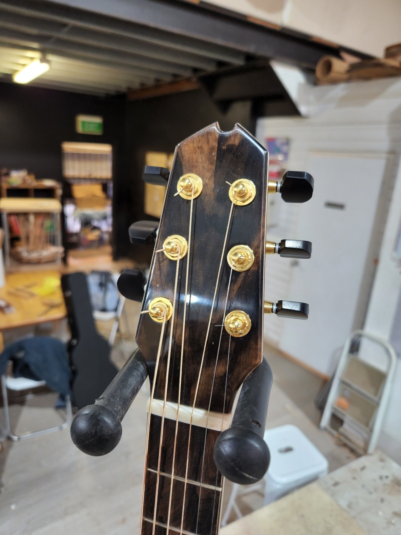

Sharing a recent student build.
Owen just finished his Ebony and Spruce OM. Falcate braced. Nitro finish. She's a stunner.
This is Owen's 4th guitar built at my school.

Wow, that is a real head-turner!. The colours and the finish are stunning. Is it heavy? How is ebony to bend?
Re: Student build - Ebony and Spruce OM
Post by lamanoditrento » Mon Sep 05, 2022 6:55 am
Very nice. Is that satin on front and gloss everywhere else? Lovely
Correct. Nitro.
I keep the amount on the soundboard to an absolute minimum (reduce mass). So never do glossy soundboards (except with shellac on occasion).
