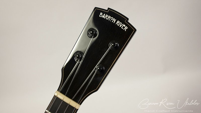

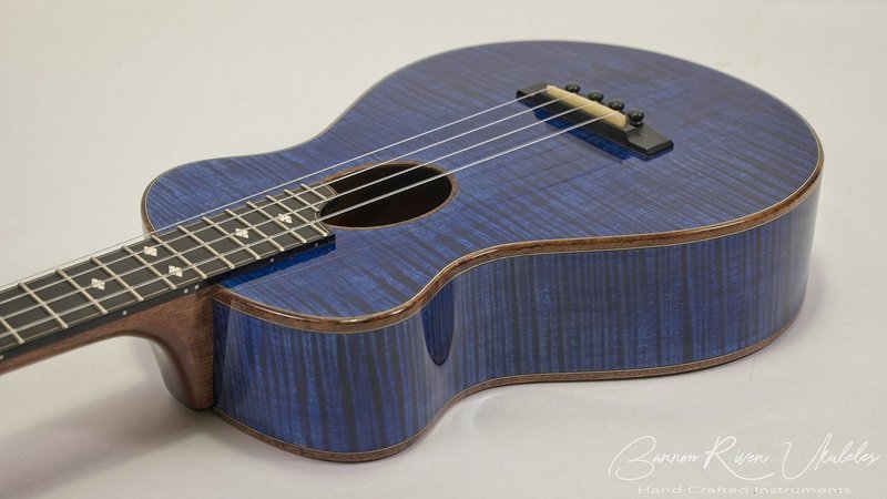

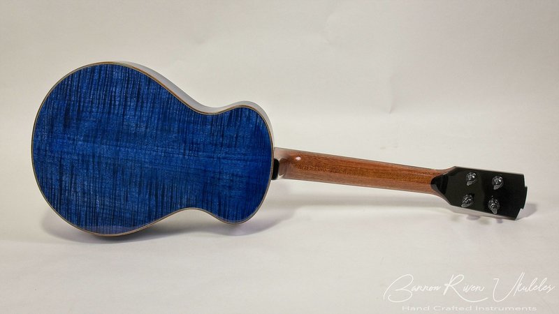

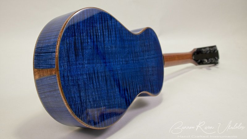

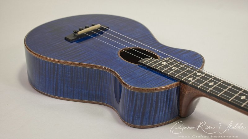

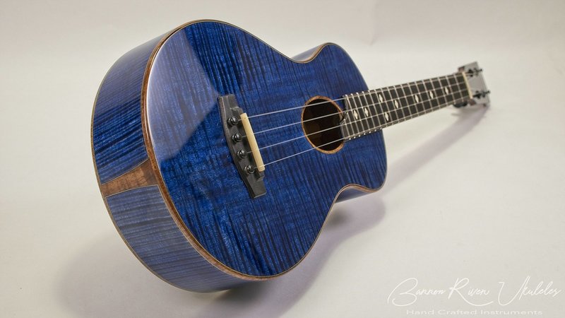

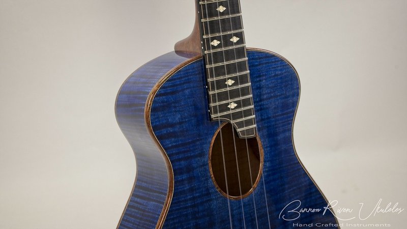

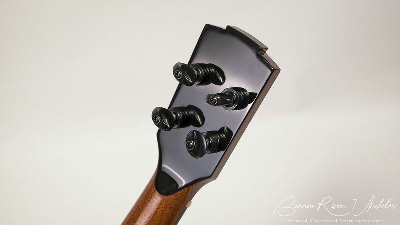

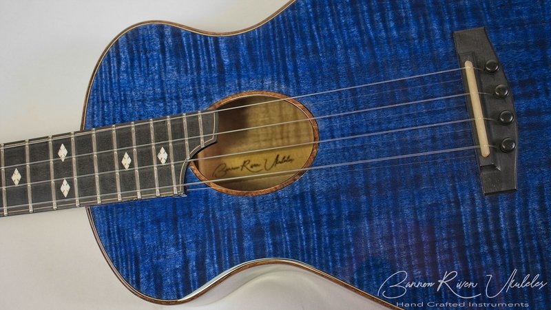

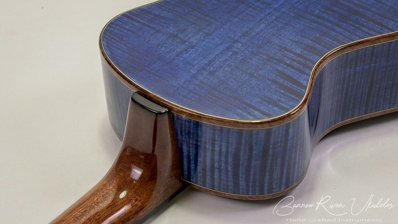

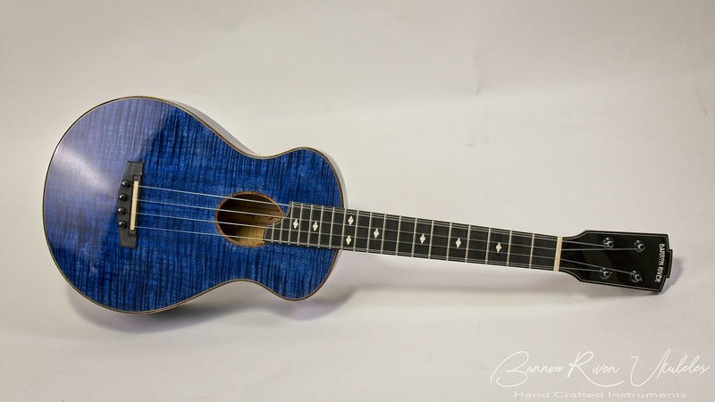

I've been wanting to do something like this for quite some time and finally got around to it.
Maple body with Australian Blackwood bindings and the rest is ebony. Gotoh UPT tuners, strung up with a low G.

Allen, that looks very cool. The contrast to the blackwood bindings and soundhole binding is lovely. Good decision not to have any rosette in this colour scheme. How did you apply the dye - hand application or spray? It looks flawless, and way better than anything that I have ever been able to achieve by hand application.
Re: Blue Flame Maple Tenor Uke
Post by Allen » Fri Mar 26, 2021 8:07 am
Done by hand. I stained the body black before adding the bindings. Then when leveling them I sanded it all back so just the black was left in end grain. Masking off the bindings and applying blue mixed with alcohol carefully so I got very little bleed out under the tape.
