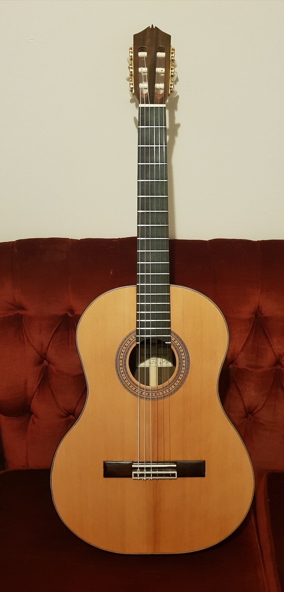

Post by kpcart » Sat Aug 10, 2019 9:53 pm
Built in 2017 for a family member.

Post by demonx » Sun Aug 11, 2019 9:07 am
That looks like a lovely guitar, great work, well done!

Post by Mark McLean » Tue Aug 13, 2019 8:07 pm
So now I understand why it is called Qld walnut - it looks just like walnut, which is one of my favourite guitar timbers. That instrument looks great! How is it to work with? It is nice to see indigenous timbers pairing up so well.

Post by kpcart » Tue Aug 13, 2019 8:47 pm
Queensland walnut is simple, and bends nice and easy, pretty decent taptone, but not as good as rosewood. Has a nice ribbon effect, grain changes colour when viewed from different angles.

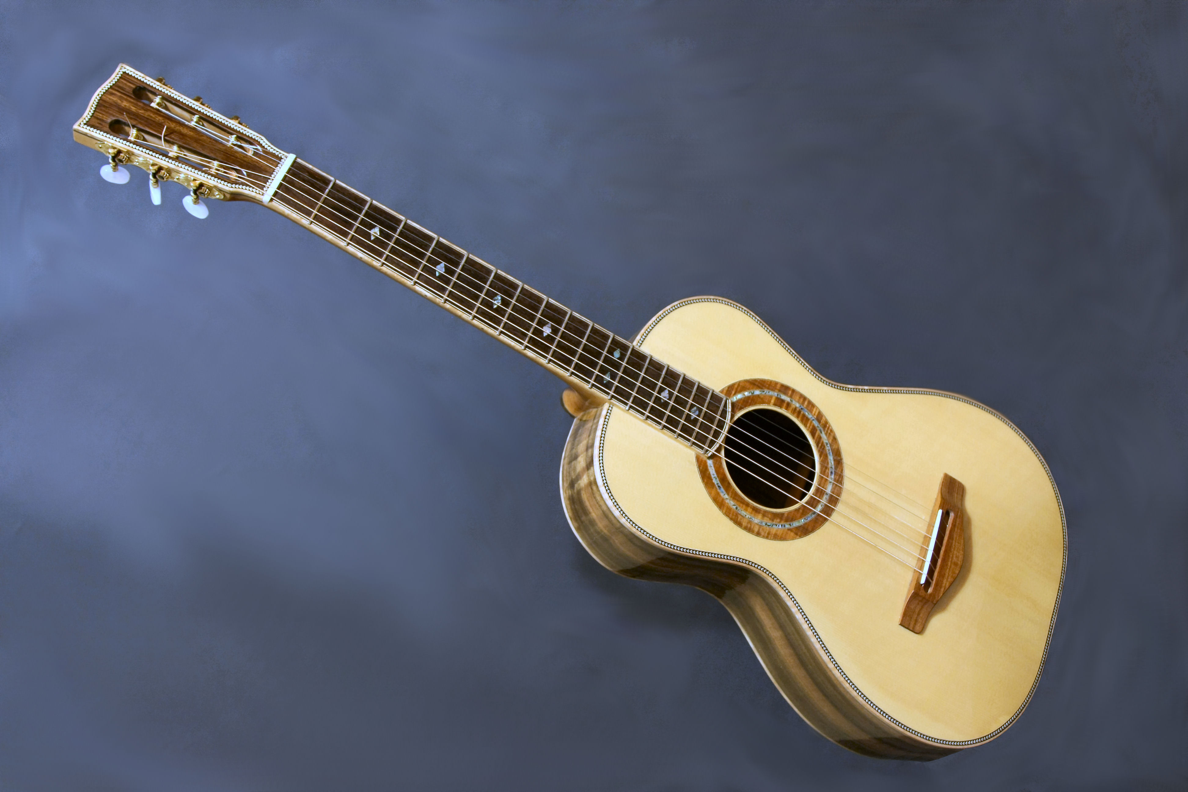

A quick addition to my post with regard to Queensland Walnut:
Here's a picture of the parlour guitar I mentioned I'd made. It's not quite illustrating the visual properties of the wood - I can't seem to find a photograph that I might have taken, better showing the back and sides - but you can sort-of see the colour and appearance.
Frank.
