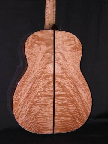

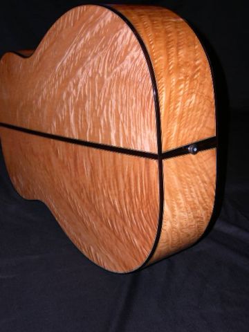

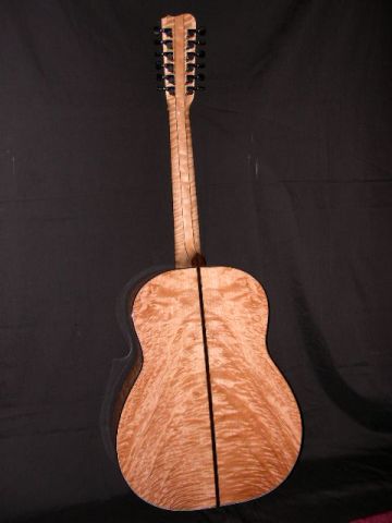

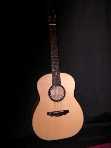

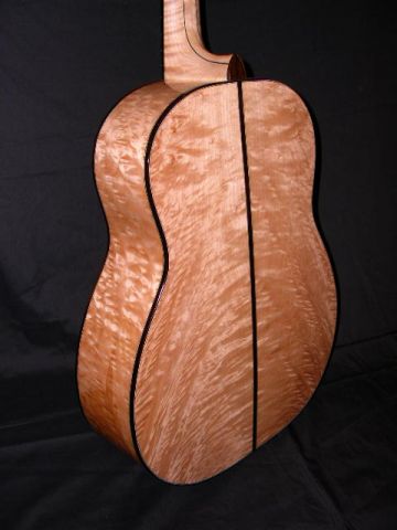

Maple/Lutz 12 string
Post by Stephen Kinnaird » Wed Jul 02, 2008 9:37 pm
This to my thinking doesn't compare to the raw creativity of Craig Lawrence's Myrtle 12 string, but I thought you might enjoy seeing some North American Big Leaf maple. This particular set displays a rare figure called by some stair-step, or angel-step or angel-wing. It's a form of quilt figure, only fairly angular. The top is from British Columbia: some of Shane's Lutz spruce. Brazilian rosewood bindings/headplate.
Thanks for looking!

Post by Kim » Wed Jul 02, 2008 9:52 pm
Just beautiful Steve,
Quite simply an outstanding combination of wood that showing very refined taste and an incredible application of skills, what a combination, and what an amazingly lucky customer you have lined up for this one.
Craig's work is outstanding as well, we are all very proud of him here and I am sure he will be flattered by such recognition by one of the famed Kinnaird Bros. 8)
Thanks for sharing with us M8.

Post by Craig » Thu Jul 03, 2008 9:43 am
G'day Steve ,
Man ! , that Maple is mind blowing . I've never seen Maple like it before .
It's a truly beautiful instrument Steve and I am indeed flattered by your comment . Many thanks to Kim also

Post by TimS » Thu Jul 03, 2008 11:21 am
Beautiful work Steve,
I ahve the privilege of holding it and having a play at the GAL. No doubt it is off to a good home.
regards
Tim

Post by Taffy Evans » Thu Jul 03, 2008 12:45 pm
Wow
That is a very appealing peice of timber and well put together very tastful. If you are like me I hate to see guitars with exceptional figure/tone go to someone else, but I suppose we cant keep them all.
Thanks for sharing that.

Post by Ron Wisdom » Thu Jul 03, 2008 1:11 pm
I'm a huge fan of your work, Steve!! That is really a magnificent instrument.
Ron

Post by Stephen Kinnaird » Thu Jul 03, 2008 1:51 pm
Fellas, many thanks for the kind words.
Taffy, I know exactly how you feel, because I felt it big time with this guitar. Sold it to a friend...who lives here in town...whom I see frequently...and I STILL felt sad driving away from the sale. What is this? You'd think I'd gotten rid of my favorite dog or some such thing.
Craig, you are most welcome. In fact, you are due some "dangs" of your own!
Kim, Bob, Tim, Ron, cheers M8's.

Post by Allen » Thu Jul 03, 2008 4:54 pm
G'day Steve. Can't add much to the above comments except that you're starting to get the lingo. Might have to get out on the piss with Kim and he'll be able to teach you a few more colorful phrases.
I just got a few sets of Birdseye Maple at the OLF swap meet. Never worked with it before except to bust into blocks for firewood back when I lived in British Columbia. Oh the shame. :( Anyway, can I ask how you find it to work with? Any problems bending? Tendencies to staining etc.

Post by Paul B » Thu Jul 03, 2008 7:04 pm
Oh Craig gets heaps of Dangs. Though they are usually shouted at him :lol: :lol: :lol:
Nice ax Steve. Very understated but beautiful and eye catching at the same time. I guess sometimes you just gotta let the wood speak for itself.

Post by Stephen Kinnaird » Thu Jul 03, 2008 11:41 pm
Allen, thanks amigo. (Might as well spread the education around, eh?)
Maple, from my perspective, has it's plusses and minuses. Of all the odd things, it's very easy to bend. Get it hot and it gives up. (That said, I've never tried birdseye figure, but I'm guessing that it will behave itself also.)
It is a dream to finish, as the pores are so very small as to present no problem. In the minus column, it's the sanding! You will find maple as resistant to your efforts as national politics---to borrow a phrase from David R. Young. Very tough wood, very abrasion resistant. However, press on through and the rewards are great.

Post by sebastiaan56 » Fri Jul 04, 2008 4:56 pm
Paul,
Its been beer o'clock for at lease four hours, its Friday.
Stunning guitar Steve, quilted maple forces me to go take a cold shower. Here is another stunning piece of this timber. http://www.mandolincafe.net/cgi-bin/iko ... 10;st=3375 13th post down. How much can I sell a couple of kids for..... slobber...slobber....
