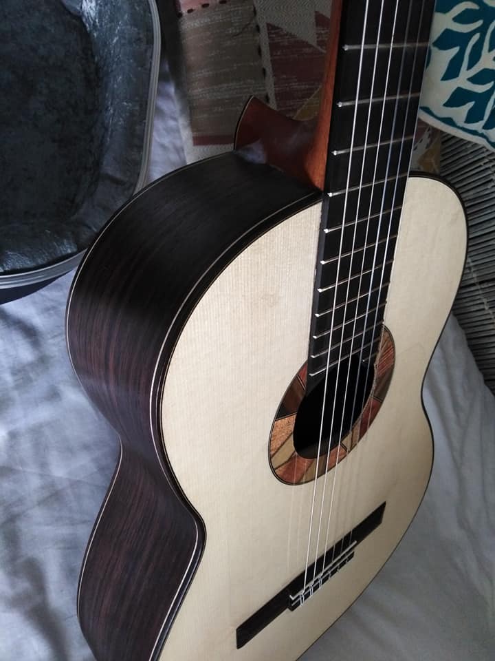

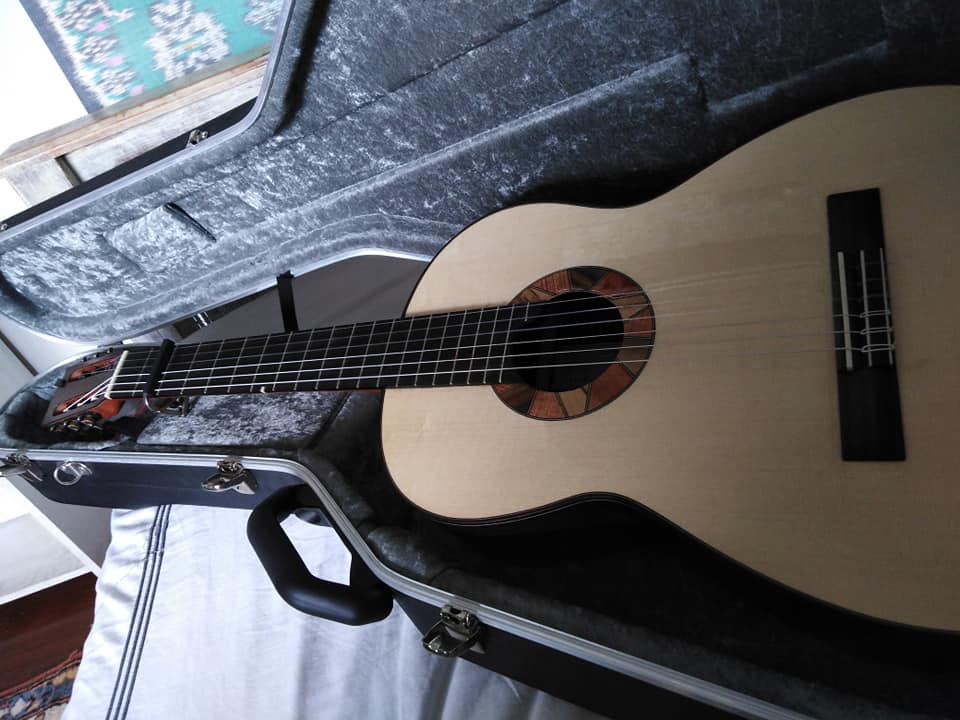

Finished this Flamenco Negra last week for Spanish guitarist Paco Lara.
6 week build from start to completion, strings on for the first time last Sunday, picked up by the customer on Wednesday, on stage on tour on Thursday. :D
Soundboard: Spruce
Back and Sides: Indian Rosewood
Neck: Toona (aus cedar)
Fretboard: Indian Ebony
Bridge: Brazilian Rosewood
Finish: Nitro satin (would have done a french polish but unfortuantely time restraints)
Rosette: Tas blackwood, and sassafras - Paco requested a non traditional Australian inspired rosette
Soundboard bracing: My 7 fan asymmetrical
Sound: Huge presence and volume, quick attack while retaining good sustain, "demands to be heard" - not my words :wink:
I didn't get any professional completion photos - slipped my mind in the rush to get her setup. But here's a few.
