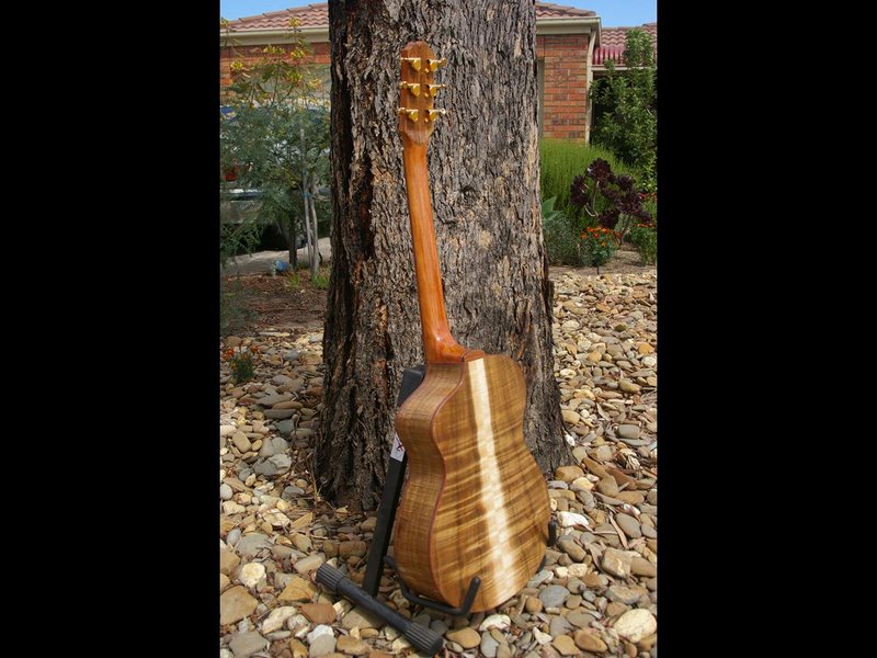

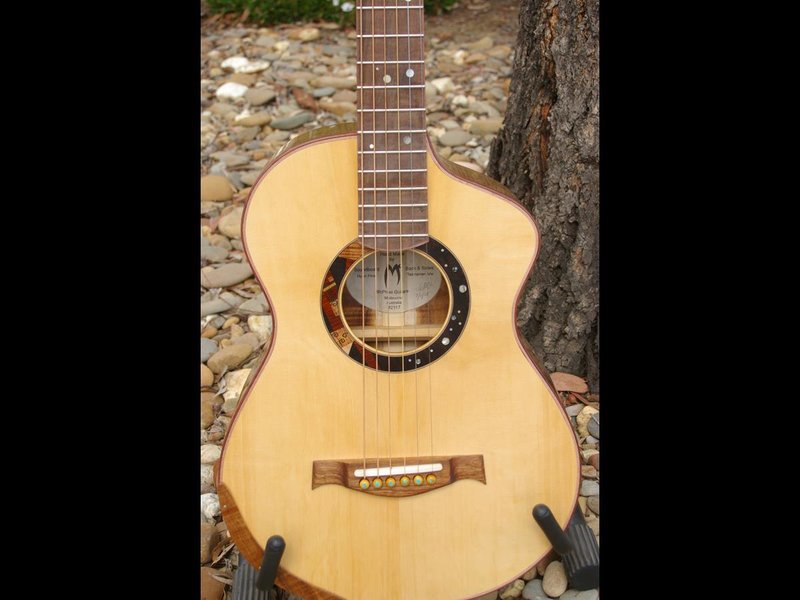

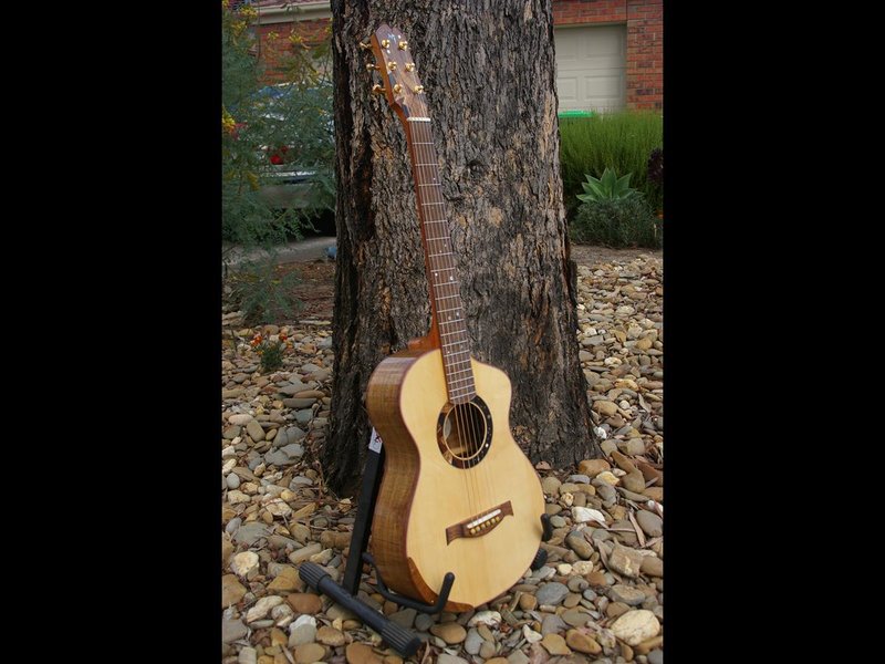

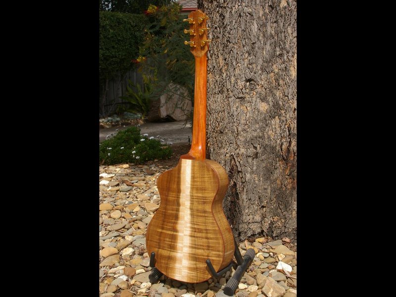

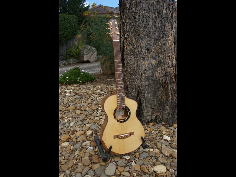

I've built this guitar for myself because I have 2 crook shoulders and having my right arm over a dread is painful. It's about 25mm longer than a mini guitar and about 25mm shorter than a parlour, sort of in between. It's really loud for a small body guitar, think that might be the Huon, second small body I've built with it and both are loud. I went with a 25.34" scale and 14th fret joint.
B/W b/s sides, I got this set from Pete's ebay store, amazing figure in it.
Huon top also from Pete's ebay store.
NGRW neck
Jarrah bindings.
EIRW bridge.
Gidgee f/b
Gotoh tuners
Finished with hard shellac ( my first go at it )

Thanks guys. Mark i found the hard shellac pretty easy to work with and the results for a first time are pretty good, I've been using lacquer and I wanted to try something else, I thought I'd give it a go because it was for me. I started finishing another guitar today with it, I think i'll keep using it, a lot less toxic than lacquer. That cutaway shape is what I use now I really like it it's the 3rd time I've used it on guitars before that I used it on my ukes and then thought I'd try it on my guitars. Gaz the armrest has 3 small dowels in it ( tooth picks ) I use them to locate the armrest when I glue it makes it way easier than trying to find the right spot where you've made it for. I kept the huon at about what I would spruce, It's braced with x and lattice having CF under and over the lattice. I think you'll be happy with the Huon for a top, I reckon it's great and I'm trying to find another top now for another build, same size as this guitar.

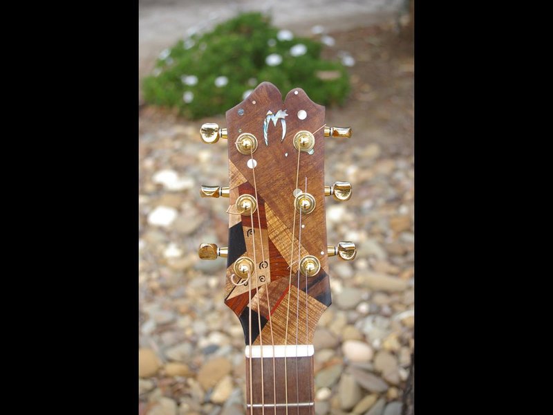

I absolutely love that head-stock pattern design. How did you get the idea to do that, 56nortondomy?

I just wanted the headstock to match the rosette, it was just a design I had in my head for a bit, seeing the guitar was for myself I did it. Wayne
