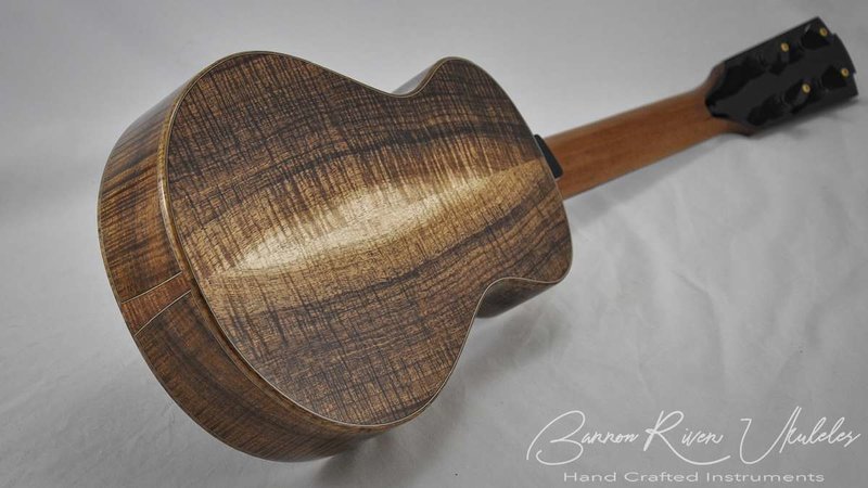

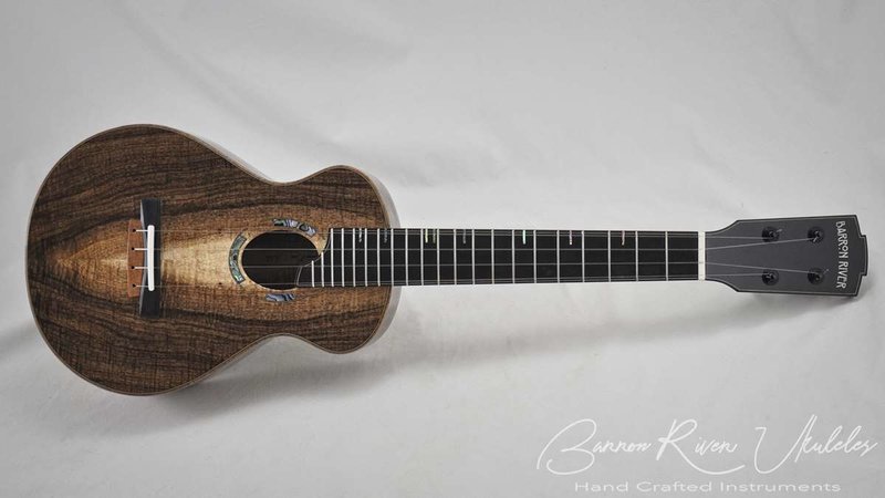

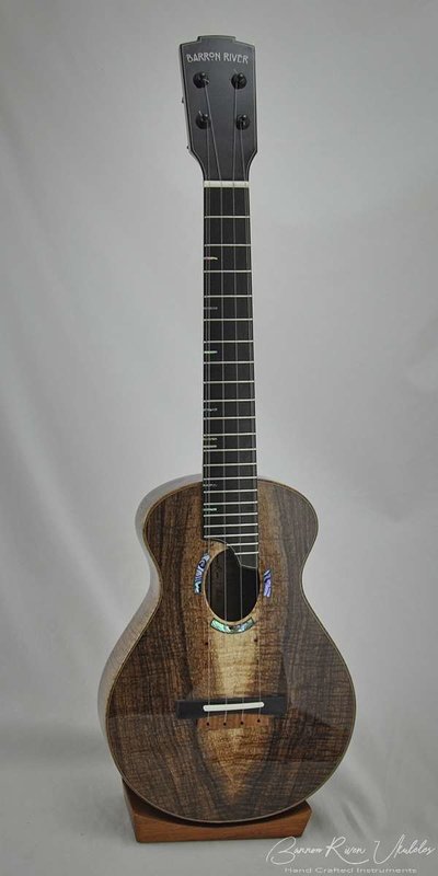

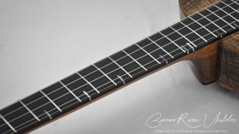

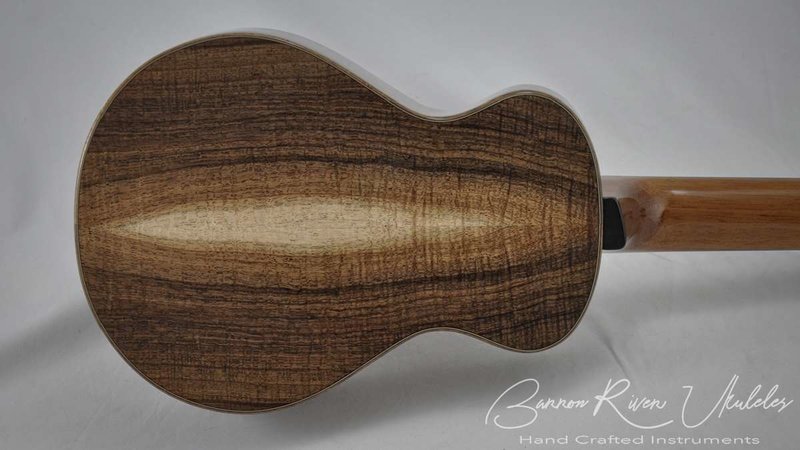

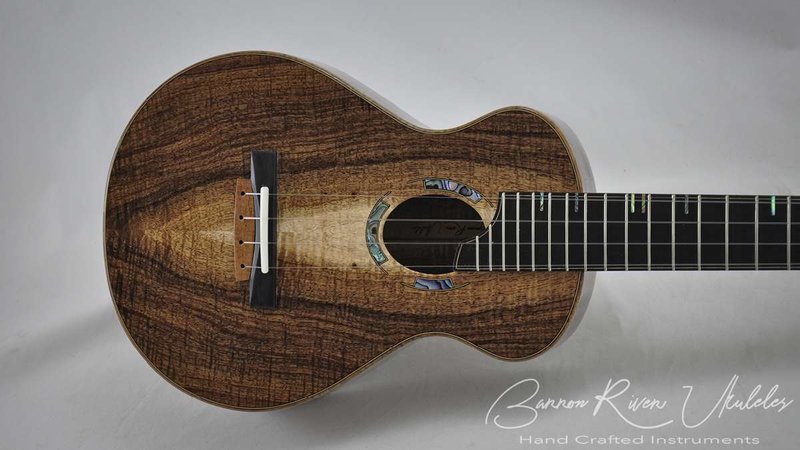

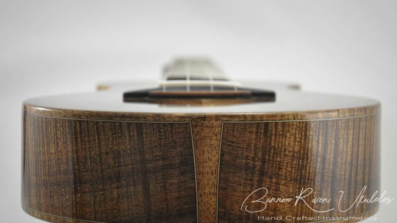

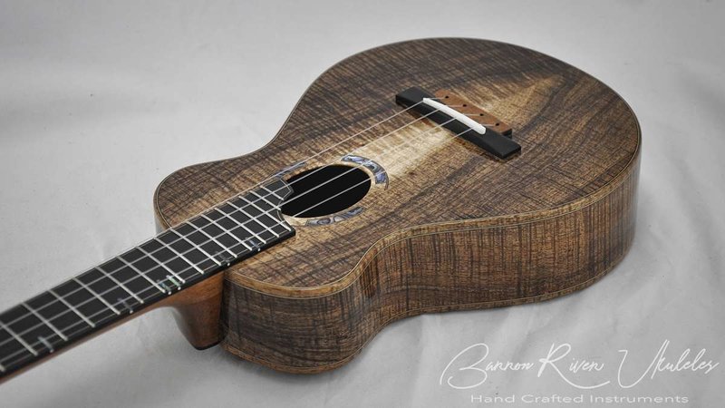

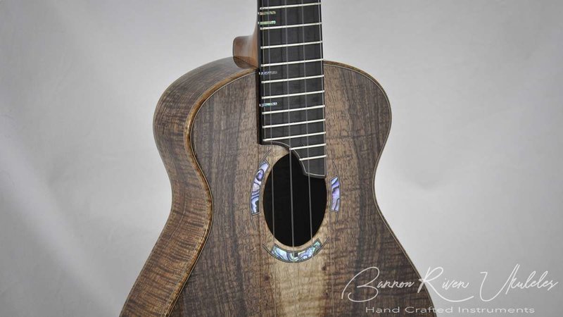

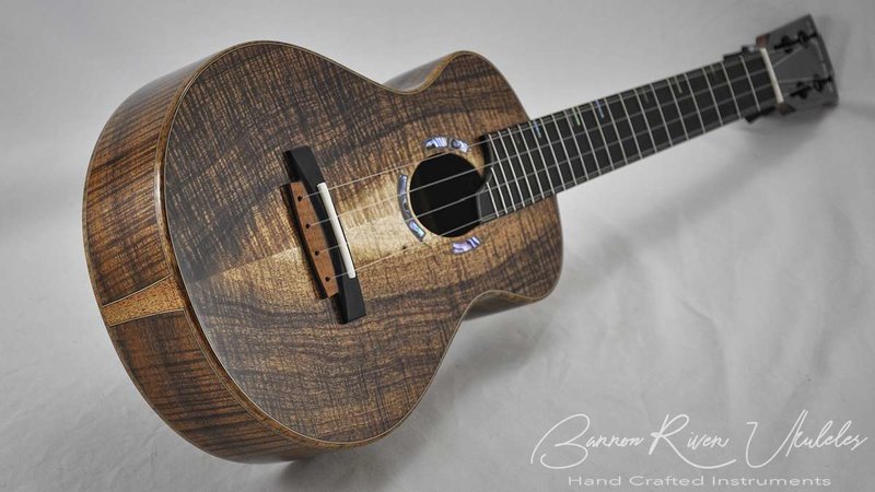

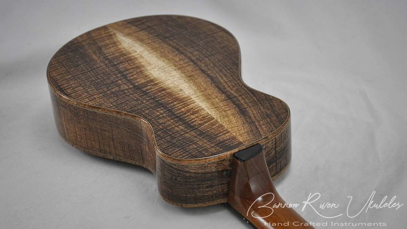

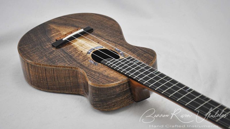

I've had some really amazing Blackwood put away for a spec build where I didn't have a client placing expectations or restrictions on what I wanted to create. It's impossible to capture in photos the way that this timber shimmers much like an opal under the light.
It's a 16" long neck concert with a 12" - 16" compound radius on the fret board. Australian Blackwood body and bindings. Finished in high gloss polyurethane.

Post by lamanoditrento » Thu Dec 07, 2017 1:40 pm
Beautiful! :cl :cl :cl I like the new asymmetrical heel. How are you liking the change to a bolt on neck?

Post by demonx » Thu Dec 07, 2017 2:22 pm
That looks great! Beautiful timber and attention to detail, excellent work!

Post by Mark McLean » Fri Dec 08, 2017 10:15 am
Amazing timber Allen - and beautifully used!

Re: Curly Blackwood Long Neck Concert Uke
Post by nkforster » Fri Dec 08, 2017 10:00 pm
Lovely instrument, lovely finish. Are you spraying the poly? How do you find working with it? Humidity must be an issue where you are?
