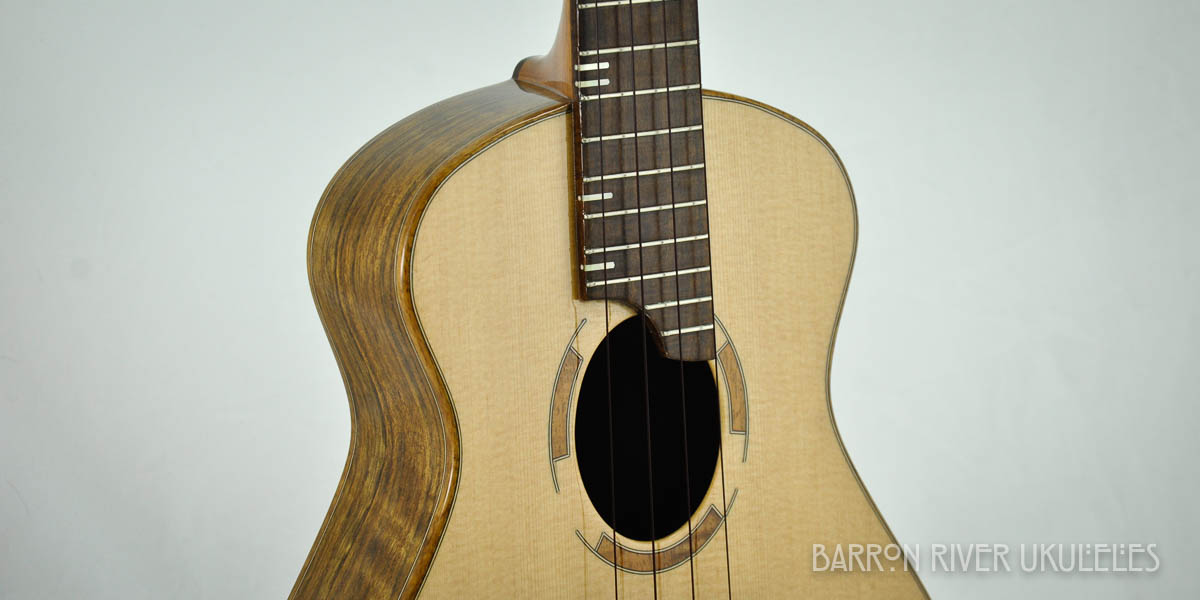

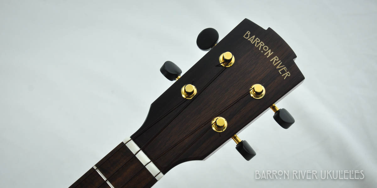

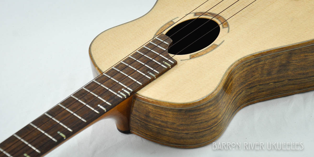

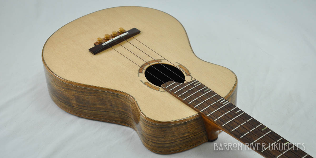

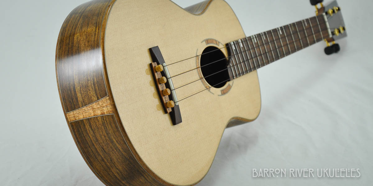

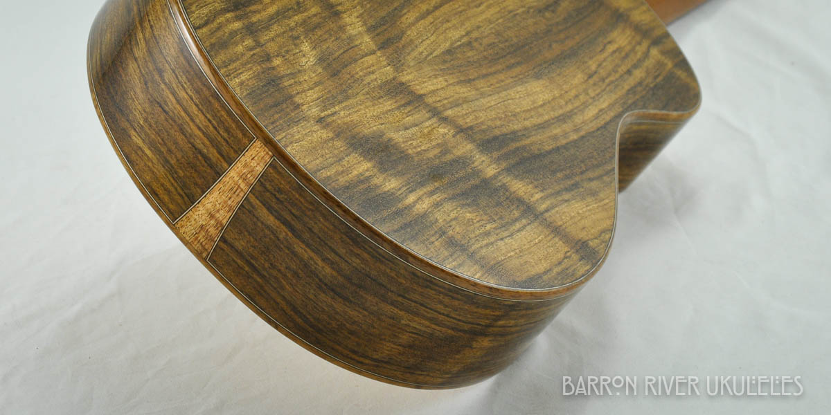

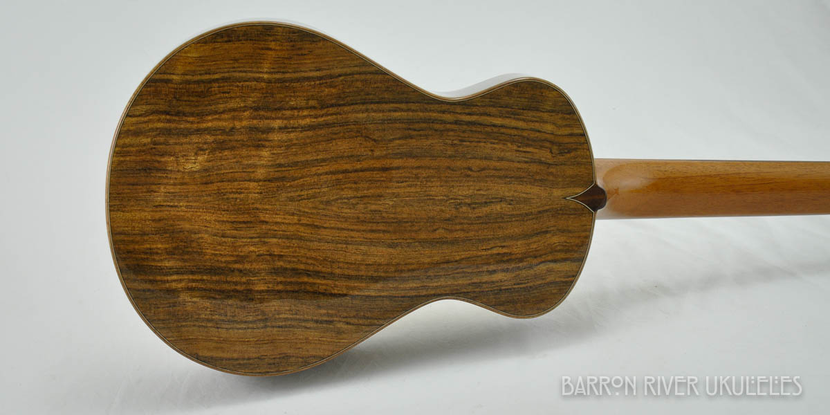

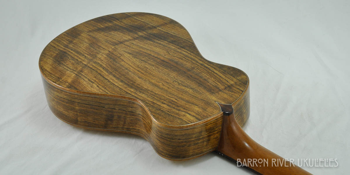

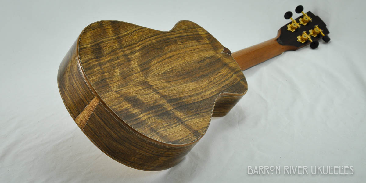

I'd never heard of Ovangkol before, but when I saw it on offer in the Buy Sell section knew I had to give it a go. Very beautiful figure in this set. It bends very easy, but has absolutely enormous pores that need a lot of attention if you are going to do a gloss finish.

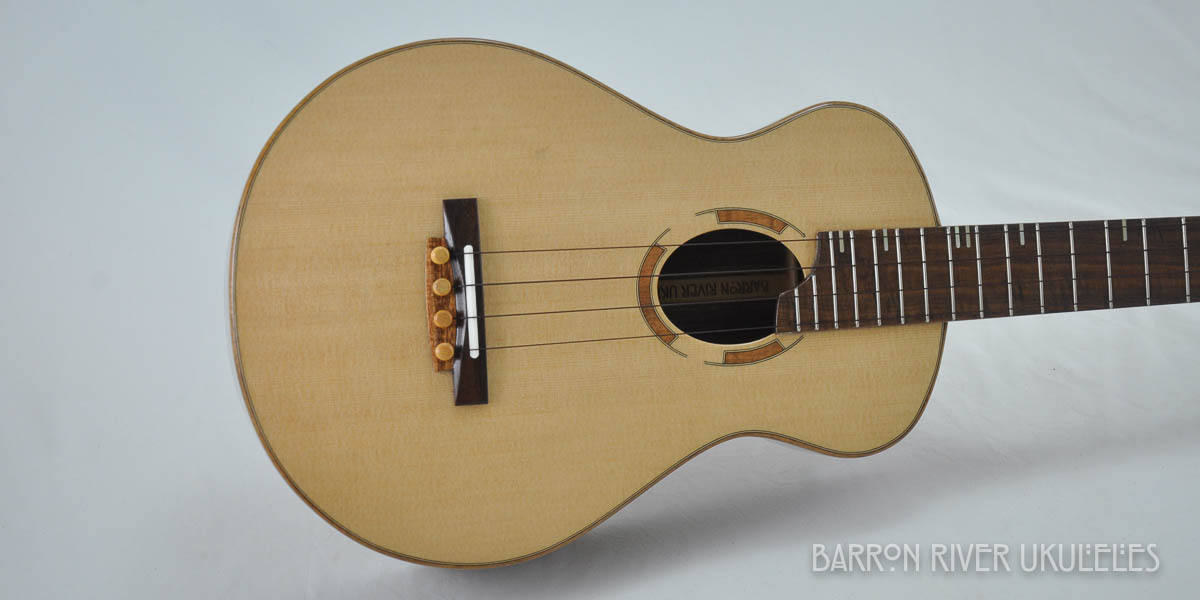

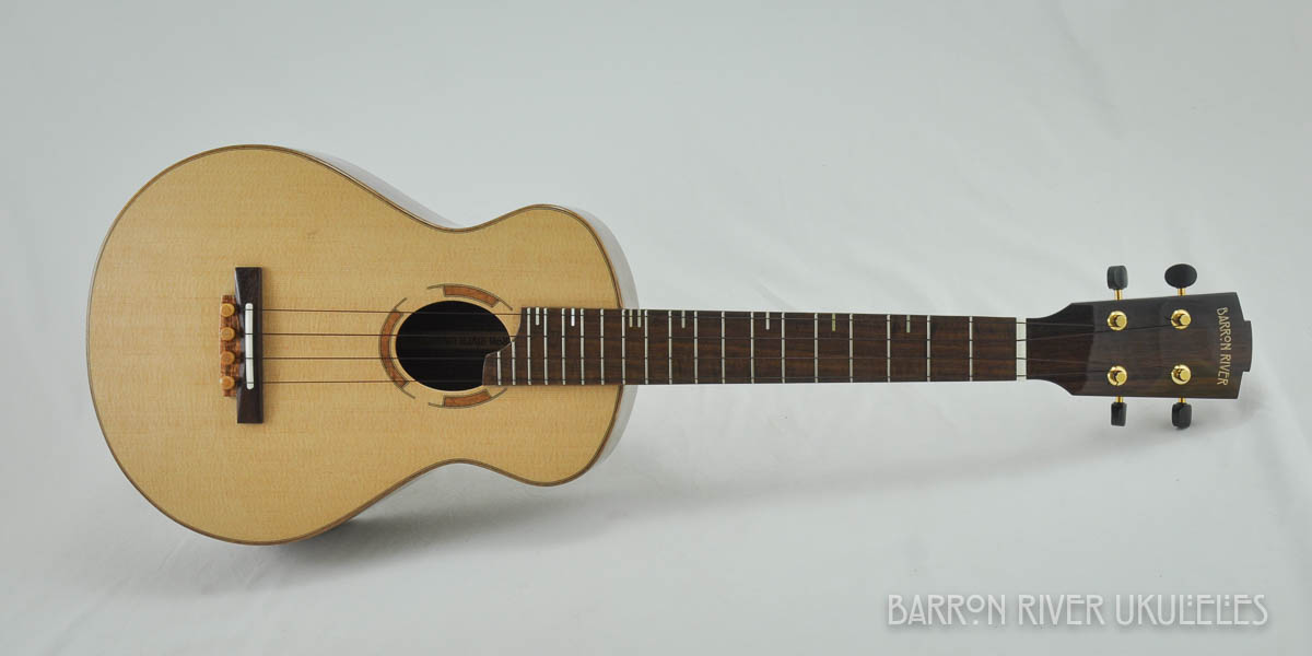

Sitka spruce sound board with Australian Blackwood bindings. Ringed Gidgee fret board and finished in high gloss lacquer.

Lovely, as usual Allen. That makes me keen on trying ovangkol at some stage too. How did you fill those giant pores? Was it epoxy?
Re: Ovangkol and Sitka Tenor Uke
Post by Allen » Wed Sep 13, 2017 6:14 am
Yes. epoxy, but it still took several sessions.

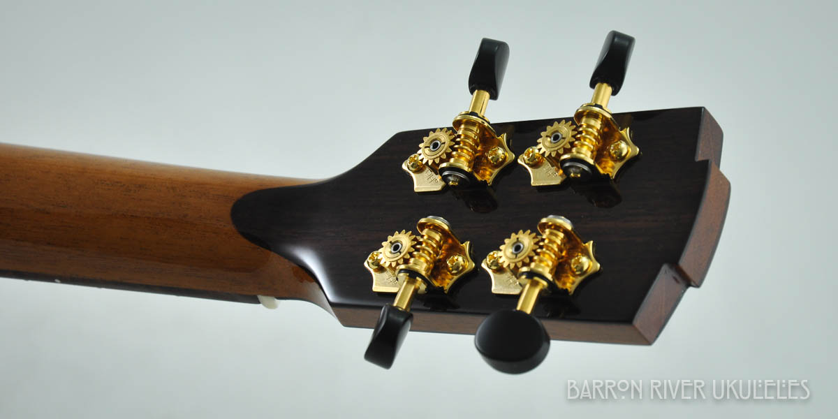

please give a lesson on how you blend the veneer on the back of the headstock so well into the neck, really schmick
