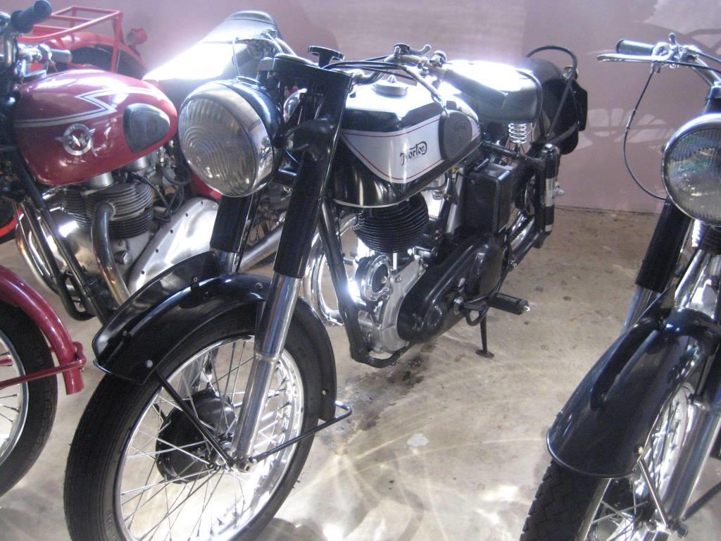

Personally, I'm interested in what motorcycle the trem springs come from....if it's a copy of a Brit icon guitar it should really be Triumph or BSA but I can't see any oil so maybe I'm wrong. :mrgreen: :mrgreen:

Yes , it's been a bit of a job tracking down the right information sometimes , Early belief was that they were the inner valve spring from a 1928 Panther motorcycle , however they are reported to be from a Norton motorcycle in Brian May's Red Special book , Page 35 .

Post by seeaxe » Tue Oct 18, 2016 6:46 pm
Ahhh, that explains the lack of oil then. Nortons were a bit less leaky! Only a little puddle under this one
