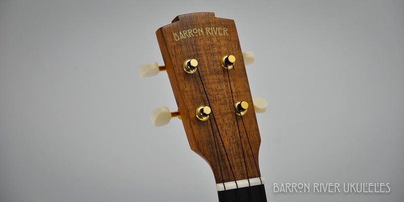

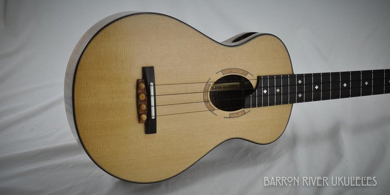

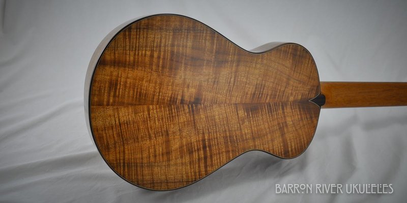

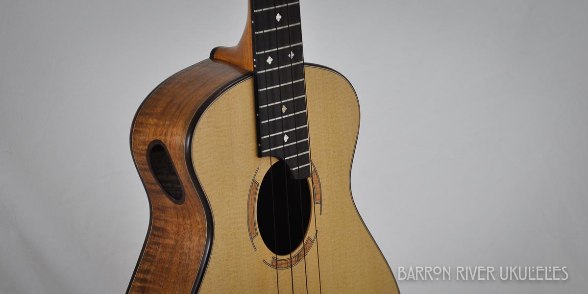

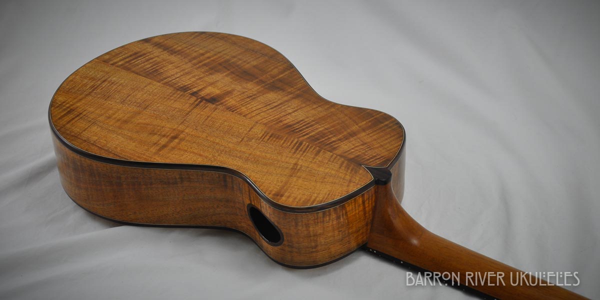

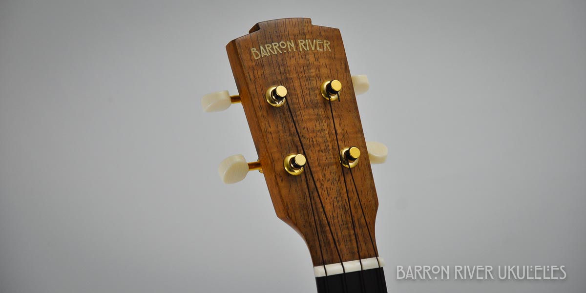

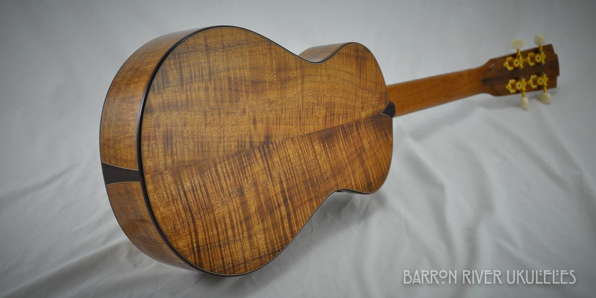

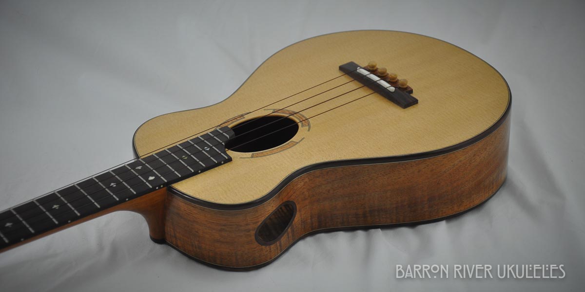

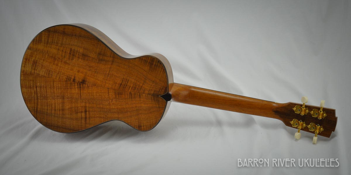

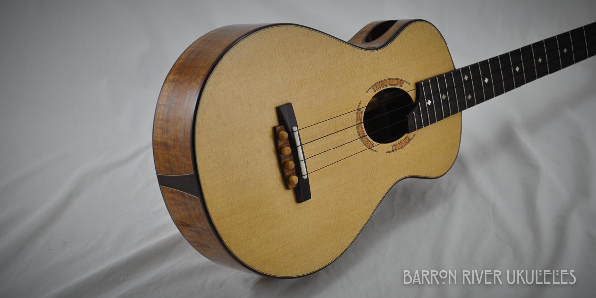

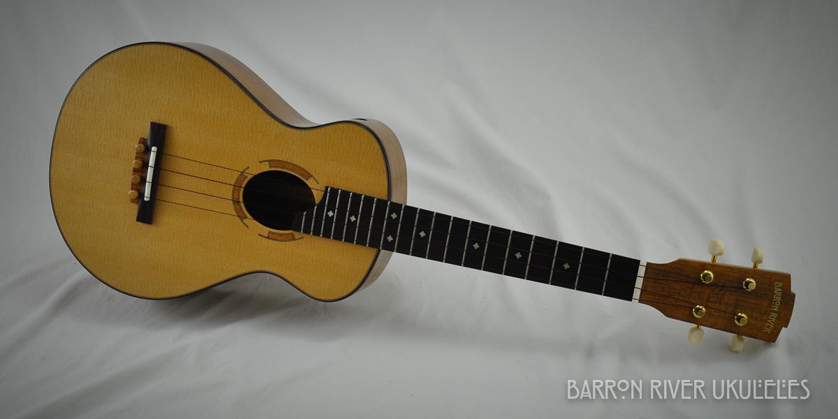

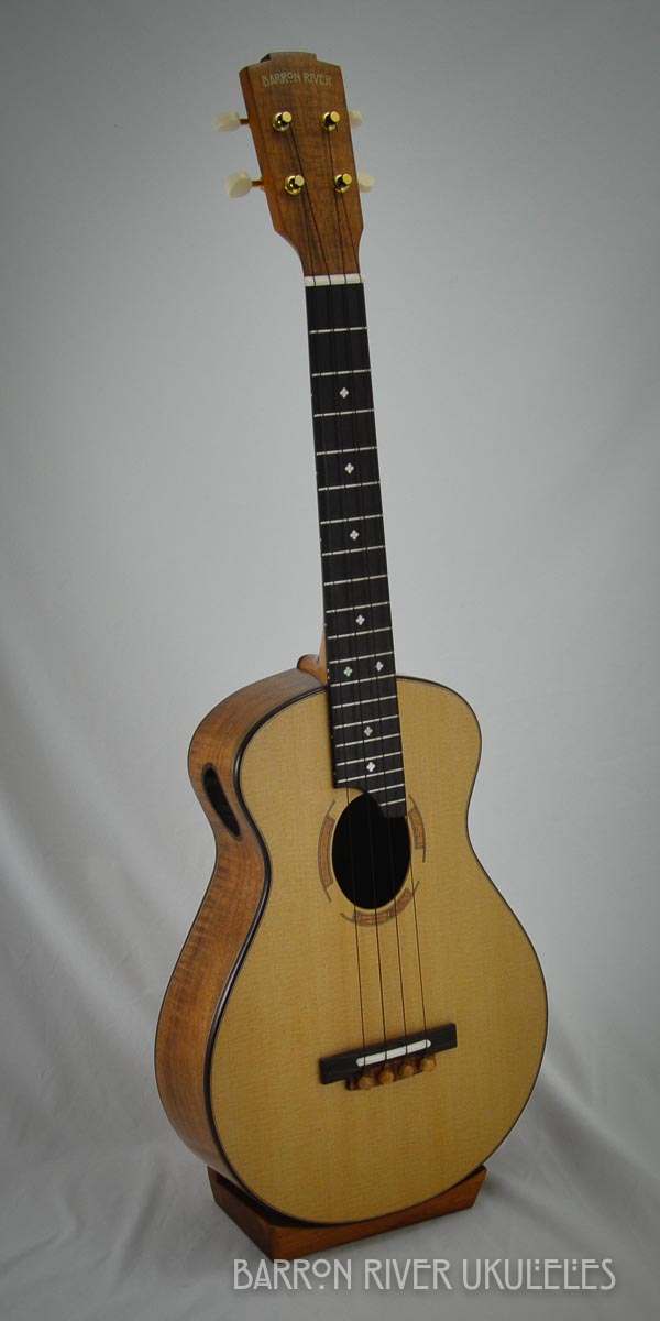

Another one completed and pretty happy with the result.
High figure blackwood with an extremely stiff Sitka soundboard. Indian Rosewood fret board with a compound radius.
Indian Rosewood and Blackwood trim, with a low sheen French Polish finish.
Gotoh machine heads and Worth Brown high G strings.
