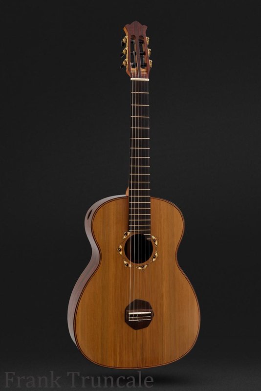

Hello Friends
Thought you might find something of interest or maybe provocative with my last build.
Named White Tara
Completed 6/16
Hours 200
Designer Frank Truncale
Type Nylon classical
Fret @ ub 12
Bracing 7 strut interlocking hyperbolic radial
Top wood Sinker Cedar
Back & sides cocobolo
Neck Honduran mahogany
Neck radius 20
Binding cocobolo
Bridge Brazilian Rosewood
Compensation nut and saddle
Nut width 53mm
Saddle 58
Scale length 650
Headstock open straight pull FET
Mass loaded 400g
Back live
Neck design BOBO
Pick up none
Ornaments Seven Eye rosette
Finish Shellac
Sound port yes

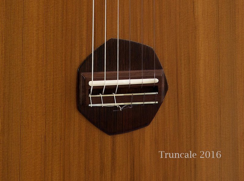

I was inspired by the work of Jurgen Meyer to make a guitar using a wingless bridge. To keep a functional gluing surface to the top I essentially condensed the typical area into a soft heptagram that is supported by an interlocking radial bracing design. The bracing was inspired by the work of Greg Smallman (lattice bracing), and Trevor Gore (falcate bracing) and the desire to incorporate an element of sacred geometry (Steve Connor).

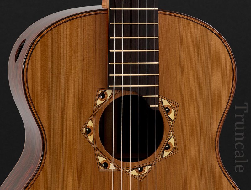

White Tara deity with seven eyes

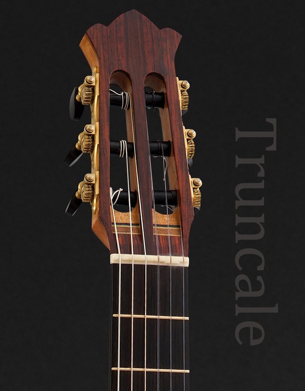

Semi Strait pull

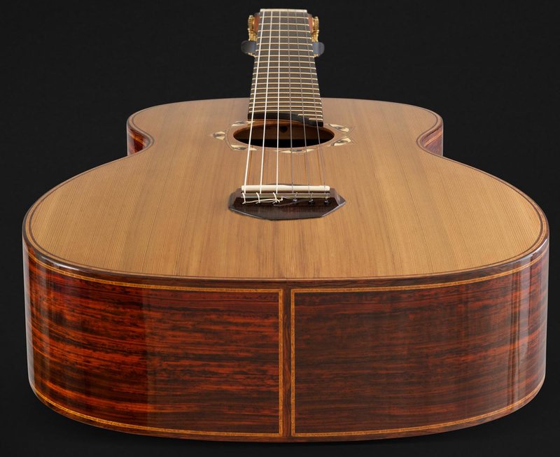

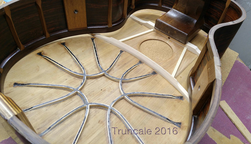

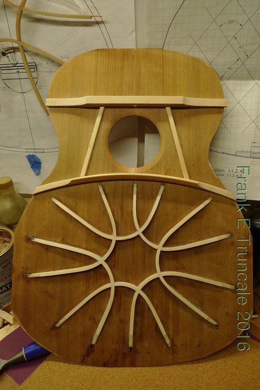

bracing arranged asymmetrically from bass to treble

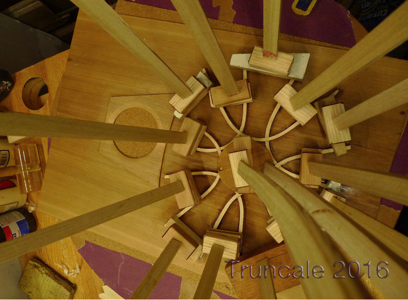

go bars this time vacuum to come

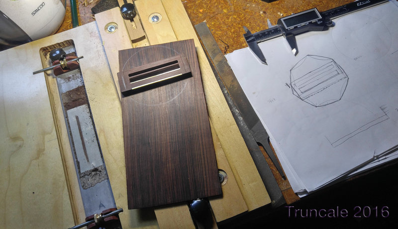

Bridge fabrication jig and drawings
Brazilian Rosewood, carbon fiber reinforced bridge in process.
curved and laminated LTB, carbon fiber applied.

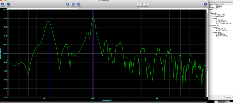

T(1,1)1 107.5 T(1,1)2 202 T(1,1)3 239

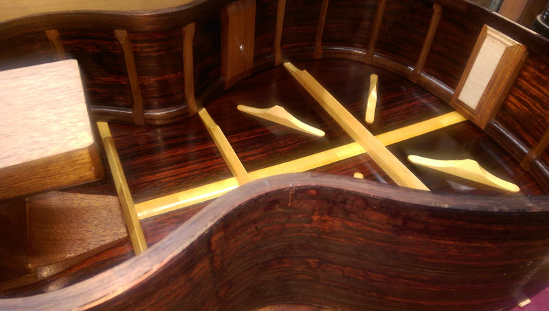

Bent and laminated indian rosewood linings, both sides. Kind of over kill

How did you come up with the bracing concept? I can see the obvious influences of falcate and lattice bracing patterns. My first impression is that it might be more bracing than needed? It would seem to be a lot more bracewood than in a "standard" falcate pattern as per the G&G books - but that would depend also on the height of the bracing of course. Does it feel like a stiff top, or have you done any deflection testing? I guess the weight of the bridge is less that usual which will be another factor affecting the top performance.

How did you manage the straight string pull with 3 on a plate turners? Is it a slight inverted angle of the headstock sides and re-drilled sting holes?

Thank you for you interest, comments and questions. I’m not sure how to answer the question of how I came up with the concept but will give it a try.
I am attracted to the strength and density of lattice bracing, yet there seems to be a signature sound that is sort of grainy or mechanical. I hypothesized that perhaps it was because of the squares that are made. It is my notion that the underlying mechanics of a square and the way in which it controls the top is what is responsible for the sound we associate with a lattice. What became most fascinating to me about lattice bracing was actually the interlocking bracing.
Lutherie is the study of nature. We study the nature of material, the nature of sound and the nature of perception. Anyone who has studied the concept of the golden mean understands nature does not willingly divide into fours. Music itself is based on thirds, fifths, sevenths and ninths. Most of our hero luthiers use these concepts in their designs. I am drawn to an aesthetic that inherently employs some of the chaos of nature rather than trying to control it with a box.
Falcate bracing inspired my imagination. Does a strait line in nature really exist? Light even bends around objects. On a guitar, the one thing that could be truly thought of as straight is the stretched string, yet it is the oscillating string that powers the instrument. The defiance of the straight line could arguably be the basis of the whole concept of a guitar. These musings make the notion of curving braces seem quite attractive on an artistic, metaphysical level.
As a luthier I strive to create powerfully inspirational tools for creation. However serious that might seem, guitars are also about play. I think that being playful with the design can serve the evolution of the instrument. Being playful does not come without risks. The White Tara was a 200 hr, $700 experiment. The sound of the guitar is quite lovely. The tone is rich and lush, with the definition and clarity that you might expect from falcate bracing. It also has an even tone with plenty of sustain. I’ve included a sound sample, so I’m interested in your perceptions. My playing, ugh, please overlook my stumbling about.
https://soundcloud.com/frank-e-t/whitetara-guitar-demo
I do think I underestimated the strength of my bracing (Sitka 5mm wide about 5.7mm high in center). Looking at the modes you can see they are fairly high, even with the use of lots of mass in the sides. The bridge weighs in at 15 grams. Top thickness is to G&G book for classical (60), about 2.2mm . Bridge rotation is maybe 1.5 degrees. The amount of bracing (not talking height) really isn’t that much more than a 7 strut fan, certainly less than the Fleta. Even though the guitar has been described as lively, no one would say it is a loud guitar.
I’m currently working on a steel string with 5 interlocking braces and the wingless bridge. Please, any ideas, observations and comments that would help with my next build would great.

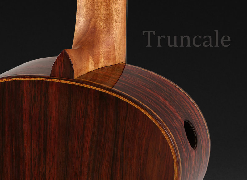

End Graft

Hi Jim
I see the bridge and bracing as a system, a single innovation. No point in using the bracing with a traditional bridge. The wingless bridge on x bracing or traditional fan doesn't seem practical. It succeeds in being a good first try. I think it's true character will expose it self as I start building lighter. I have some suspicions about what is going on and how it works, but need to do some chladni testing to get a more realistic view.
