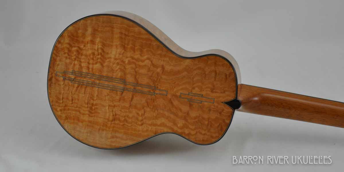

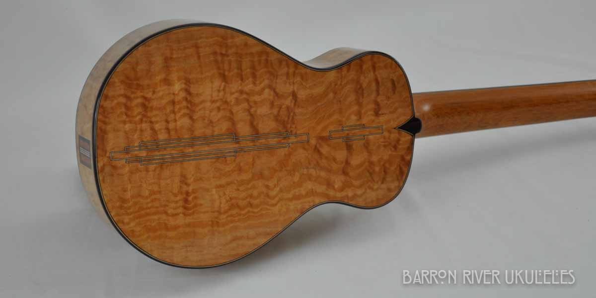

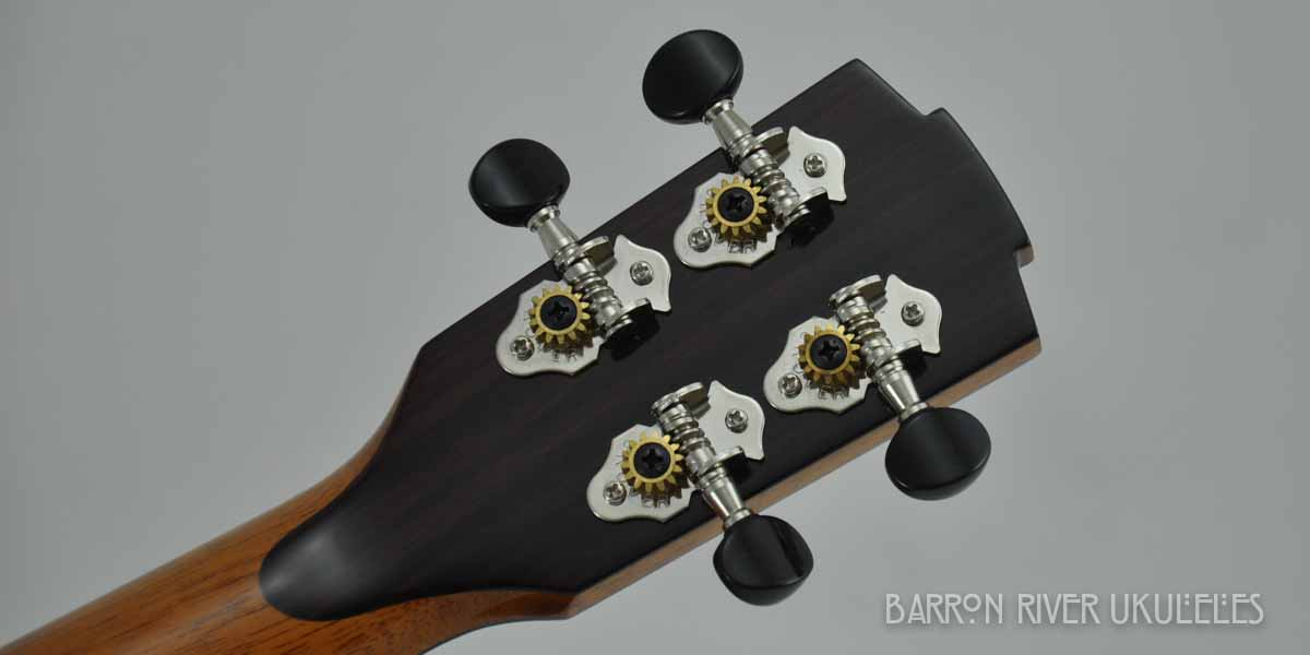

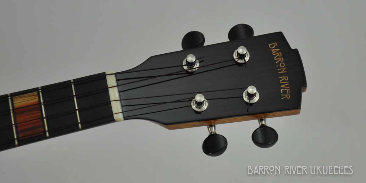

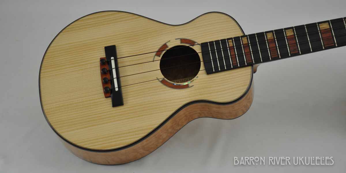

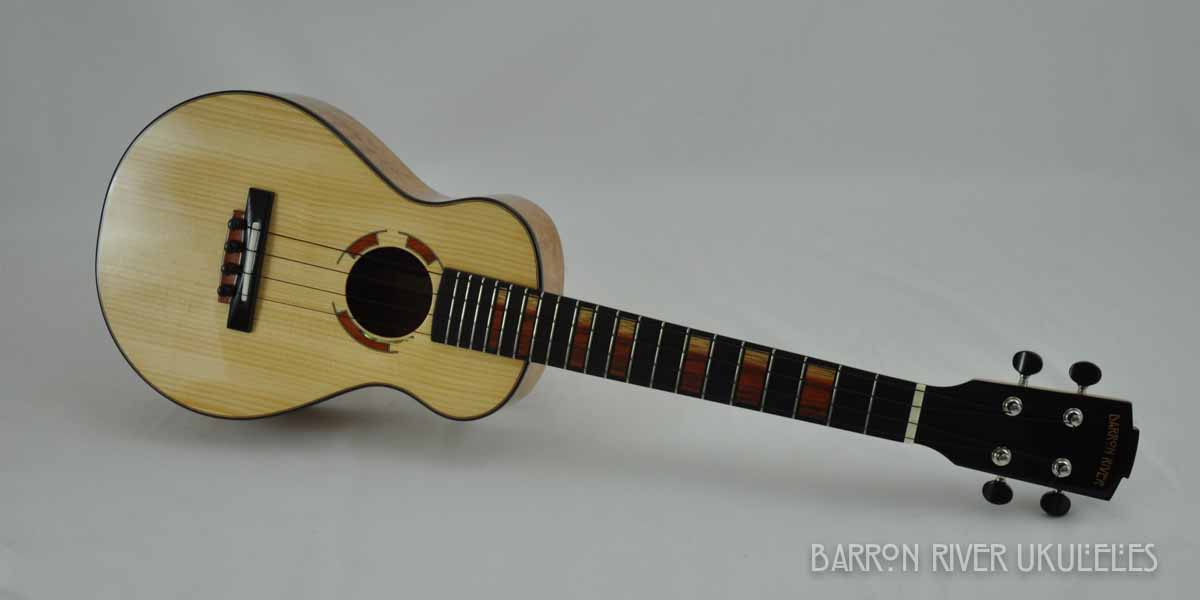

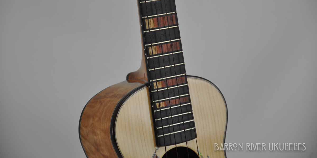

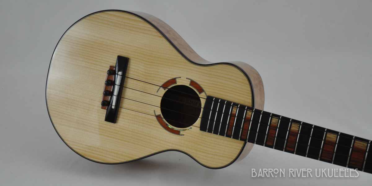

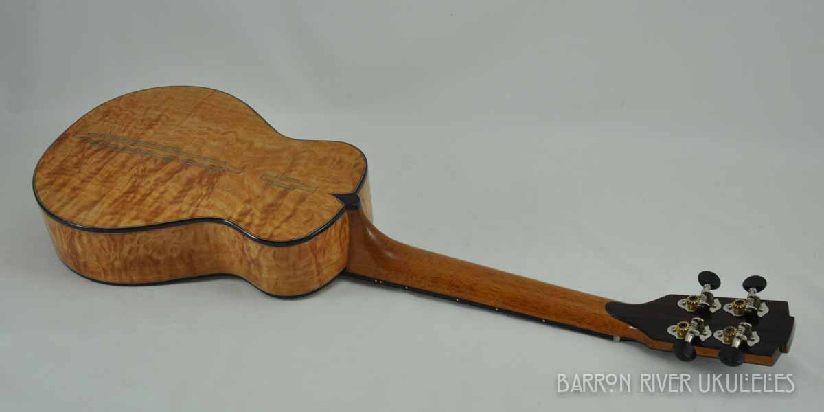

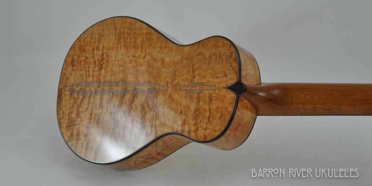

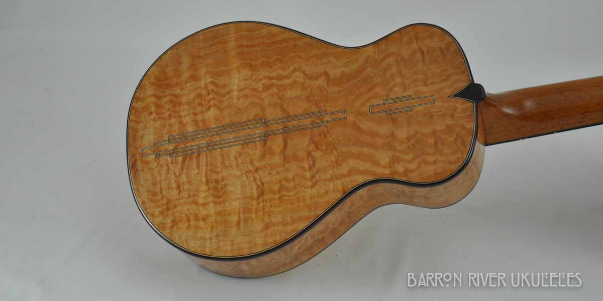

Post by Allen » Wed Feb 03, 2016 7:54 pm
This one is the last of a batch of 3, but in high gloss. Always takes much longer than satin.
Back and Sides - Quilted Maple
Soundboard - Red Spruce (Adirondack)
Fret board - Indian Rosewood with 12 - 16" compound radius
Scale length - 16"
Bindings, Head Plate Veneers, Bridge - Indian Rosewood
Inlays - Hormigo
Tuners - Grover
Finish - High Gloss Lacquer
Strings - Worth Brown low G

Oh yeah that's what i'm talking about,,,shit hot the lot! Love the position markers too Allen they're insane.

Wow, brilliant of course, but those position markers, hmm... might have to rethink some things now. wow they're nice
