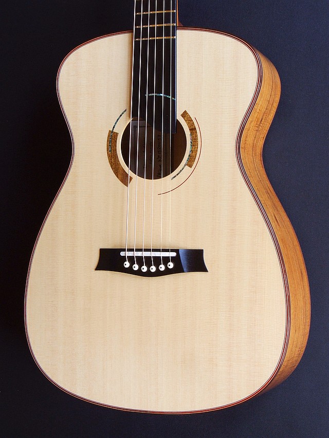

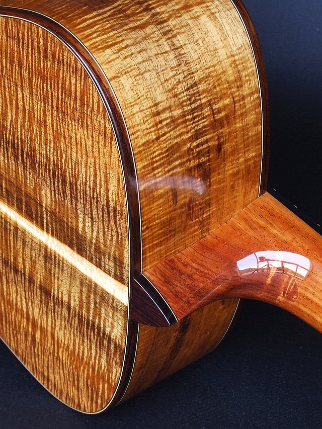

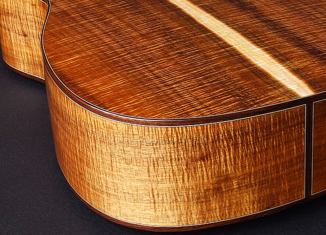

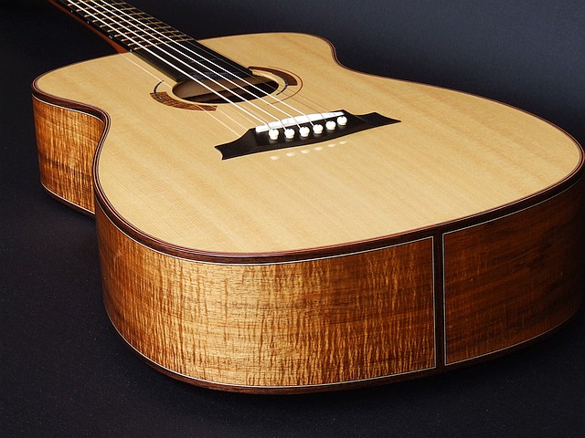

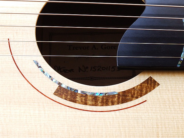

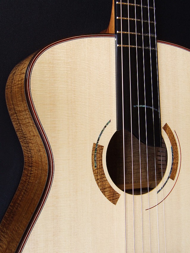

This one is a departure from standard stying, having a touch of deco about it, with frets stopping at 15. It's on my neo-classical chassis which I frequently use for steel string guitars and is ~ 00 size.
Top is Lutz, back and sides are high figure blackwood from Pete (Curly Timbers) and Jeremy, wedge body, ebony fretboard, EVO frets, New Guinea Rosewood 14 fret neck, ebonised walnut bridge, bloodwood purfling, Gotoh tuners and the usual falcate bracing, nut/saddle compensation scheme, side mass facilities etc, etc. The rosette is matching blackwood, paua abalone and the bloodwood line to go with the purfling. The finish is non-pore filled hard shellac on the B&S (which I call semi-gloss, but there's not a whole lot of semi about this one!) with the neck in gloss nitro with epoxy fill.
According to its new owner "Looks gorgeous, feels fantastic, sounds amazing - a lovely rich zingy bass and that magic something in the midrange that I think of as the soul of the instrument."
Merry Christmas to you all!

What can I say? Absolutely gorgeous Trevor, it's no secret I'm a fan of Blackwood and those pieces are exceptional (well done Pete) ! The rest looks a thing of beauty as well, and to have the sound to match?!.....one lucky customer. :cl :cl :cl :cl
Was stopping the frets at the 15th the customer's choice or something you dreamt up? It 'finishes' the instrument. That's a fairly subtle wedge too :)

Nick wrote:Was stopping the frets at the 15th the customer's choice or something you dreamt up?
kiwigeo wrote:Um....er...Trevor. I think you forgot to finish the fret job :(
Customer request. Inspiration from the Santa Cruz Otis Taylor model.

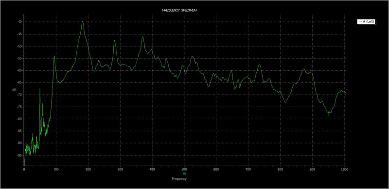

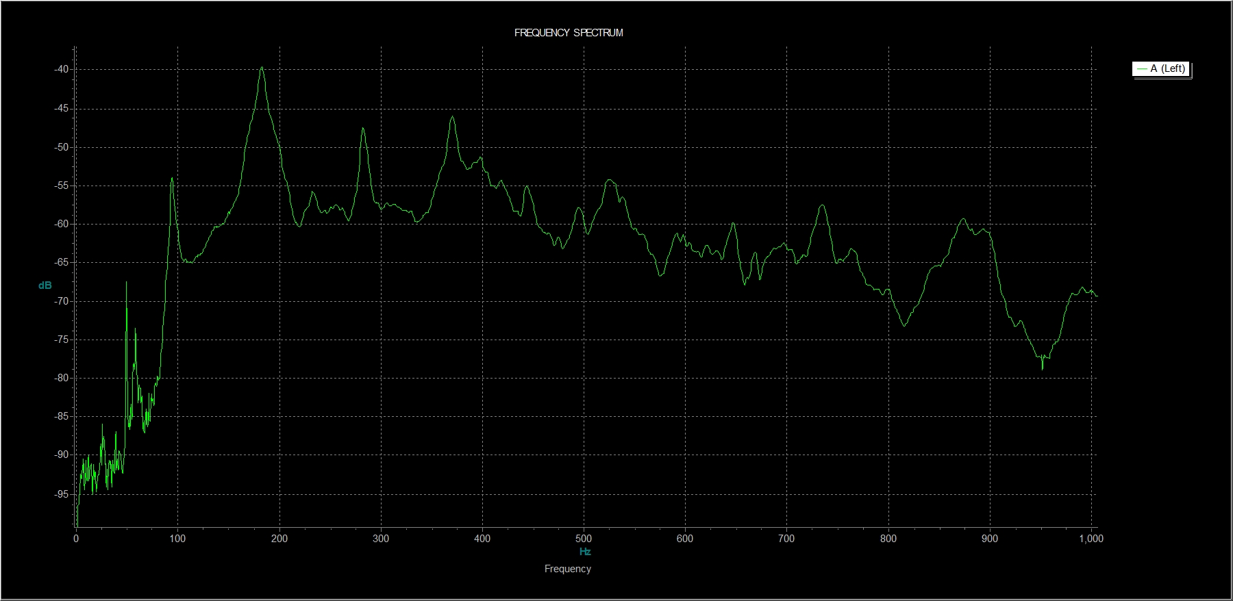

Trevor, any chance of a VA FRC plot for this beauty? TIA
Trevor Gore
Posts: 1643
Re: Small body (Neo) SS, with a touch of deco
Post by Trevor Gore » Sat Dec 12, 2015 10:23 am
Here ya go...
95,181,230. The live back is having the affect of dropping the T(1,1) but because of the wedge, I think the pressure wave doesn't build in quite the same way to drive the appearance of a strong T(1,1)3. Speculation, of course, as I didn't do enough testing to definitely prove that.
