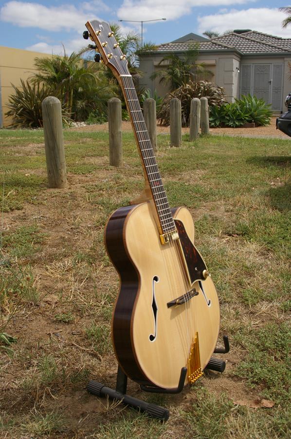

I've just finished my first archtop. It was a real learning experience, and was a lot more difficult than I was expecting, I'm pretty happy with the result but there's room for improvement that's for sure.
B/S EIRW
Top Lutz

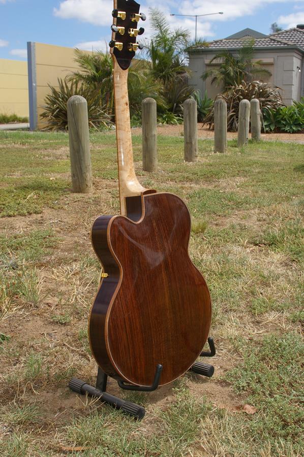

Birds eye maple neck. By far the hardest timber I've used on a neck.
Ebony f/b
African b/wood bridge
Curly koa bindings
Ebony head plate on the front and African b/w on the back
Schaller tuners

Great work there Wayne......what's the finish?

Thanks Alan, Martin, the finish is Miritone lacquer.

Excellent job Wayne for a 'firsty', what style of bracing did you go with (X or parallel) and have you achieved the tone you were after?
What is the brand of tailpiece? I know Benedetto used one in a talk he gave and did name it I think but it's been some years since I watched the DVD.

Thanks Nick, it's x braced. Tone is pretty much what I was after but I really haven't had much to do with archtops. The guy who ordered it supplied the tailpiece, I don't know the maker, it's German made, but it came from Allparts. Wayne

She looks a honey!
only ever played with birds eye maple veneer, solid would be something else
Shaping the neck would of been tough going!
lots of file work?
polish looks great

Nice job Wayne. The neck looks especially awesome

Looks great Wayne! What was the hardest part (apart from the neck!)

Martin, I think apart from carving the neck, fitting the neck was also a real challenge for me, I've never done a dovetail before and I cut this one by hand. I have another one to do for the same customer ( parallel braced this time ) so I'm going to make a router template to do the dovetail this time ( any info on the sizes for the template would be welcome ). Wayne

Nicely done! Hand cutting and fitting that dovetail is probably the trickiest part of an archtop build.

Bloody nice job there Wayne, blown away by the maple neck, awesome figure, how was the rosewood to carve? lovely combination, the subtle contrast of the rosewood/maple,lutz. Beautiful axe,,,

Thanks rod, the rosewood was good to carve, it was easier than I expected. The maple was tough though, and I have 2 more necks to make with it. Wayne
