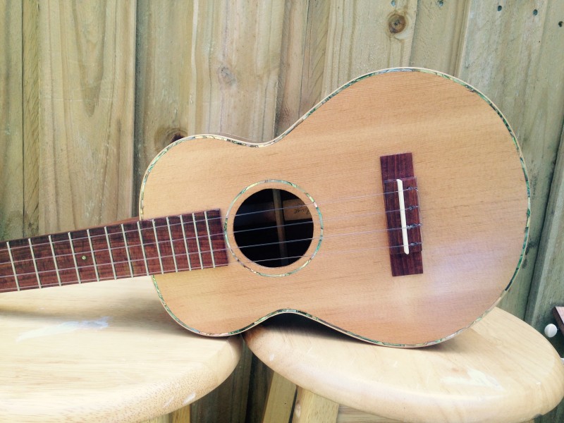

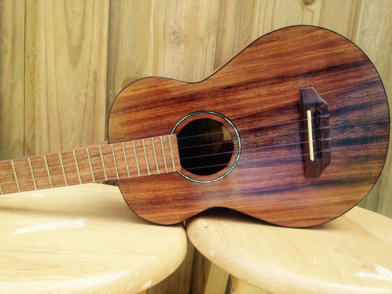

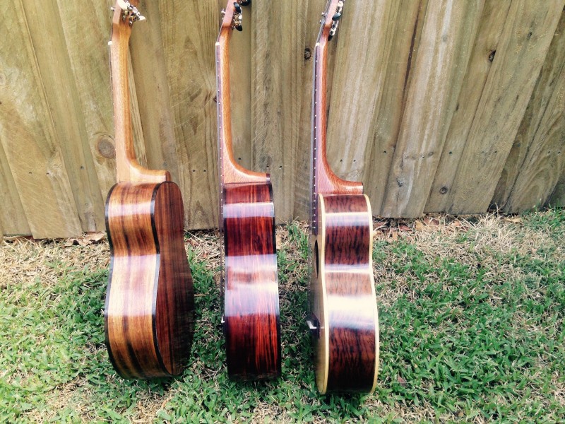

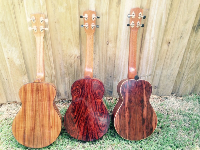

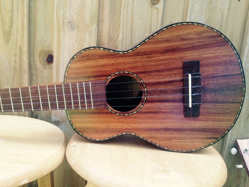

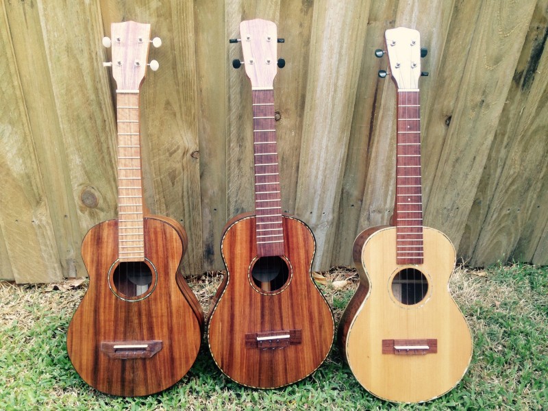

It has been a while between drinks, in fact over a year since I posted my first build. I managed to get into the shed and build these 3, one after the other. I made so many mistakes on each of them, I wouldn't be able to list them all, but came up with fixes. The mistakes will be obvious to you guys, but I don't care as I am still learning. They are all braced differently or are different in some way, but they all sound pretty much the same, which surprised me a bit. My first build made from native olive and spruce is the only one that sounds appreciably better, due to the spruce I think.
Number one is an all Blackwood with ebonised Silkyoak bindings, Qld maple neck and abalone rosette.
Number two is a Tiger Myrtle with Douglas Fir soundboard (I think), maple bindings, abalone purfling and Silkyoak neck.
Number three is Cocobolo with a blackwood soundboard, unknown bindings and rope purfling, Silkyoak neck.
All finished in tru-oil, all Tenors.

What is the fingerboard timber on the all blackwood one?

That tru oil finish is magnificent (pic 2 and 3) You must know something I don't in relation to the application of it.

I think it might be Wandoo, I bought it ages ago from TimS, and am not positive.

I put on lots of coats and rubbed it back in between with a scotchbrite, like other finishes. The last 2 coats were put on very thin, I just put a few drops on the surface and used a brush dipped in a little turps to spread it, didn't seem to leave brush marks.

Great looking set of ukuleles. How does the fir top sound compare to the blackwood?

Thanks - I was just playing them this morning and the fir definitely sounds better than the blackwood, it is louder and has more sustain.

Did you do the ebonising of those bindings? If so, which method did you apply?

Thanks and I did ebonise them myself using the usual technique of steel wool and vinegar - they only took a few hours to go that colour.
