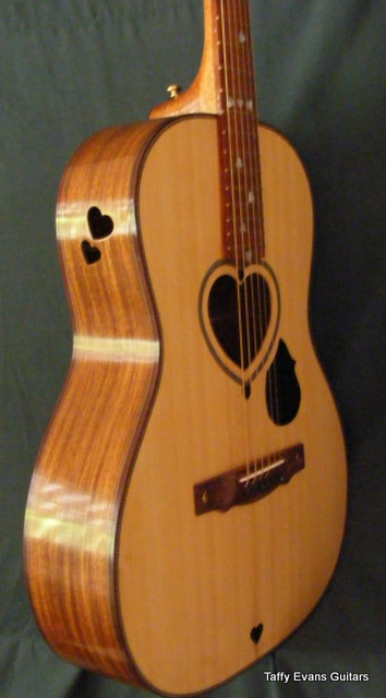

Here's a guitar that's been received well by musicians and others who have seen and heard it.
I wanted to build something special, something different, something that would give me a different challenge. I gave myself a list of criteria that I wanted to follow these were as follows:
1 -I was asked to do something special, something that would stand out.
2 -I wanted hearts to figure in the design
3 -And the words or numbers "50" were to feature somehow in the guitar build
4 -The "000" style guitar was to be used
5 -Use some local [goldfields timber] where possible
6 -Besides looking special it of course had to have a good tone.
7-And lastly I had a finish date that would make it one of the quickest builds I have undertaken [That's quick by my standards] As it happened the delivery date was moved, and as I had finished by the said deadline I had a chance to play the guitar for a while.

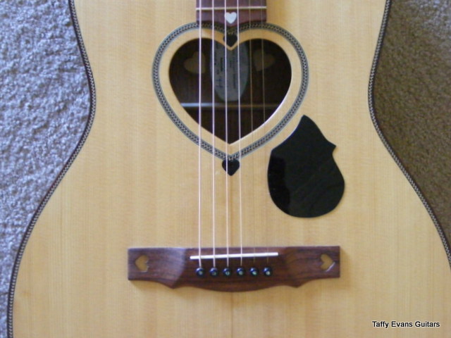

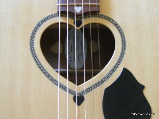

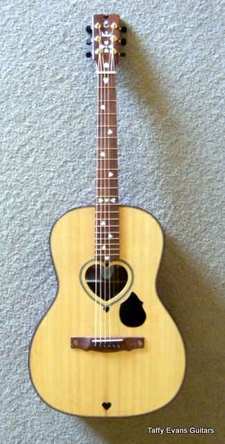

1 - I researched guitars with heart shaped soundholes but could only find the two that I already knew about. Eric Clapton's "Ivan the Terrible" twelve string guitar, and though not a true heart shape, a guitar, also a twelve string, played by the late Pete Seager.
I had tried to have a guitar built for me many years ago with that shape sound hole, but the maker declined. So planing/designing this guitar was down to me.
2 - Why hearts? well I thought that if I have a heart shaped soundhole, why not make hearts a feature of the guitar.
3 - Why "50"? At the time of starting this guitar I had been in Australia for 50 years, and next year my wife and I would have been married 50 years. So fifty hearts it was going to be.
4 - Why "000"? why not? I had made some nice sounding "000"s and hoped this be as good as it's predecessors. Its possibly better.

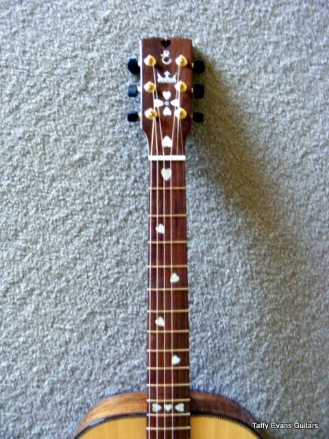

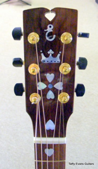

5- Local timber. This came from two sources. The peghead overlays are from timber savaged from a local hotel built in the 1800's and burnt down in the mid 1990's. These were used with the dried open grain and shakes still visible, very brittle and a worry to inlay and work. The other is Emu Apple and is used for the fingerboard. Gold frets and gold tuners with ebony buttons finish of the look well, I thought.
The inlays are MOP, ebony and maple.

That's bloody nice Taff,, the sound hole purfling,, done by hand or some machinery?? very nicely finish axe though, congrats!

Rod, rosette done by hand

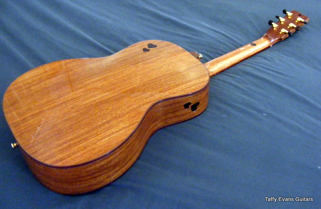

Markus, there are 50 hearts in all. The back is 3 piece so reinforcing over the two glue seams are heart shaped, also includes soundhole and the two side ports.

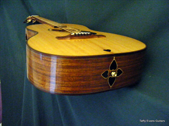

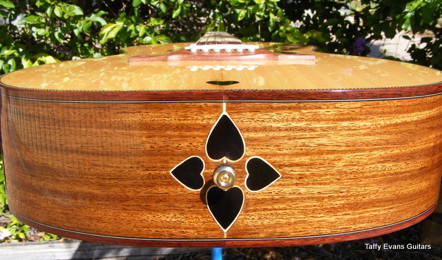

I could get sneaky and not tell of some of the hidden hearts that may not count in the 50.
! - The black heart [ebony] in the back of the neck has a white heart [rock maple] at the front under the fingerboard. The ebony was not thick enough to go right through.
2 - The black hearts at the endpin are inlaid into white hearts which were then trimmed back to leave the fine white outlines.
Now that's another 5, :? :roll:

Yes Taff i thought that might have been the case due to the inconsistent profile of the heart shape,i had a similar task recently although not as ornate where i ran some violin purfling around a margin of an oval sound hole in an arched soundboard, using a purfling cutter , knife and pick, pretty hair raising!
