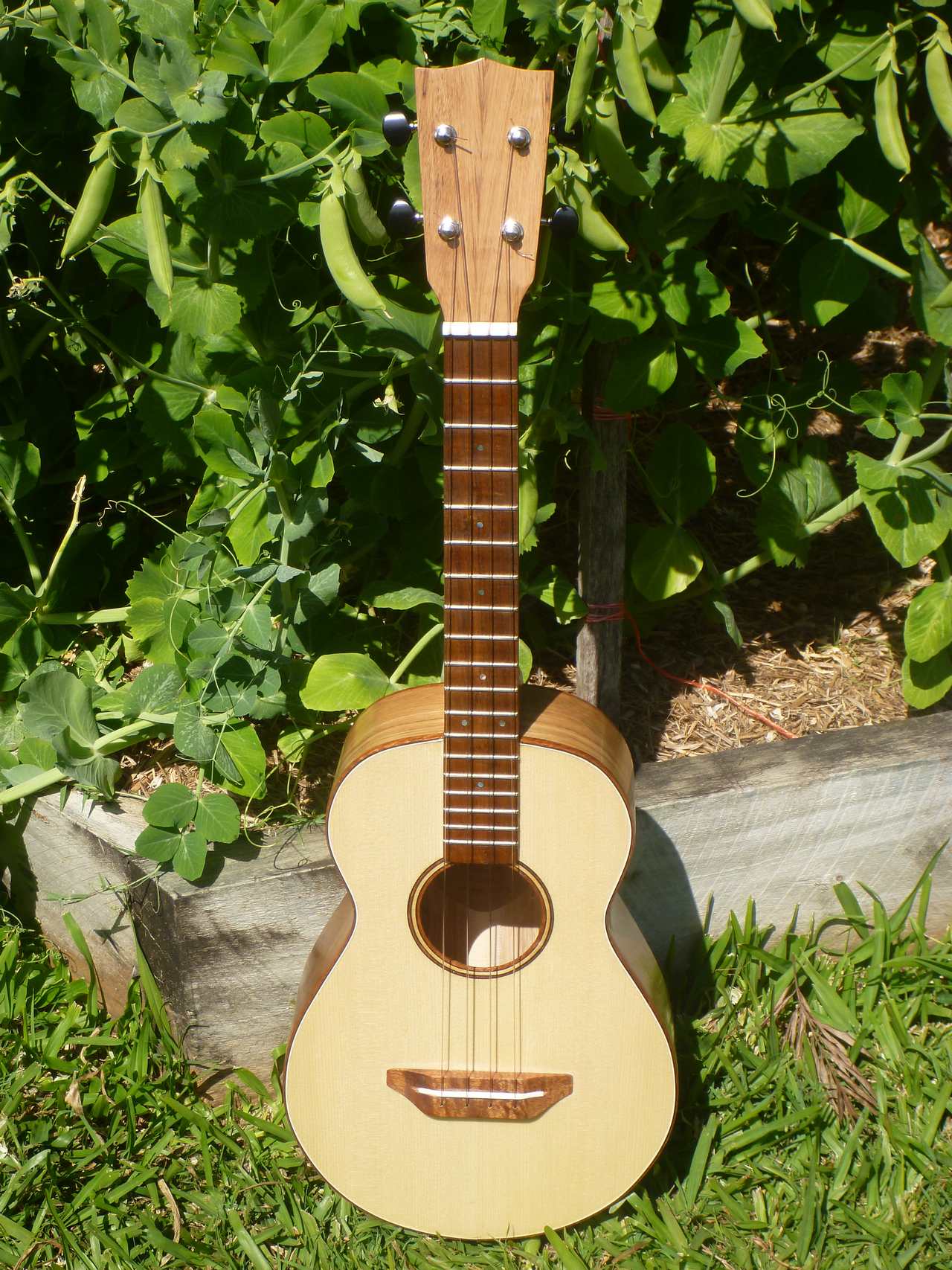

Hi

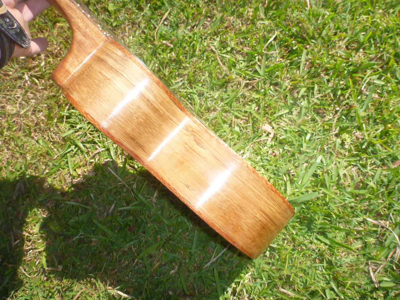

This is my second instrument, which went a lot better than the first, but was not without it's problems. Nearly all of it was put together with HHG apart from the fretboard and bindings; I really liked using it and didn't even use clamps for most of it, will definitely use it again. It is built to Allen's spec's he posted for bracing and soundboard thickness etc - thanks Allen.
It still needs to be set up properly, and looks like a new bridge will need to be made, so I can get a low enough action (not sure how thin I can go on the bridge). I made a mistake when I made the plans and calculated it with a 6mm fretboard when it should have been closer to 3mm :cry: I also cut the sound hole way too big and had to add a few rings to make it look right, that's why it has a bound soundhole :? I need to pay more attention to sanding as well, it looked perfect with out a finish, but in the sunlight it is obviously not good enough.
Sorry for the average photos - I am hopeless behind a camera.
Back and Sides - Native Olive
Top - Sitka Spruce
Fret Board - Blackwood
Bridge - Blackwood
Bindings - Silkyoak
Rosette - Silkyoak/QLD maple
Neck - Qld Maple with CF truss rod
Tuners - Grover
Finish - Tru-oil
Strings - D'Addario EJ87T Titanium
The next one will be better again hopefully.

That's a beaut uke Col !!! & a healthy pea patch, both winners.

You are a bit hard on yourself Col !! that is a cracker instrument.
wood combos are great!! well crafted indeed. bring on the next one!!

It bent easily, but it went black as buggery and I had to soak it a couple of times in a bath of oxalic acid to get it right again - I think I may have used too much water when I bent it. It didn't clog the sandpaper too badly as others have suggested.
