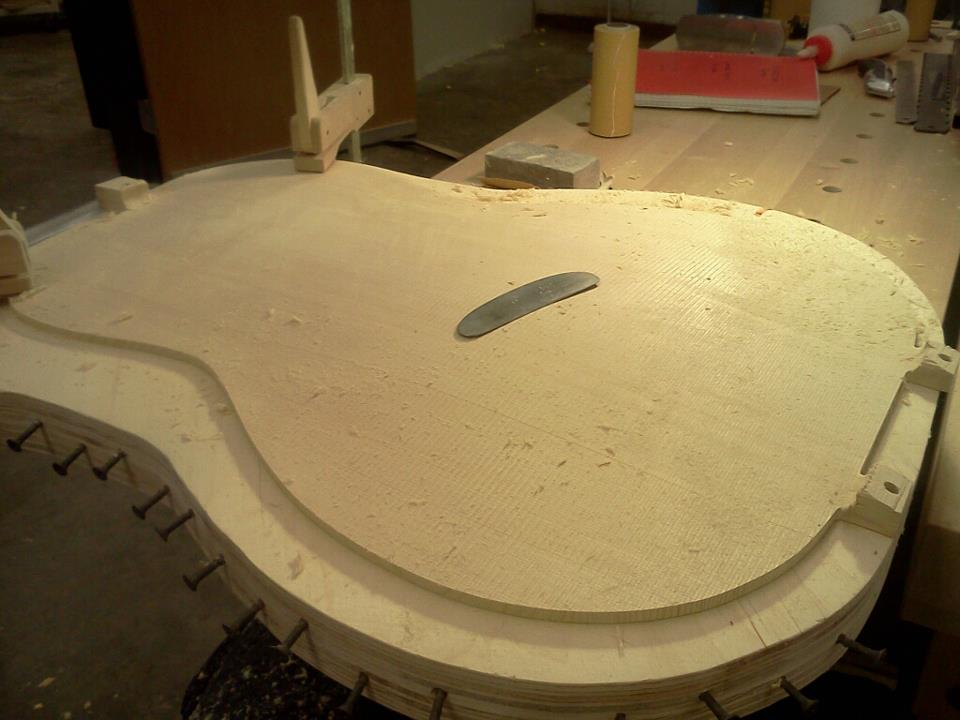

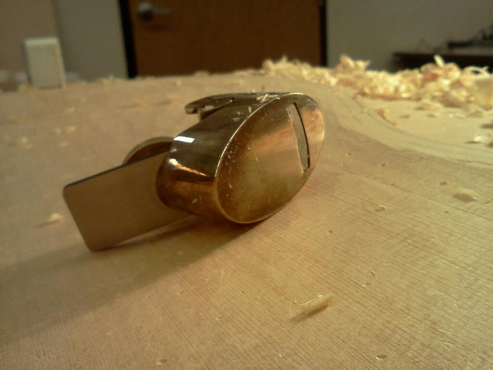

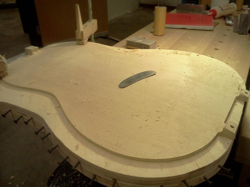

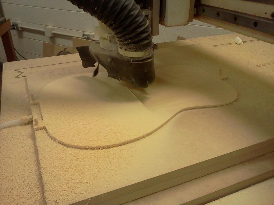

Well now that I'm all moved in and have internet access again I thought I would throw up a few more shots from the build progress (and reveal that I've cheated just a little with a CNC). Turns out I didn't take a whole lot of shots! I must have been trying to get the thing finished. But I didn't get off too easy, the inside and all the final graduations of the top had to be done by hand since you can't really trust the CNC to carve the inside; the fixture holding it to the table works by suction and as the top loses thickness it really begins to flex.
Really bummed I no longer have access to that machine now that school is all over done with. All the jigs I could make, all so accurate!

Also visible: what happens if you forget to turn on the dust collector. :lol:
