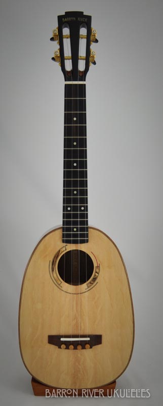

Post by Allen » Mon Jun 10, 2013 6:49 am

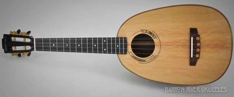

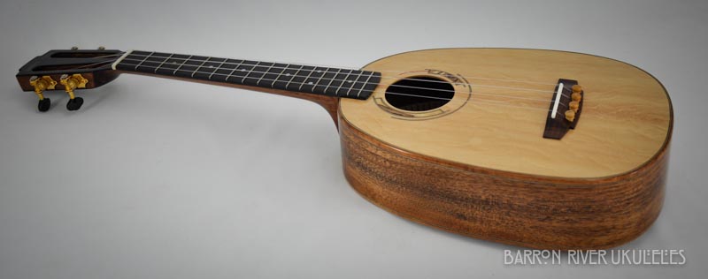

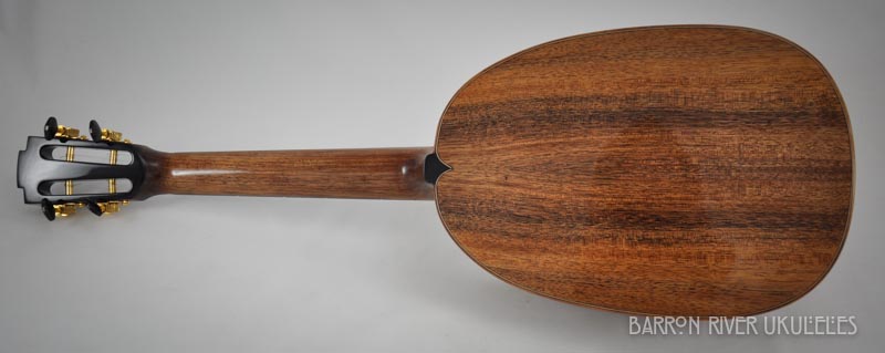

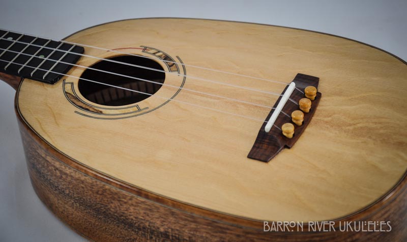

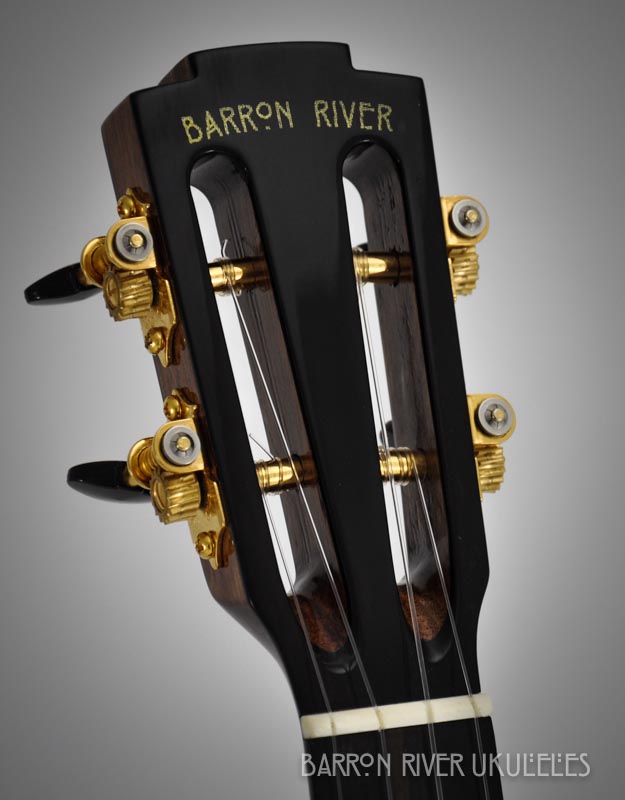

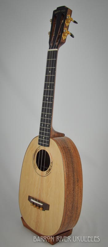

This is my first left handed instrument, and I found I had to keep reminding myself through the entire build so as not to stuff something up. Stringing it up proved to be more difficult than I would have though as with re-entrant tuning it's really easy to mix up the 1st and 4th strings, along with tuning them to the correct pitch. Can really make you feel dyslexic.
Back and Sides - Australia Blackwood
Top - Bear Claw Sitka Spruce
Bindings - Blackwood
Fret Board - Ebony with 12" radius
Peg Head Overlays - Ebony
Neck - Blackwood with CF truss rod
Tuners - Gotoh
Bridge - Gidgee
Rosette - Spalted Avocado
Finish - Mirotone
Strings - South Coast Ukes

Post by martintaylor » Tue Jun 11, 2013 9:56 pm
Looks amazing as usual. That Blackwood is fantastic.
